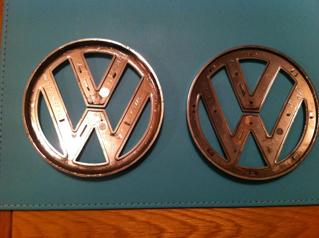

Here are the 2 badges: 1 on the left is the Original: Part No: 3C5827469
The one on the right is the Mk6 Variant Part Number 5KO853630A.
Both are the same size despite the picture showing otherwise.
Here is the offending Boot Handle  :fighting: Ignore the Carbon Sticky as i'm experimenting as Ill be fitting an OSIR Carbon Rear diffuser.
On top of each other  :wink: perfect match in terms of width and depth
All the lugs and raised plastic stickers are in the same place albeit I snapped every lug off the Mk6 badge just to prove its not the lugs.
Top end pops in whilst the bottom end refuses this is the same when i get the bottom to fit then the top wont.
Seriously this is such an easy task but WTF is it not fitting  :signLOL:

Yep as I thought it is indeed the same base as the mk6 handle, so yes the badge will fit straight on unlike going to an older mk5 base where most of the clips would need removing.
I'm not sure how they fit the badges new but trying to fit yourself is tricky. If you get a Stanley knife and slice off a few of the wedge bits that stick up around the edge (about 6 of them I think, so take a couple off) it will allow you push the badge on, it does clip very tight - hence your problems  - can be done though  :happy2:
(just for reference below right is what mk5 handle backs were normally like, until they change to your style on the left)
