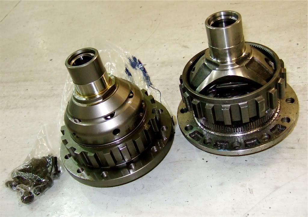

THE QUAIFE ATB DIFF:
A second mechanical method of improving traction is to use a Quaife Automatic Torque Biasing Helical LSD differential. Rather than using clutch plates as a method of operation, the Quaife ATB Helical LSD uses sets of floating helical cut gear pinions that run in pockets and mesh during normal driving.
Should one of the driven wheels start to spin however, the helical gears start to generate a torque bias thanks to the axial and radial thrust of the helical gear pinions in their pockets. The result is a progressive transfer of torque away from the spinning side of the axle to the driven wheel, which is now capable of transmitting a greater proportion of torque.
Positive Dynamic Effects:
Because the Quaife ATB Helical LSD differential's design produces a progressive transfer of torque away from the spinning wheel to the wheel that's capable of driving, the effect is far more benign to the driver. In a front wheel drive car harsh snatching and torque steer are eliminated, so much so that it's not uncommon for a Quaife ATB Helical LSD differential to cope with 400bhp through the front wheels in aftermarket road applications.
SOURCING:
On finding that very few workshops had ever fitted the DSG version to the Mk5 GTI, I went to VW Racing who have plenty experience of such things and are obviously used to stripping the 2.0T FSI on a very regular basis. I also asked for price quotations from JKM and APS - Two more workshops I trust but who don't have the same degree of experience. Costs were all within £50 of each other with VWR the most expensive at about £1,500 all inclusive for the DSG version (which costs more than for the Manual gearbox).
INSTALLATION:
NOT for the faint hearted! And NOT recommended to be done by your friendly local neighbourhood garage. It requires a change of filter and specific DSG oil and precision and particular care by the mechanic. However, once installed, it's maintenance free and you can forget it.
Allow 2-3 days overall.
^ I think it's a finely engineered object of great beauty ^
