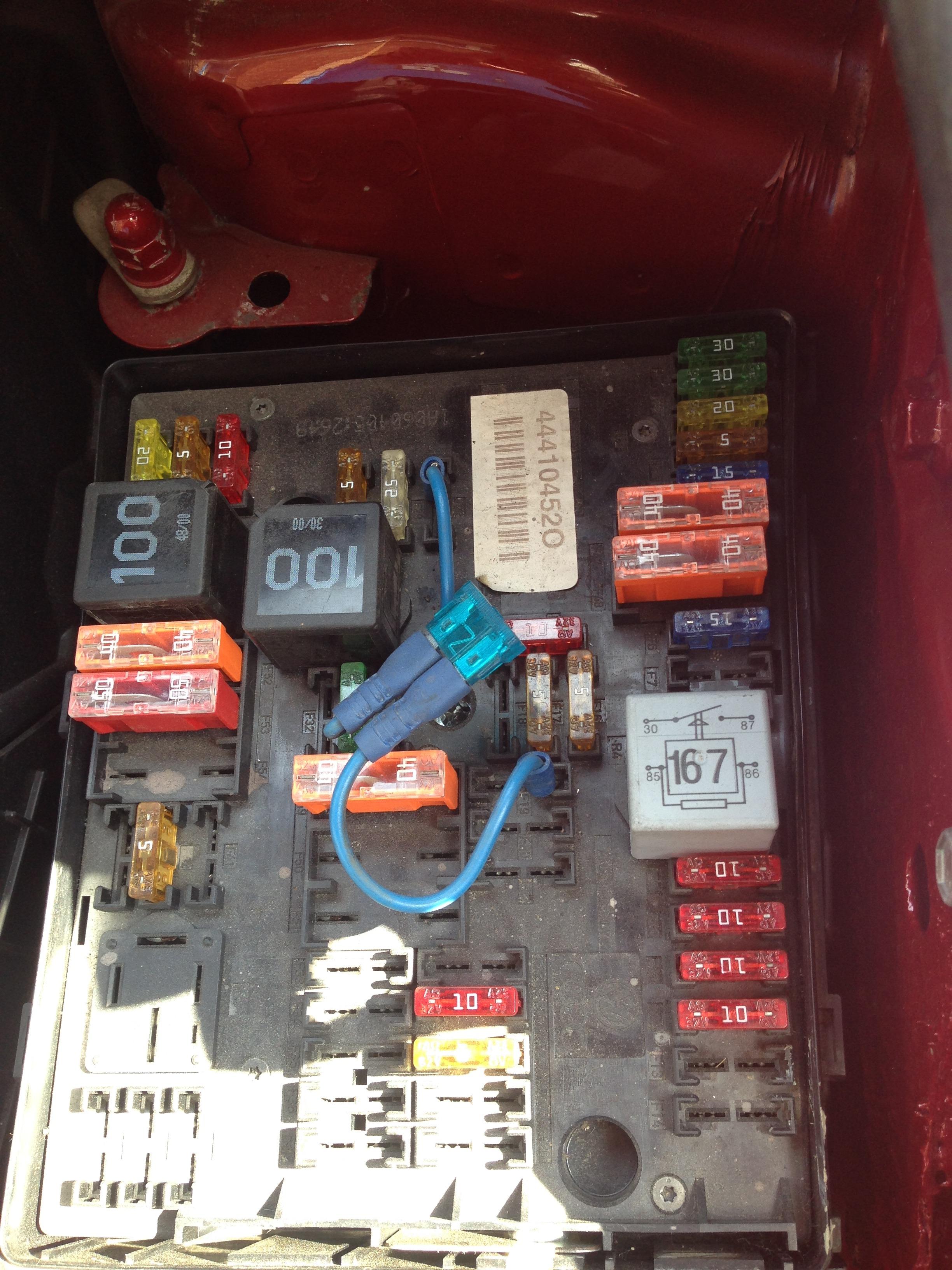

« Reply #22 on: August 17, 2015, 03:17:58 pm »
Ok just read on another forum about 'the fuse mod' to enable fitting later stereos without battery drain but stereo loses memory
I remembered seeing this in the golf and was there when previous owner bought the car (mfd2 fitted)
I've removed the add on and popped the fuse in the slot closest the bonnet so i'll see what happens at 4pm when i leave to go home
Touran TFSI Quattro | stage 2+ BHZ | UK's first

« Reply #23 on: August 17, 2015, 04:04:34 pm »
That looks very bodgie  :confused: fingers crossed.

« Reply #24 on: August 17, 2015, 10:34:27 pm »
Your fuse goes in the other slot ! It's slot 19 as far as I can remember , I was running this mod for a week while waiting on a new canbus gateway

« Reply #25 on: August 17, 2015, 11:33:07 pm »
Yep all sorted, fuse is in correct place or stereo doesn't work at all, i think F19 yes :)
