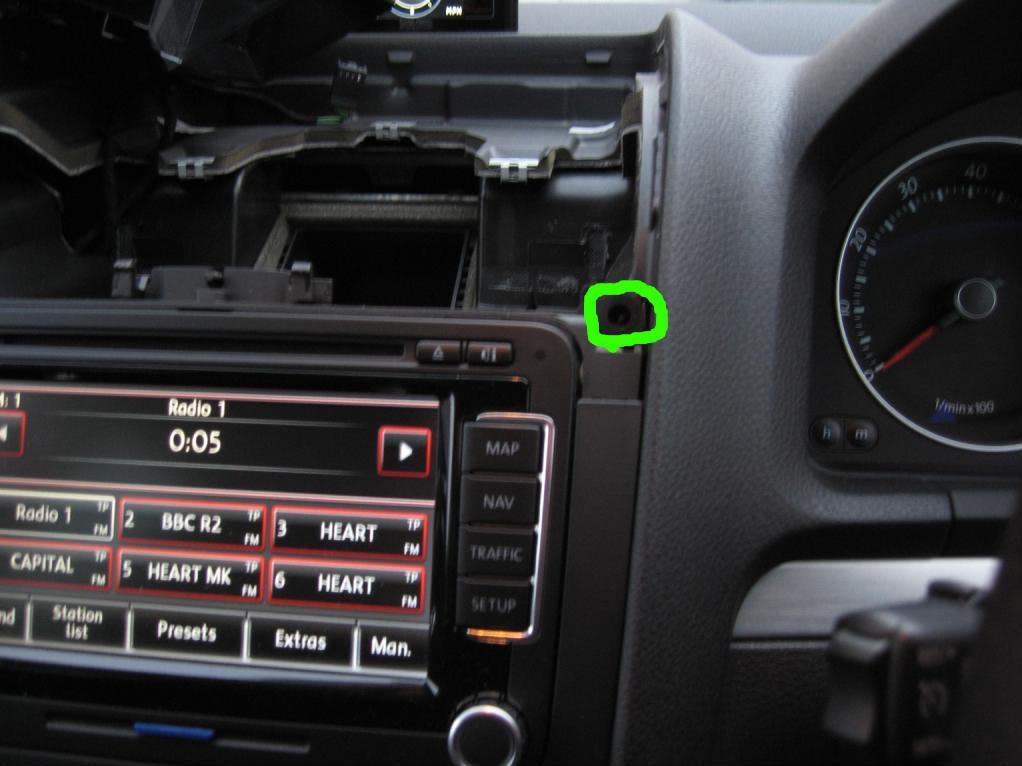

Pop off the top vent cover using a trim tool
Towards the back of the vent unit remove the single T20 screw.
Again using the trim tool lift out the inner vent.
Now remove the two T20 screws holding the rest of the plastic surround in place
Lift out the top part of the plastic surround with the trim tool.
Now gently prize the upper and lower trim sections apart with the trim tool and lift away the whole section.
Now remove the two T20 screws hold the top corners of the lower trim piece in place.
Now working from the bottom upwards gently lift out the lower trim with the trim tool.
Then remove the 4 T20 screws holding the RNS510 in place.

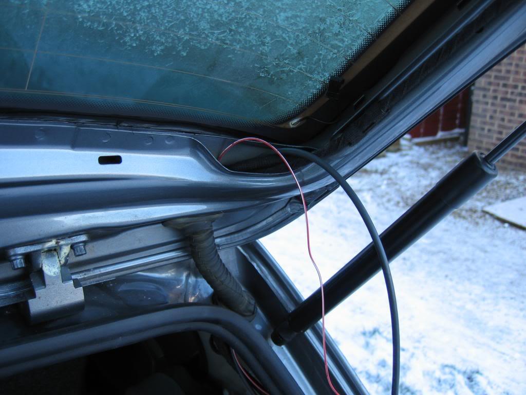

Step 7 - Feeding the cables and connecting the new
Now release the rubber channel between the boot lid and inner roof line, then feed the two cables up through hole in the inner roof line
Remove the blue plastic cover from the end of the coax cable
Now feed the two cables through the rubber channel, i found compressing the channel ends together and pulling the cables through using a wire coat hangers was the easiest way.
Then feed cables through the outer hole of the boot lid
Re-install the plastic cover on the coax cable
