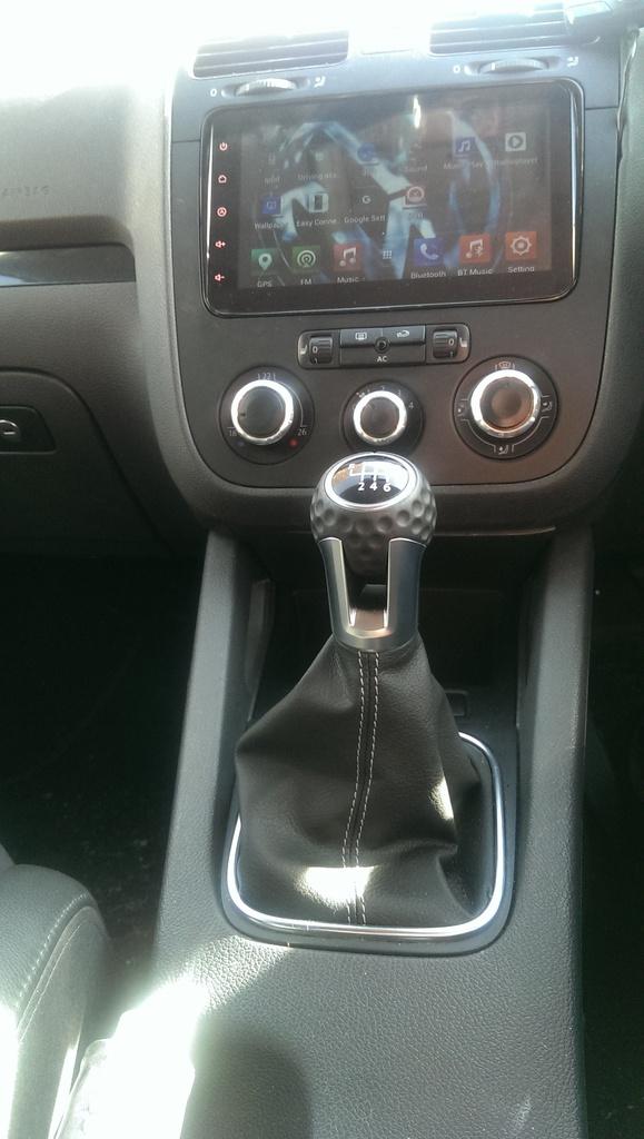

« Reply #13 on: October 27, 2015, 07:44:17 pm »
Finally got round to uploading pics

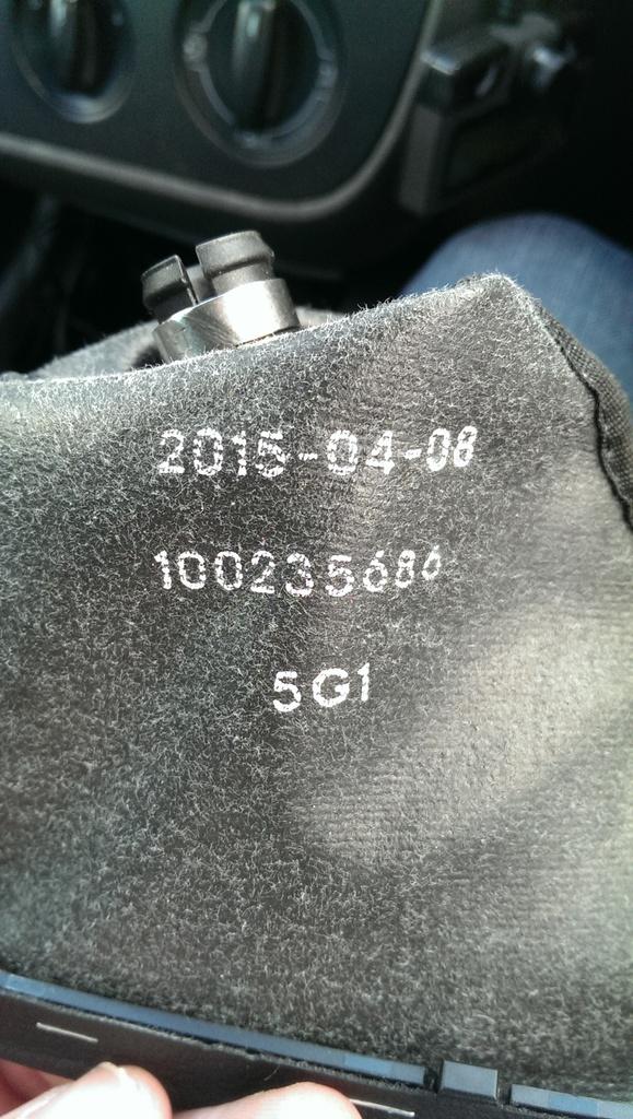

« Reply #14 on: October 27, 2015, 07:45:39 pm »
another of the part number
