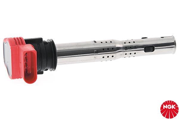

I think that I have a problem with my ignition coils. One of them could be failing and making a misfire. So I want to change my 4 coils. I heard that the coils for the Audi R8 runs very good in GTI V. My car is stock but in future I would like to reprogram it to stage I.
What do you recommend me? How do they work? Can I put these ignition coils without problems? I have NGK sparks too.

Hi. Yes the R8 coilpacks will work fine. Spark plug NGK BKR7EIX are the ones to go for.
Rich

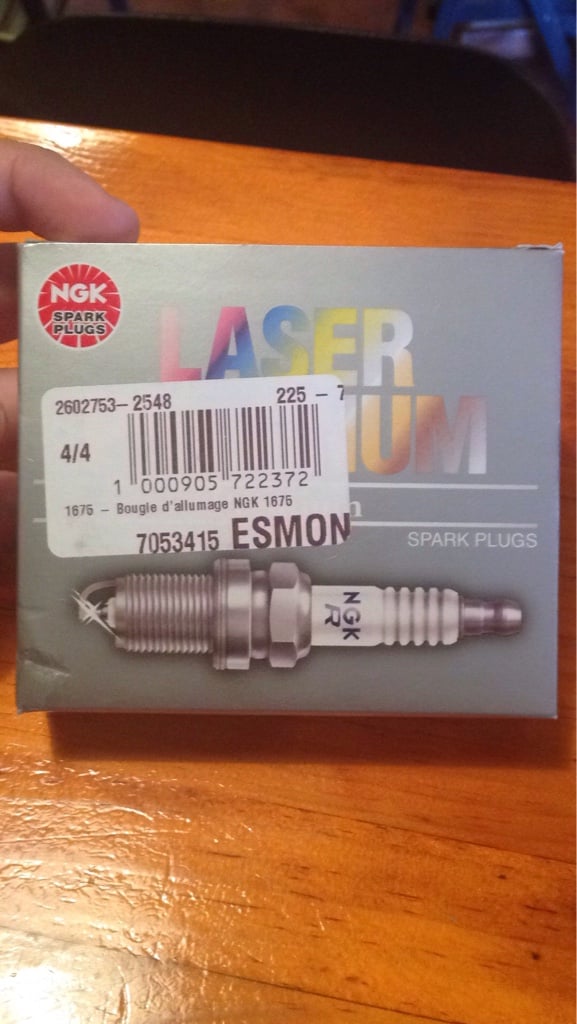

Thank you, @rich83. Now I have in my car these spark plugs (New. Replaced 3 weeks ago):
Is it absolutely necessary that the plugs are iridium?
Enviado desde mi iPhone utilizando Tapatalk
Re: R8's NGK red coils for GTI?
« Reply #3 on: September 07, 2015, 01:47:52 am »
They will be fine. Next time swap to the iridium 7s
