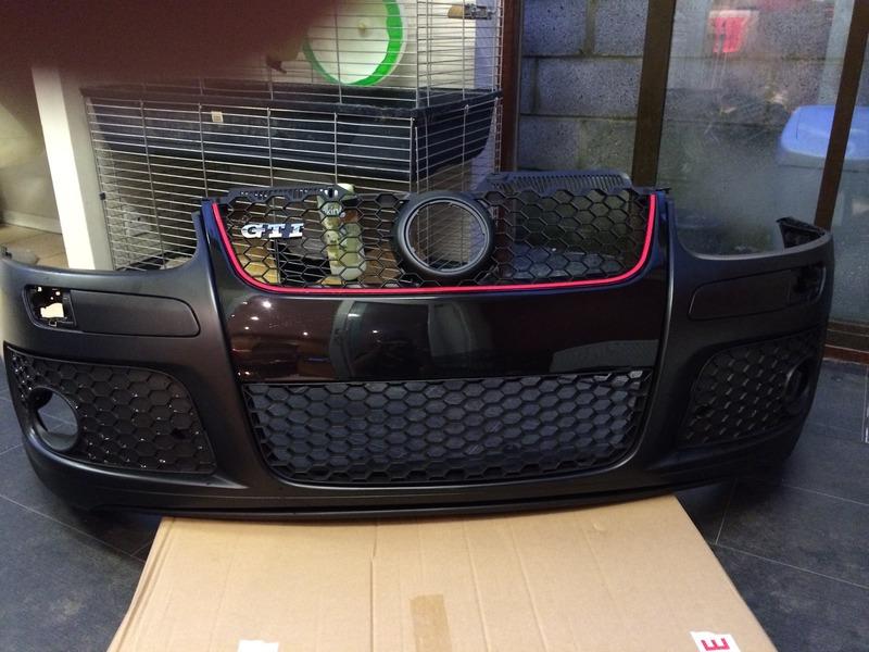

My replica "edition 30" bumper arrived today along with the replica gloss black honeycomb grill.
definitely one of the better reps i've bought over the years. Not perfect (reps never are) but the moulding used looks correct. Problems to be rectified.
  • Lower left grill recess needs very slight trimming so the grill sits flush in the bumper.
  • Quite a lot of "flash" in places including both lower and upper grill but this is to be expected on any replica plastic bumper
  • The 2 top mounting points for the upper grill dont connect to the points on the bumper (unsure which piece is at fault) Looks like the bumper can be trimmed to fit. Must resist urge to cable tie!
  • Mounting points to front wings look a bit iffy (looks like moulding issue) however these will be cut away anyway with the addition of the  arch extensions.
  • "GTI" badge is squiff as hll and marked but i want to cut this off anyway
  • Fog light mountings are still a puzzle at this point. Again, must resist urge to cable tie
Will do a proper test fit on sunday and then prep and prime ready for painting.

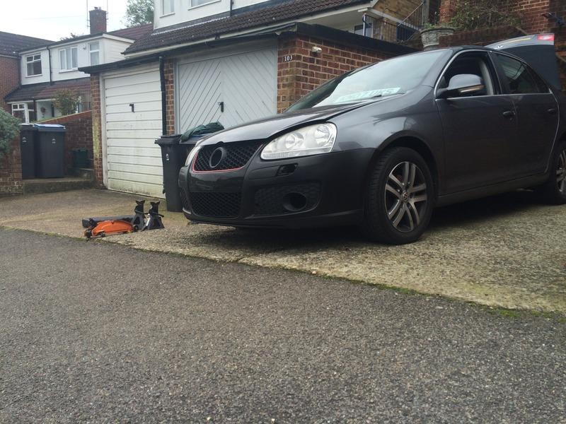

Hi guys, not much has changed. Been drawing up some plans but nothing to show for it yet.

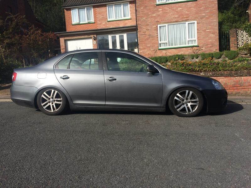

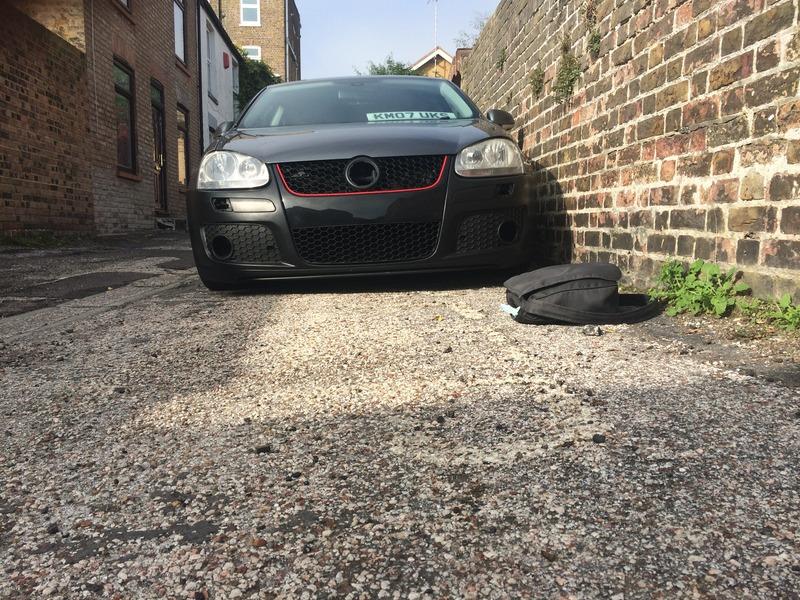

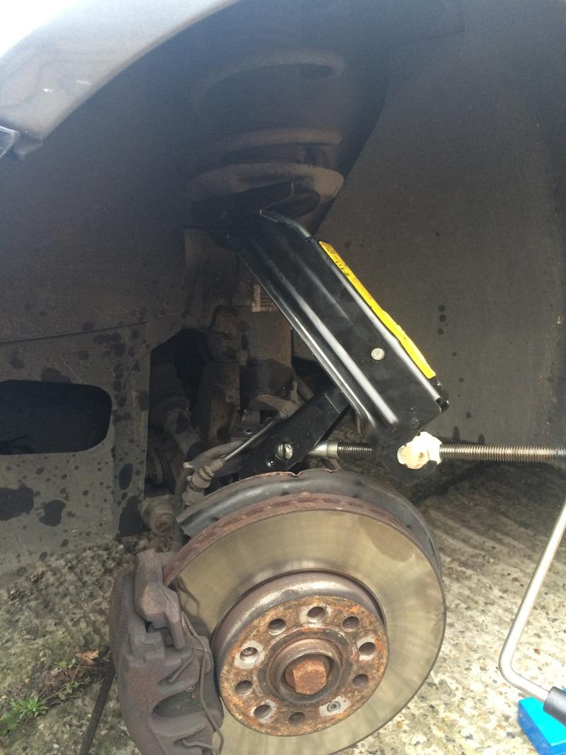

Still haven't painted the bumper but the weekend gave me a choice. Paint bumper or fit coil overs?
I went for the latter because I just wanted to get it out the way. I don't have the strut spreader tool so I used the next best thing to get the strut out of the hub.
Wasn't sure how low they would go so I wound them down to maximum low for maximum lols.
Before
After
Already ripped the under tray half off

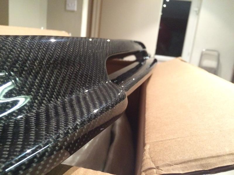

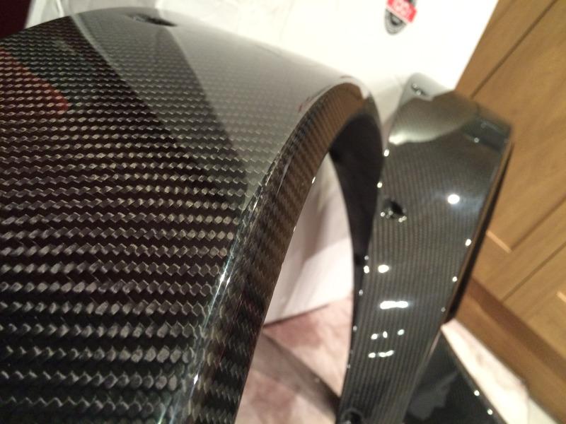

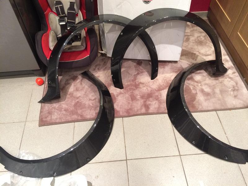

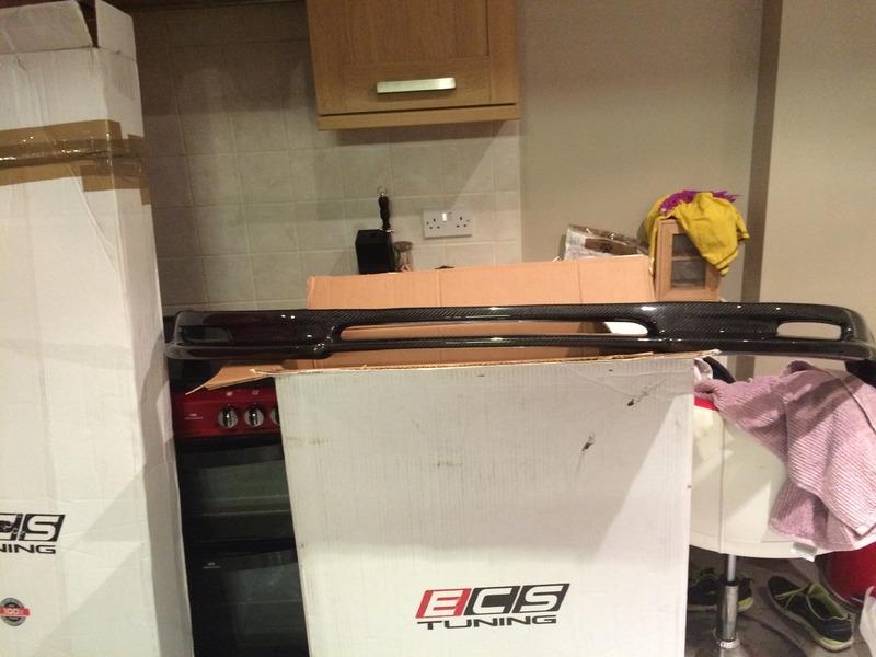

Christmas presents to myself arrived yesterday.
Carbon fiber splitter
Carbon fiber arch extentions
Hoping to have them on by the weekend if the weathers good :)

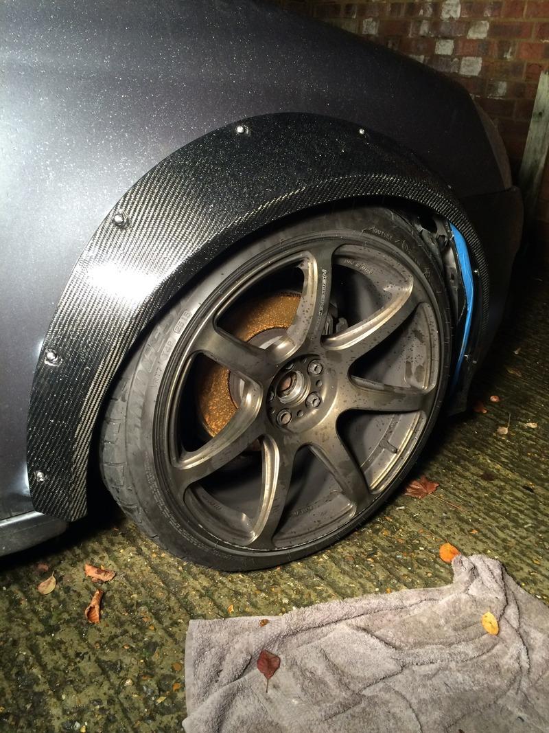

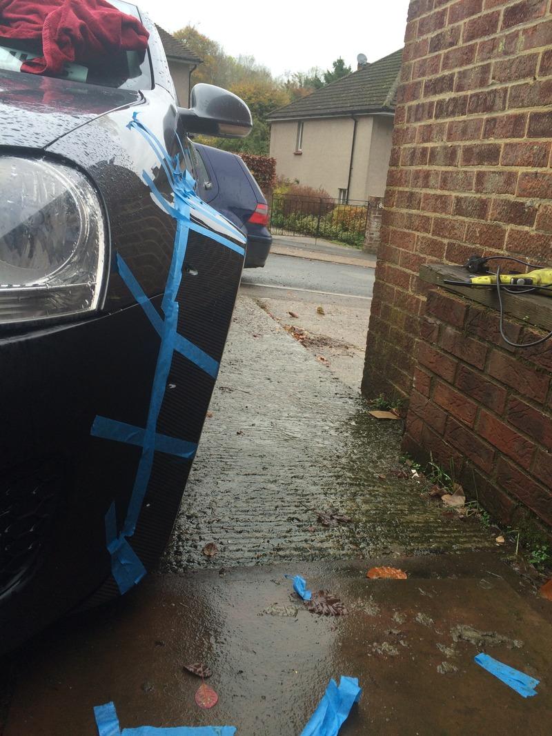

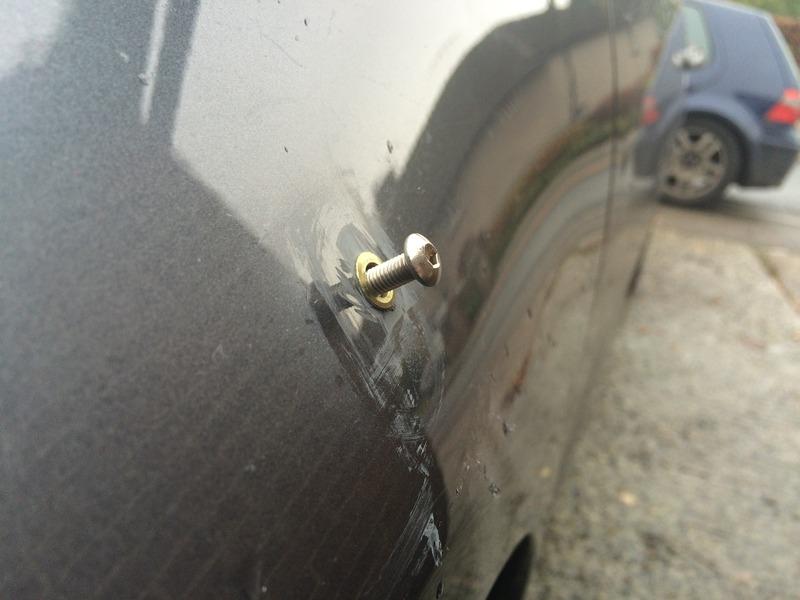

My arches arrived last week but short days and bad weather mean I have only been able to start it today. Although i have to keep stopping because it keeps raining then giving me about 20 minutes of dry time.
So, test fit with the masking tape (also marking holes for drilling.

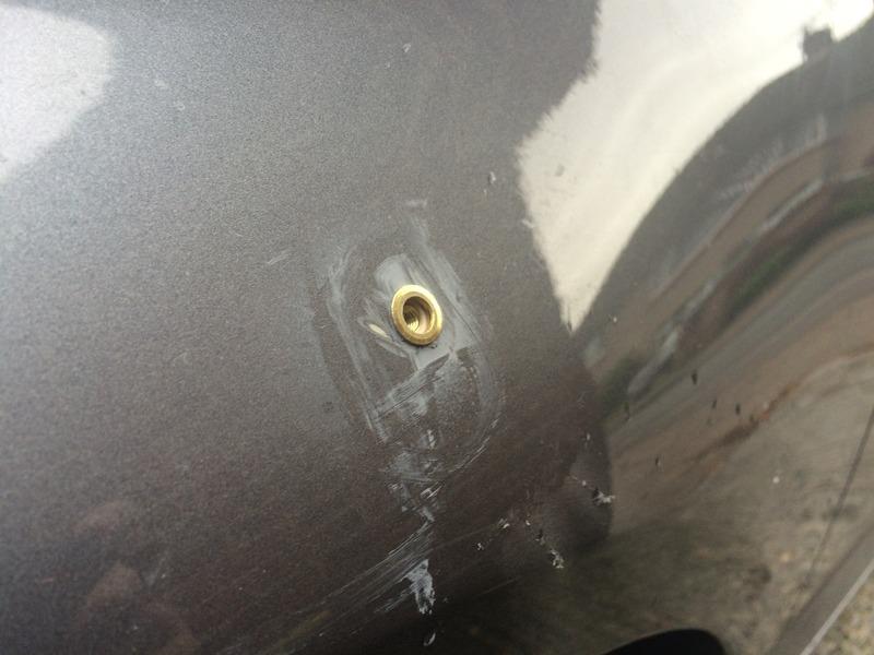

I have had similar arches before for a different car (and plastic) but i usually rivet them on, however ecs handily provide some rivnuts (they are supposed to provide a tool for them but it wasnt in there so bought one) I gotta say they are a great way of riveting stuff on as it allows you to take it off without drilling out and re riviting.
The rivnut itself
And then the bolt. Genius.
So 3 rivnuts are in and its currently raining so got to wait for that to pass before fitting the rest of the arches (easy bit) then its time to start cutting.
Shes gonna be wide

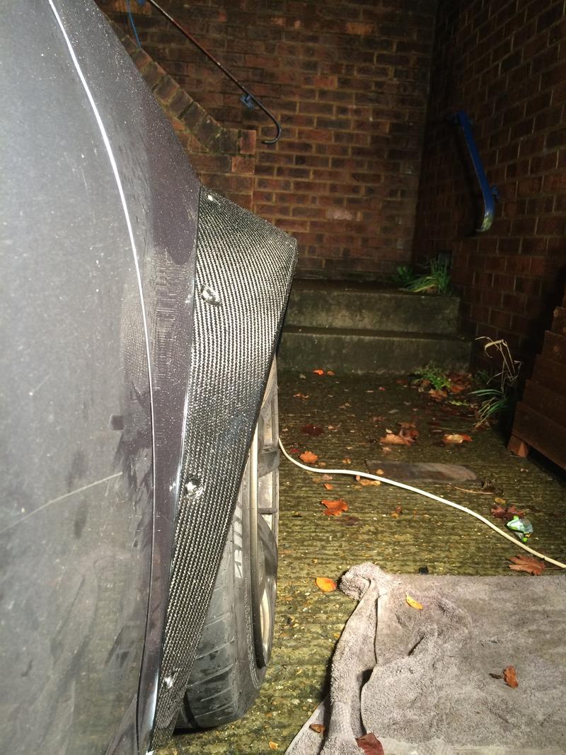

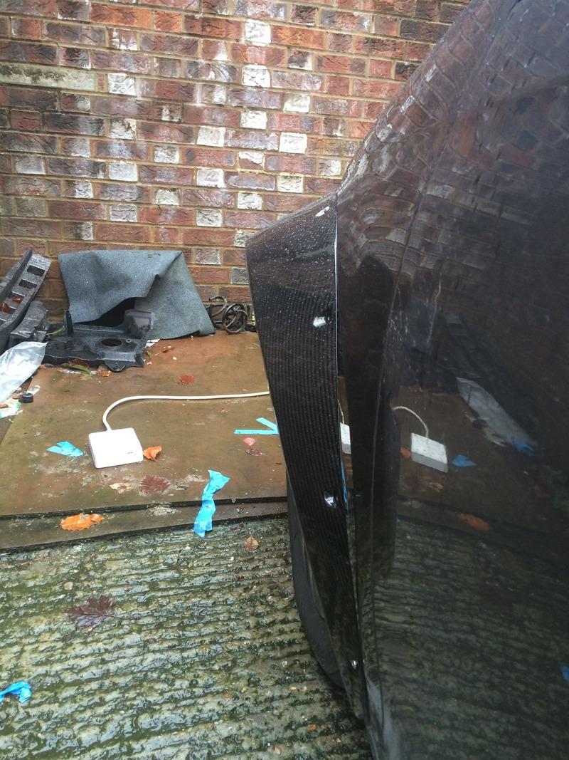

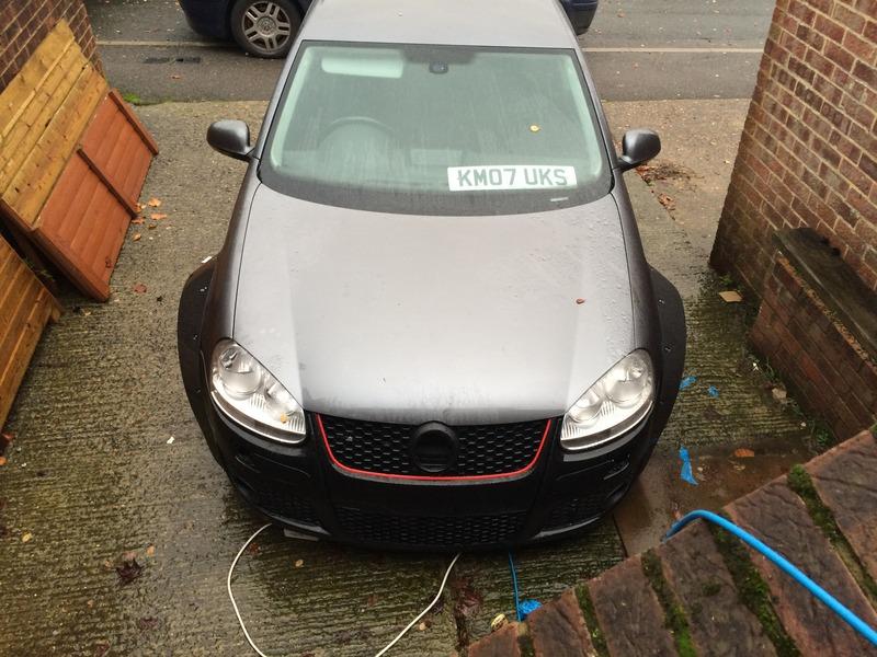

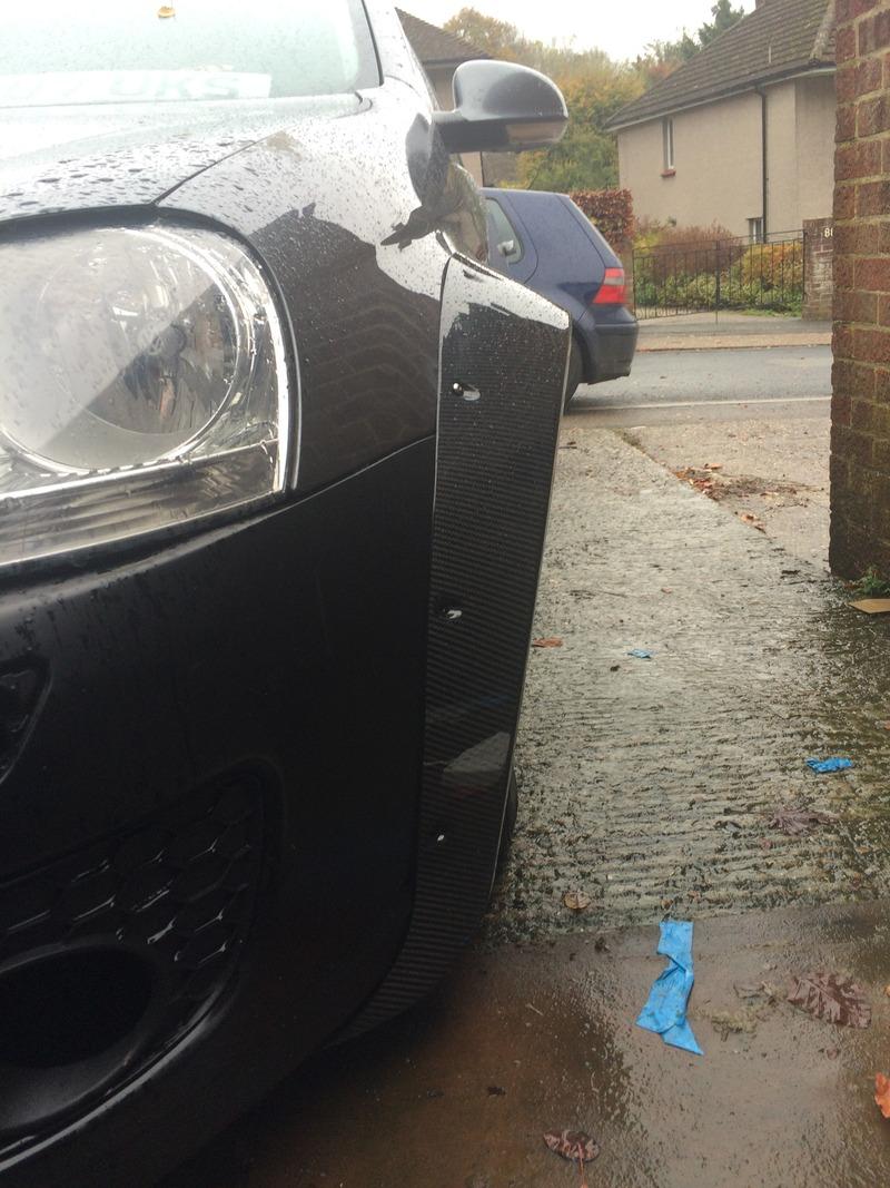

It fits quite well. Not perfect as the front bumper is a rep ed30 bumper and i also dont have any skirts to use as a reference but its gone on ok for now and i'm pleased with the overall look so far. Very....race car lol.
So i've finished fitting the other arch. Broke the rivet gun on the last rivnut in the bumper so all progress halted till i can get hold of another one. I would measure up and drill all the holes for the rear but is starting to rain quite hard and losing light. Was hoping to have all arches on today and then cut out the metal part of the arches and see what sort of spacers i will need with my other wheels but oh well :(
The ecu is out of the car at the moment whilst i tinker with it so i cant actually move it and get a better pic but heres what it looks like at the moment.

« Reply #28 on: November 08, 2015, 09:44:34 pm »
Yup, deffo going to need some bigger spacers. Another 20mm should bring them out a fair bit. Only done one corner so far as it wont stop raining!!!
