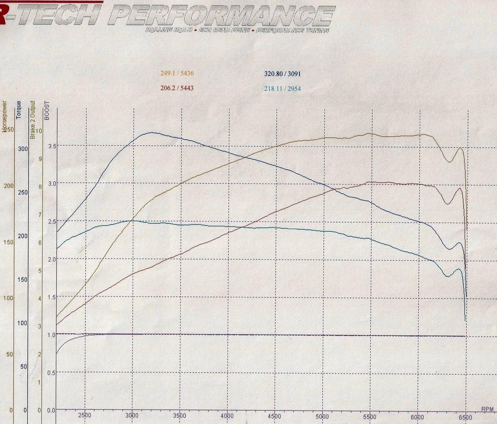

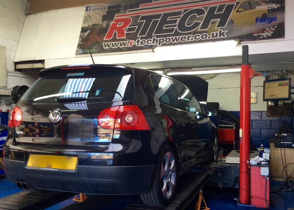

So last week I fitted the Pipercross panel filter, had the pre-cat removed and HPFP cam follower replaced and got a service done by VW with Millers Nanodrive 5W40 from OpieOils (great price!).
Today was the day I headed up to Hinckley for the stage 1 and Holy McBuggery I'm impressed! They spent best part of 2 hours working on the car. Full health check to start. DV replaced with a rev G then a rolling road test to get the pre-map figures: 206 bhp and 218 lb/ft torque. Niki started off by applying a base map and then doing some serious tweaking and more rolling road tests to get the best out of the car. Final figures: 249 bhp and 321 lb/ft of torque.... thats a 25% increase in power and 50% torque! Wowsers! I certainly felt it on the drive home!!
If you have a stock GTI and are toying with the idea of getting a stage 1 done DO IT! I waited almost 4 years. Wish I did it on day 1 !! Transforms the car  :smiley:

Re: Finally booked the stage 1
« Reply #4 on: October 02, 2015, 07:53:45 am »
Saw this on Niki's Facebook, huge area under the curve, bet you're happy. Totally transofrms the car doesn't it, you soon realise how dull and flat the car was, especially at lower rpms.
Clutch will start to slip at some point as its probably never been replaced if manual. Personally at that stage of tune i'd stick a standard one back in it. I'm still on a standard clutch at the moment, replaced it last year, and its handled the last 6k of hard miles at Stage 2+

« Reply #5 on: October 02, 2015, 02:11:53 pm »
@Beej - No. I did ask their opinion but they said at stage 1 there's little point.
@Ruggy - I'm running DSG so not necessary (at least, I think that's the case).
@Dan_FR - Yeah the curves look real nice don't they. I'm WELL happy! You're absolutely right about the transformation, I can't believe the difference it made! I'm guessing I don't need to worry too much about the clutch on a DSG setup?
