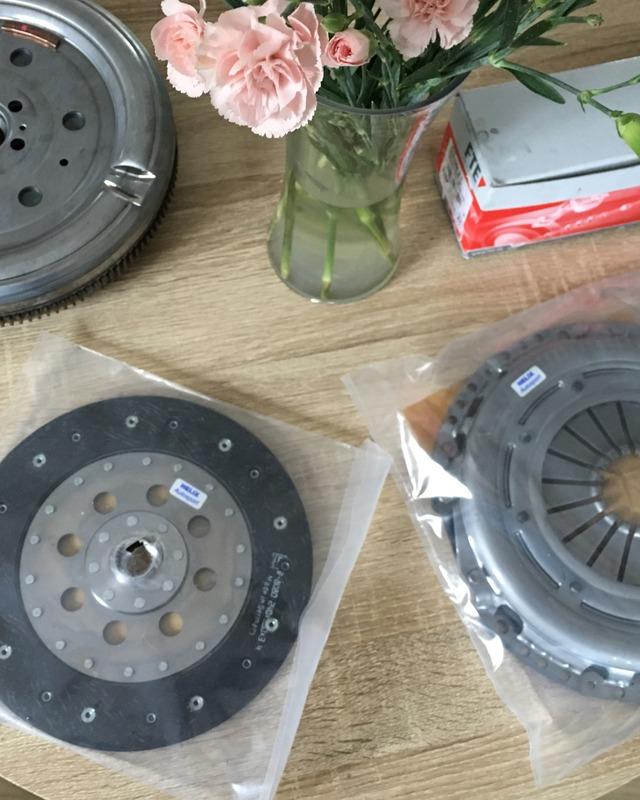

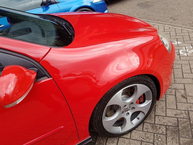

Not much to update! Helix clutch going on next weekend which is much needed. It had a full 2 stage detail a couple of weeks ago finished off with CQuartz UK. Paint work was really bad so it looks so much better. Actually red again. Also fitted a 300mm OMP quick release steering wheel, mainly for security reasons as its parked up for weeks on end.

Looks really tidy mate the paint looks awesome now, love the way the intercooler looks behind the front grills too!

Good stuff. I've got the Helix myself. It's very good, deals with the 345lb/ft I'm currently putting through it without even the slightest hint of slip. Acts like stock, just with a heavier pedal. Unless you've got weak legs you'll be used to it within 30 miles of driving!

Thanks mate  :happy2:
Yeah I quite like the feel of a heavier clutch so I'm looking forward to that!
