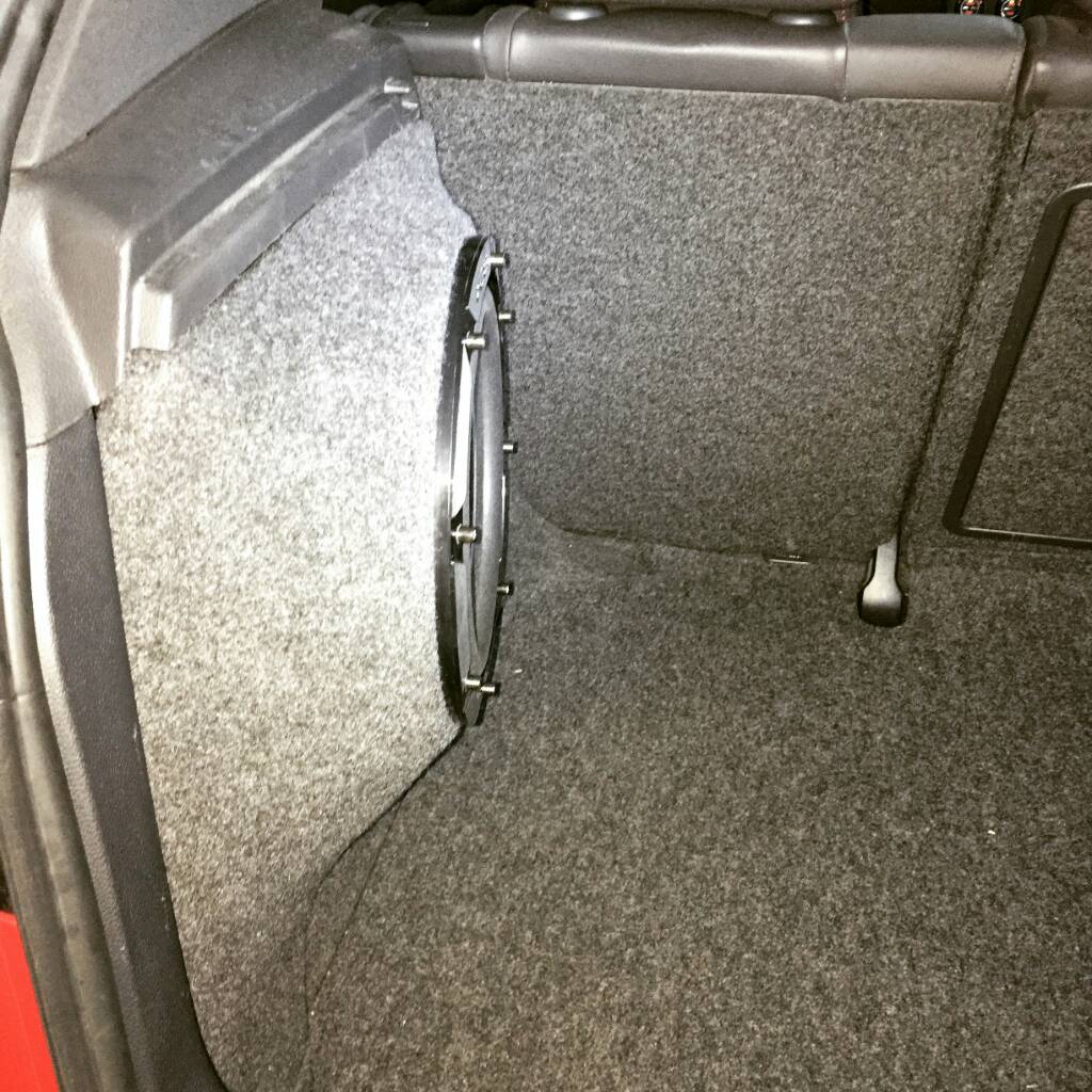

To get low bass you could add a amp but you need an adapter cable with rca for your h/u but if that's the route your going  change the header unit to after market one..I have just the fronts connected and amp and a discreet sub box look through my build thread

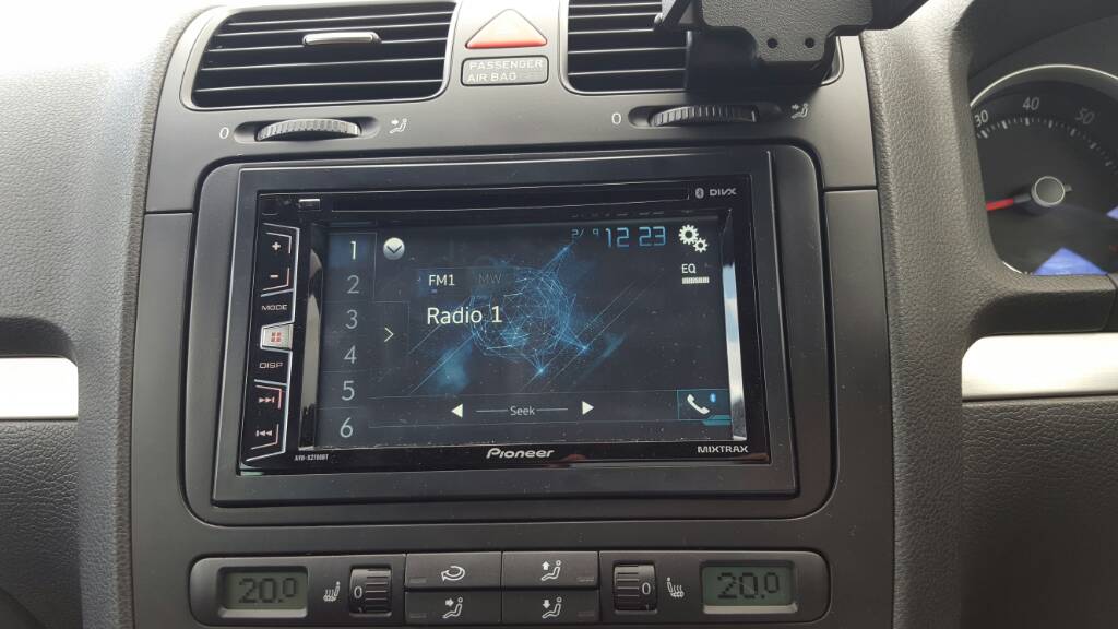

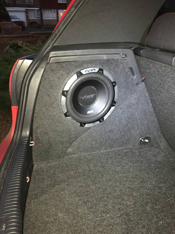

« Reply #7 on: October 26, 2015, 09:26:54 pm »
My stereo and subwoofer... amp is under the front passenger seat.
Sweet.
Is that a 12" sub?
Did you replace the front or back speakers at all?
Are you using the HU to power standard speakers, or are you powering with your after market amp?
BTW - I'm booked in later this week for western audio here in sunny bristol to advise on what they recon would be best for what i'm looking for...:)
10" sub
Standard speakers powered by the head unit. The head unit has a lot better built in amp compared to the standard vw ones.
Sub enclosure is from Visual ICE.
Sent from my SM-G920F using Tapatalk
Candy White ED30 :)
