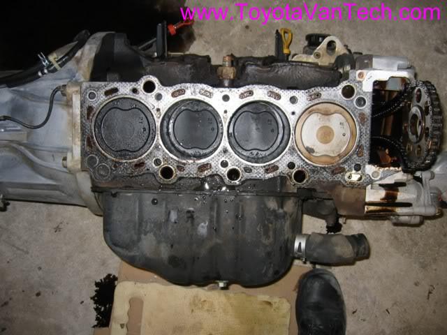

« Reply #26 on: November 06, 2015, 10:01:58 am »
I've no doubt it will help within the combustion chamber, the same way adding water vapour does, but passing a hydrogen gas over hardened deposits won't shift them without some form of aggressive chemical reaction. I looked up these 'Hydrogen cleaning' sellers and found this on one of the websites:
How HYDROGEN clean carbon deposit in the engine?
When hydrogen (H2) enters the compression chamber via intake manifold, without pressure, in petrol or diesel engine, temperature in engine causes that hydrogen molecules (H2) "tear up" the hydrogen protons (2H +). Active H + reacts with the carbon, deposits and the oxide precipitate substances in the engine. Carbon and sludge is chemically transforming into hydrocarbon (HC) in the gaseous state and throws it out of the engine through the exhaust system. After treatment, there is no need to change engine oil and filter.
The above is utter nonsense, but even if it werent, the extreme heat referred to is not present in the intake manifold or the back of the inlet valves
After a further look at the website: http://www.enginecarbonclean.com/technology.php seeing as you just add tap water, it's just a glorified form of electrolysis.
Hydrogen gas passing over carbon deposits will not shift them in any way, shape or form in normal atmospheric conditions which is what is present during this treatment
Spraying a very fine mist of water in to the inlet will have the same effect on cleaning the combustion chamber. An example of this would be a car with a failed headgasket where water has made it in to a cylinder... have you ever noticed how clean the piston is in this instance?
