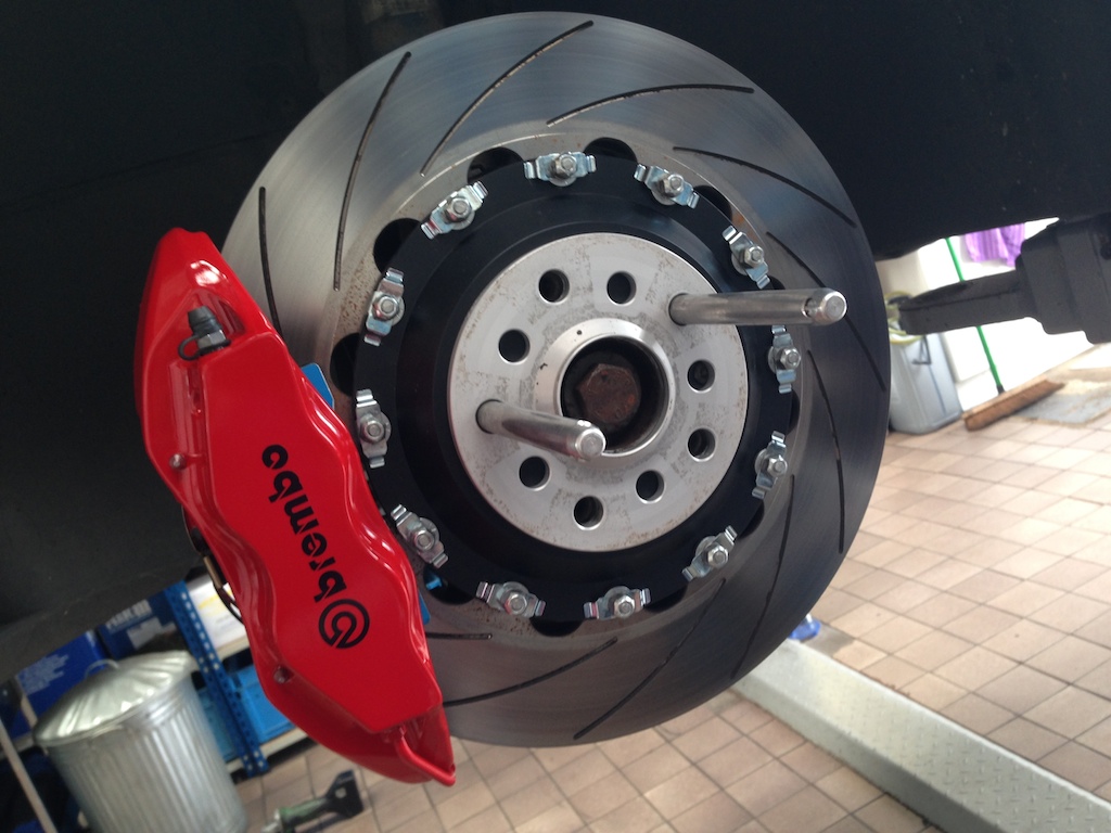

Just to clarify the setup here...
Ignore the lack of pad contact towards the middle of the rotor, that was because of the other F40 calipers (which didnt work) and pad size being wrong.

I'm confused by the bell. Why is it alloy in the middle? Are they fully floating bobbins, or just fixings, can you see 'tell tale' movement marks to show if they're dealing with the expansion correctly? If they were set to different torques, for example, they may not be dealing with the heat very well and jittering.

That alloy piece is a 8mm spacer to clear wheels. They are fully floating I think, will check for expansion....
