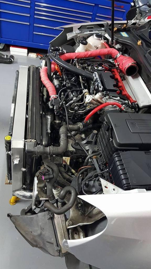

http://www.akstuning.co.uk/search?controller=search&orderby=position&orderway=desc&search_query=peron
@toosmiles getting one fitted yesterday on his modified Golf R...
Won't the rad infront cause airflow obstruction or is it okay like that?

I can't bring myself to put chinese copy stuff on my car, in some cases it may be upto the job but in so many cases it's much more restrictive than the branded items.  If it turns out to be rubbish it will cost you nearly twice as much in the end.
Im trying to think of someone at stage2+ with a twintercooler.
@vRSAlex and @rtechniki would be able to advise on which coolers work the best on the cars they've tuned (y)

Thats how so many of the well known tuned Tfsi's run, the Air con rad infant of that too!
I've removed my aircon rad to see if it gets more air flow to it but now I'm fitting water methanol it is probably irrelevant and just weight saving lol
