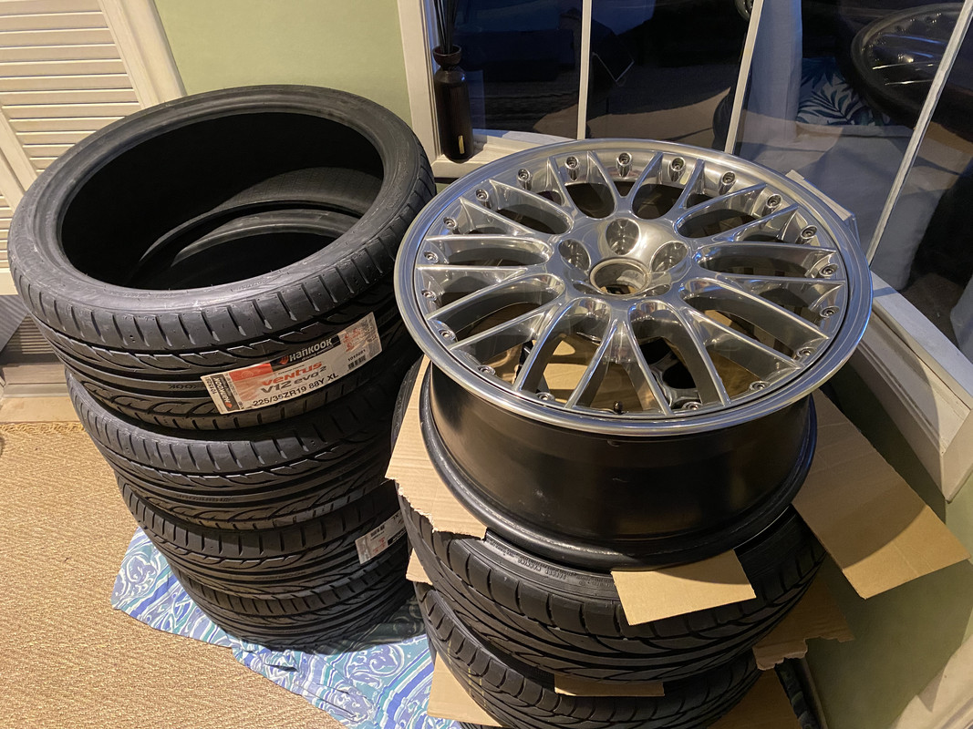

As for the parts for the 20 Years, they are on the way :wink: Next weekend I'm getting some extra set of BBS RS 722 and get them refurbished in original color and polish :happy2: Maybe on the way back home I'll stop by a 20 Years shop / collector who has many other stuff for the GTI😉
Maybe I'll find a back seat with headrests too :wink:
I'll put some pic's on when I receive all the other parts too :wink:
Thanks, Yes - it is Fjord Blue LR5V
Be careful with the wheels - a lot of them are 6.5 inches wide off Mk4's and are wrongly sold as Anni ones, but genuine Anni ones are wider at 7 inches and not easy to find.

@LC5F 👍🏻 Found the original 7x16 in good condition👍🏻 I ‘ll bring them to a wheel specialist who will refurbish them back to original spec… When I get back to Antwerp I’ll post some before pic’s😉👍🏻

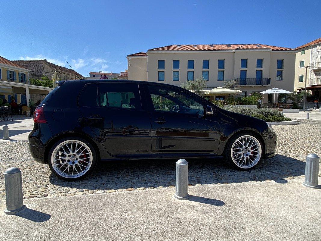

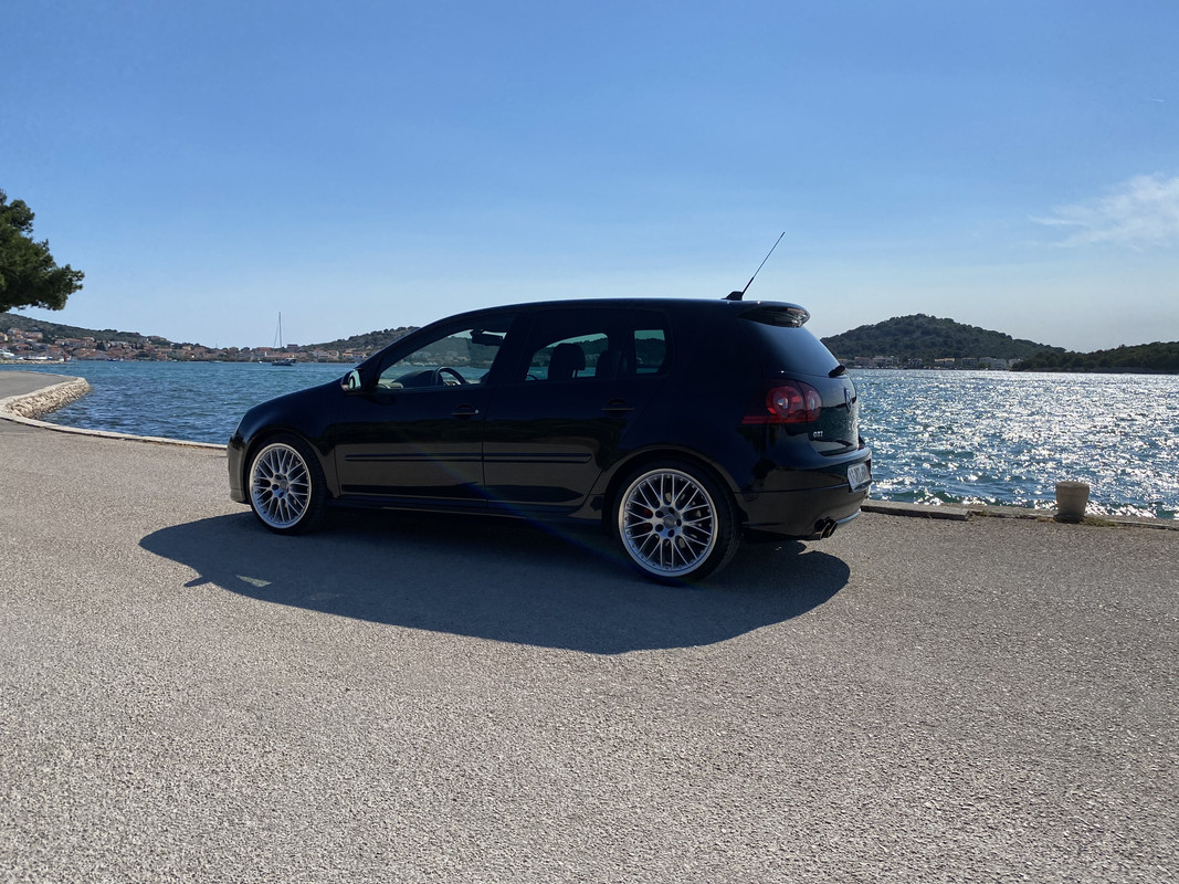

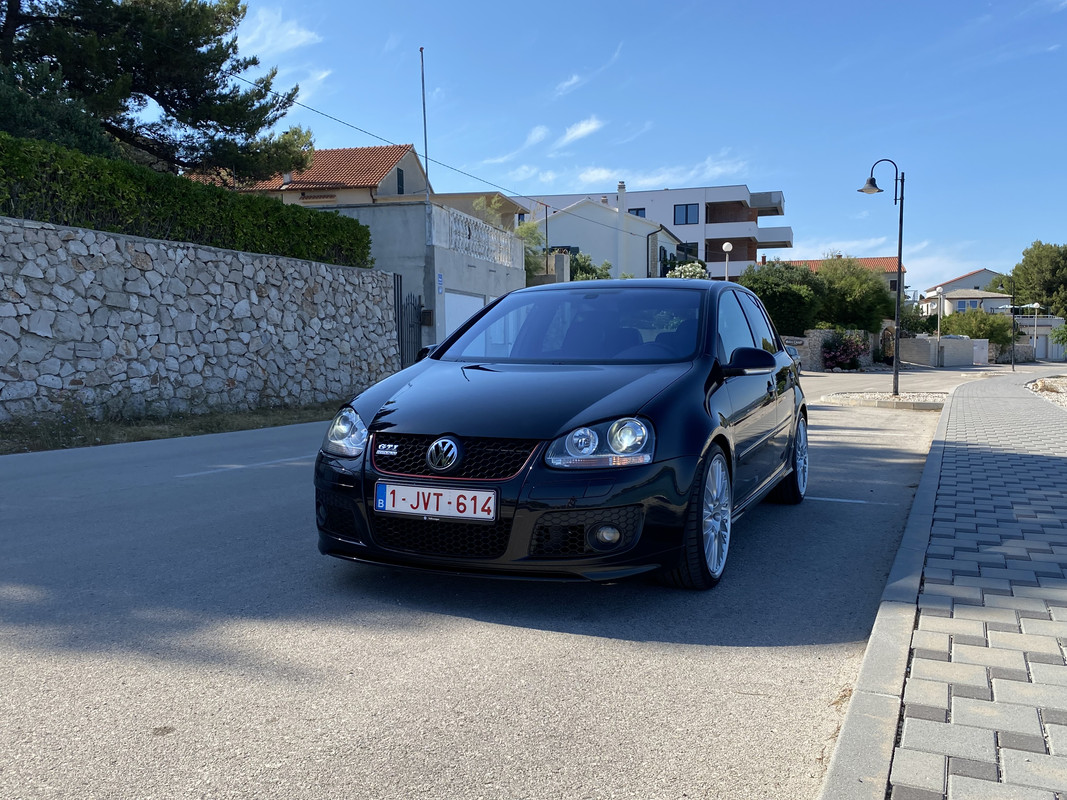

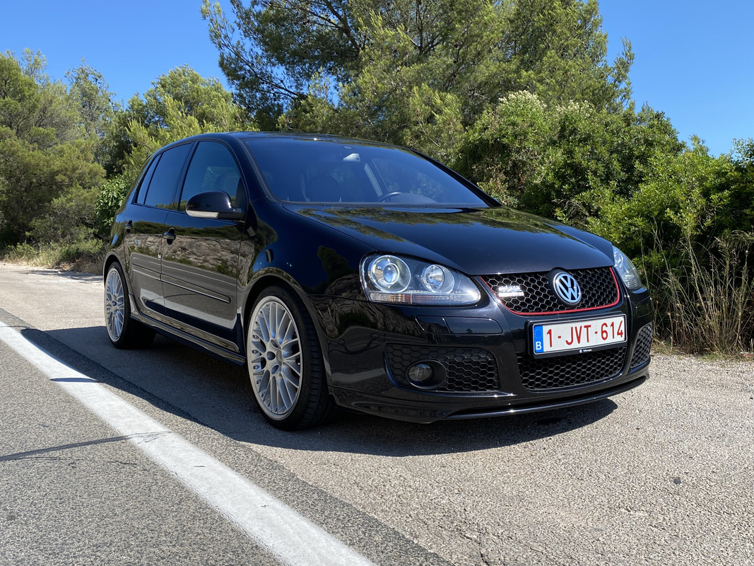

Now for an update:
I took my Ed30 to Croatia 🇭🇷 to swap it for the 20 Years… long story short…
I can’t register my 20 Years because of a stupid law here…🙄 so I have to take it back to Antwerp, register it there and have to wait 6 months before I can take it back to Croatia and then register it onto Croatian numberplates…😵‍💫🙄
It keeps me bussy😅

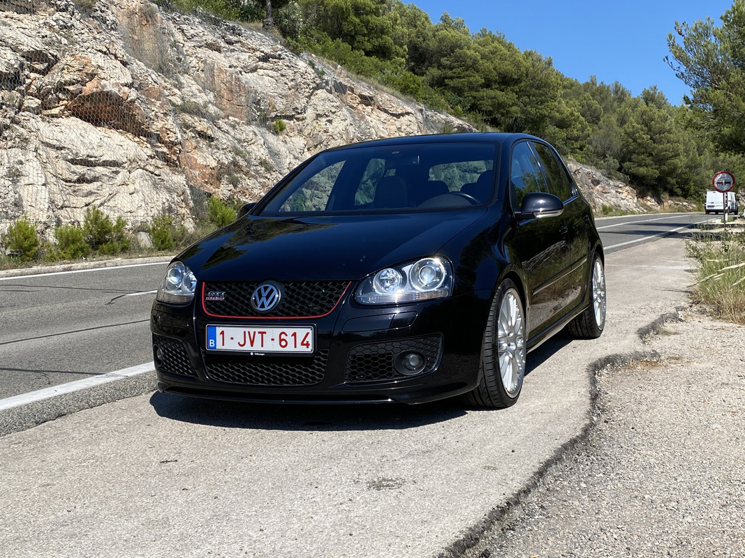

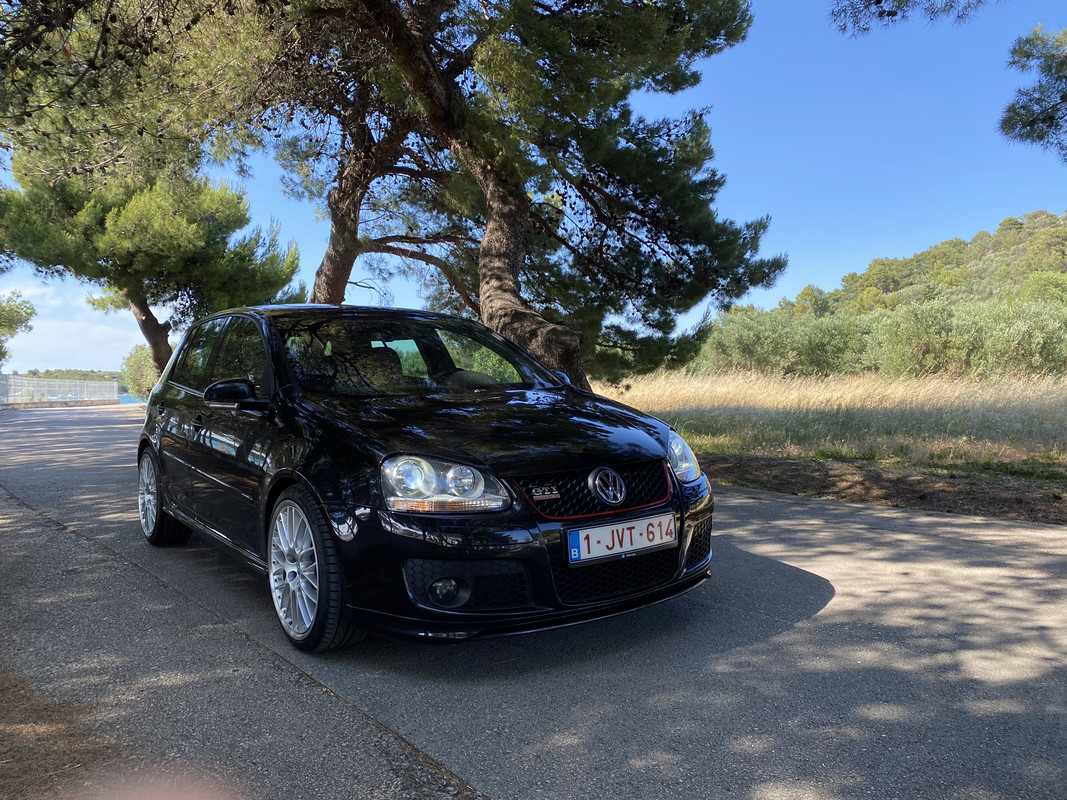

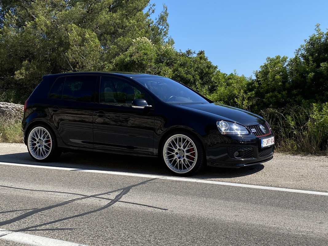

Now some road pic’s…
And safe home …❤️

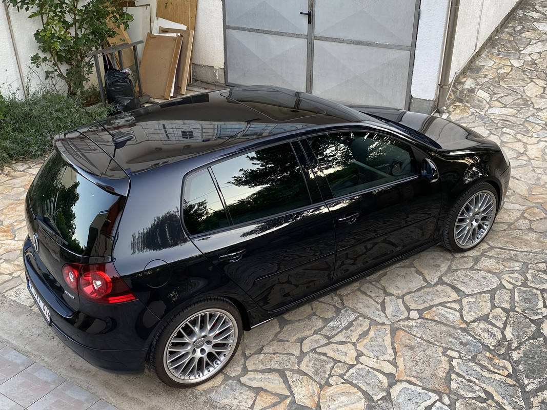

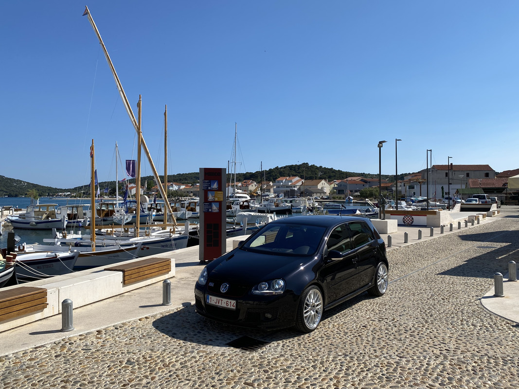

« Reply #228 on: June 15, 2022, 04:12:12 pm »

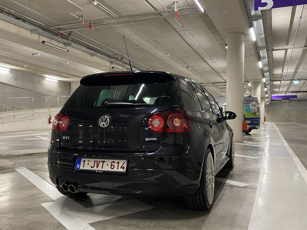

And also after a good wash…😁

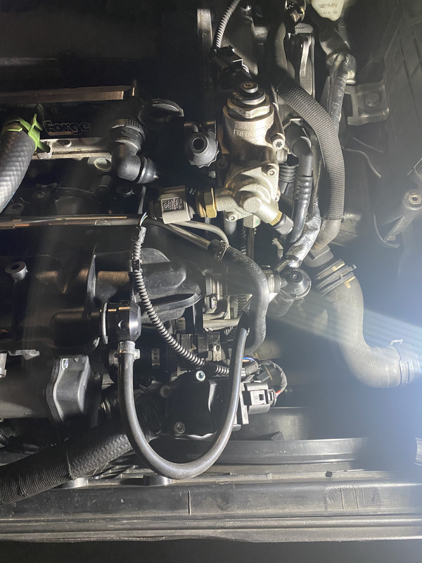

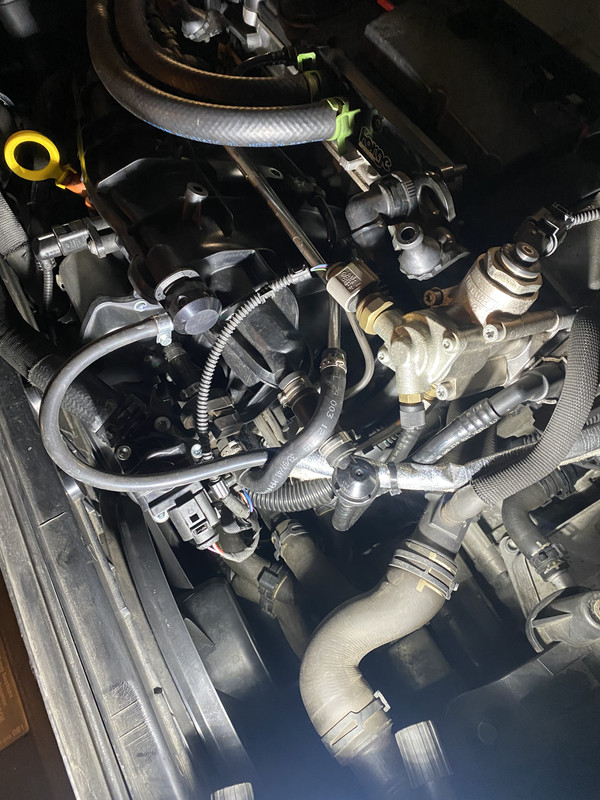

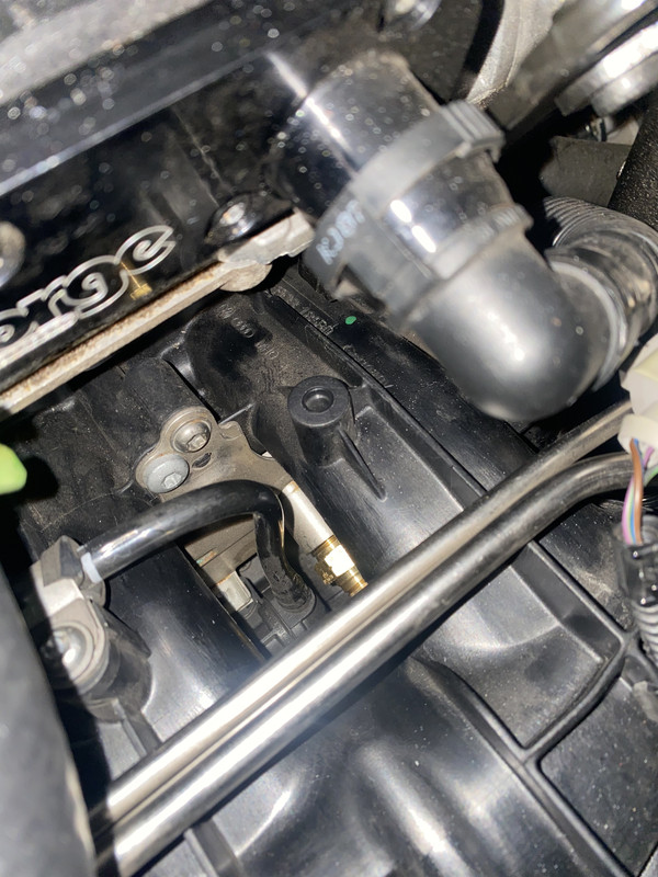

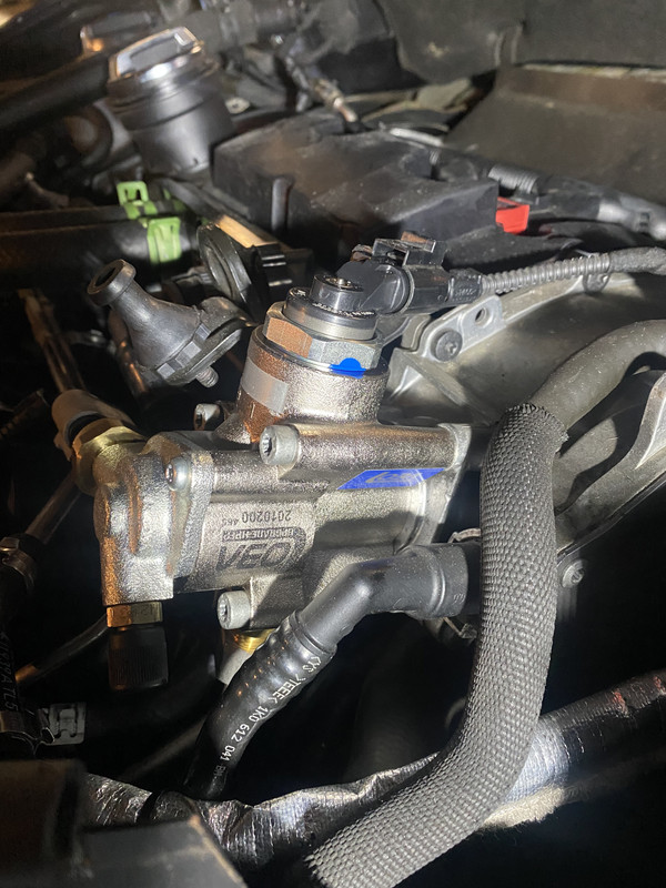

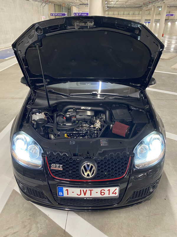

Had finally some time today to swap the hpfp to the Loba one and also install the RS4 fp regulator valve… and to my surprise the original one looked identical to the new one!?!🤔 Realy weird??!!??
Have you guys with your ED30 also this style of fp regulator valve mounted as standard?? Just realy curious 🧐 about it…
To my surprise it all went quite smoothly 😅 just took me 2 hours to swap the valve, the new hpfp and a new cam follower🤩😎 did a little test drive and check up afterwards… No fuel leaks detected  :jumpmove:
Didn’t take a lot of pic’s but you all get the idea…
Before
And after installation
Offline Shoduchi
  • -Given: 220
  • -Receive: 429
  • Posts: 4173
Re: Edition 30 powered by RBS
« Reply #236 on: December 18, 2022, 11:51:05 am »
You’re getting there! When you have it tuned it’s going to be like you had bought a new car.  :driver:
The FPRV all look the same, it’s just the internal spring that changes stiffness.  :smiley:

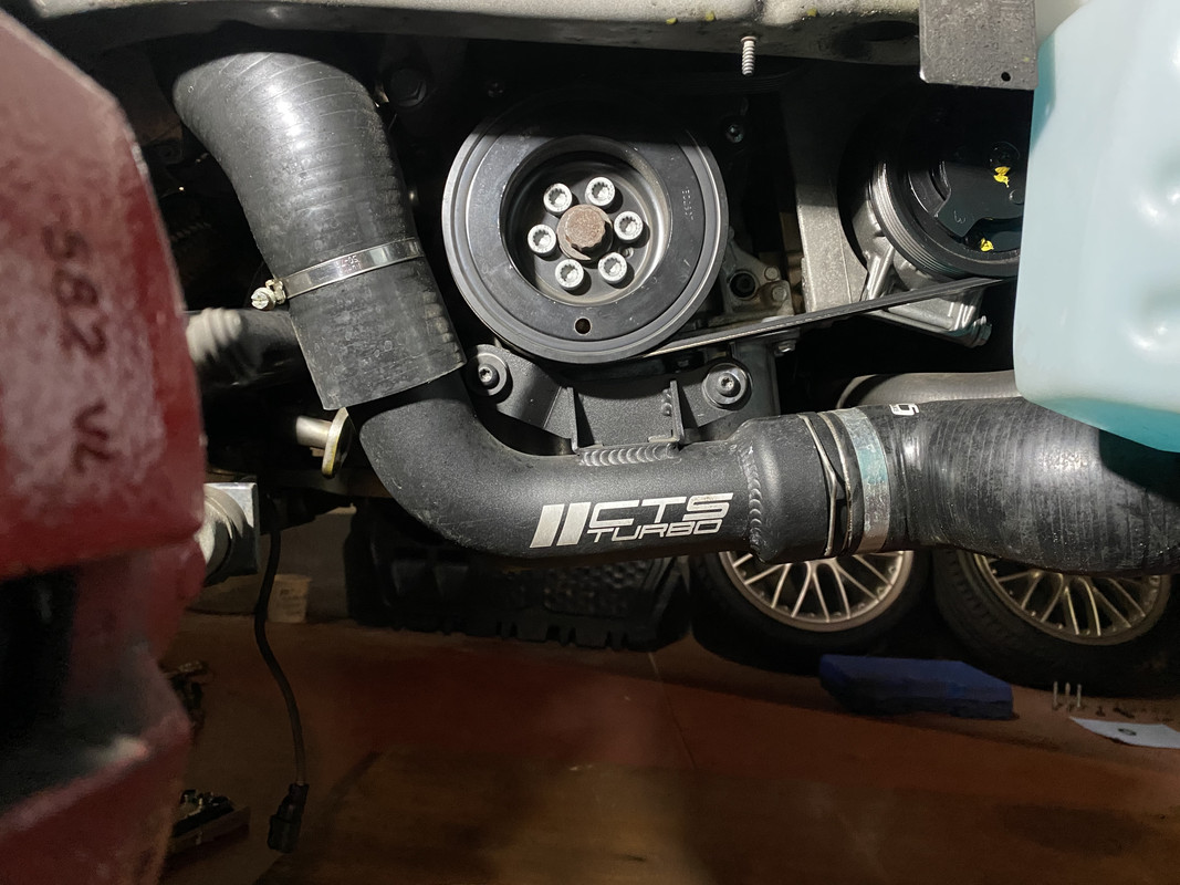

Here are some pic’s…
Also got myself an engine lamp😎 is realy helpfull👍🏻
Draining the oil and unbolting the DSG box from the oilpan
url=https://postimg.cc/4ngR6tPk][/url]
Also disconecting boostpipe
And there is the bloody oilpump / balance shaft assembly again🙄😵‍💫😁
Changed the sprocket for the VIS freewheel sprocket and put a new bolt on the oil pump
And the oil man all cleaned again for the 3rd time….😵‍💫😄
I hope this helps you guys in doing stuff yourselves👍🏻
Some notes:
Oilpan bolts (20) tightened to 15 NM
Gearbox bolts (3) to 45 NM
Turbo feedline bolts (2) from oilpan 9 NM
Oilfilterhousing 25,5 NM
Oil drainplug 30 NM
Oil pick up pipe bolt 9 NM
VIS freewheel sprocket 20 NM + 90*
Oil sprocket bolt from oilpump 20 NM + 90*
Hope this helps you guys👍🏻
