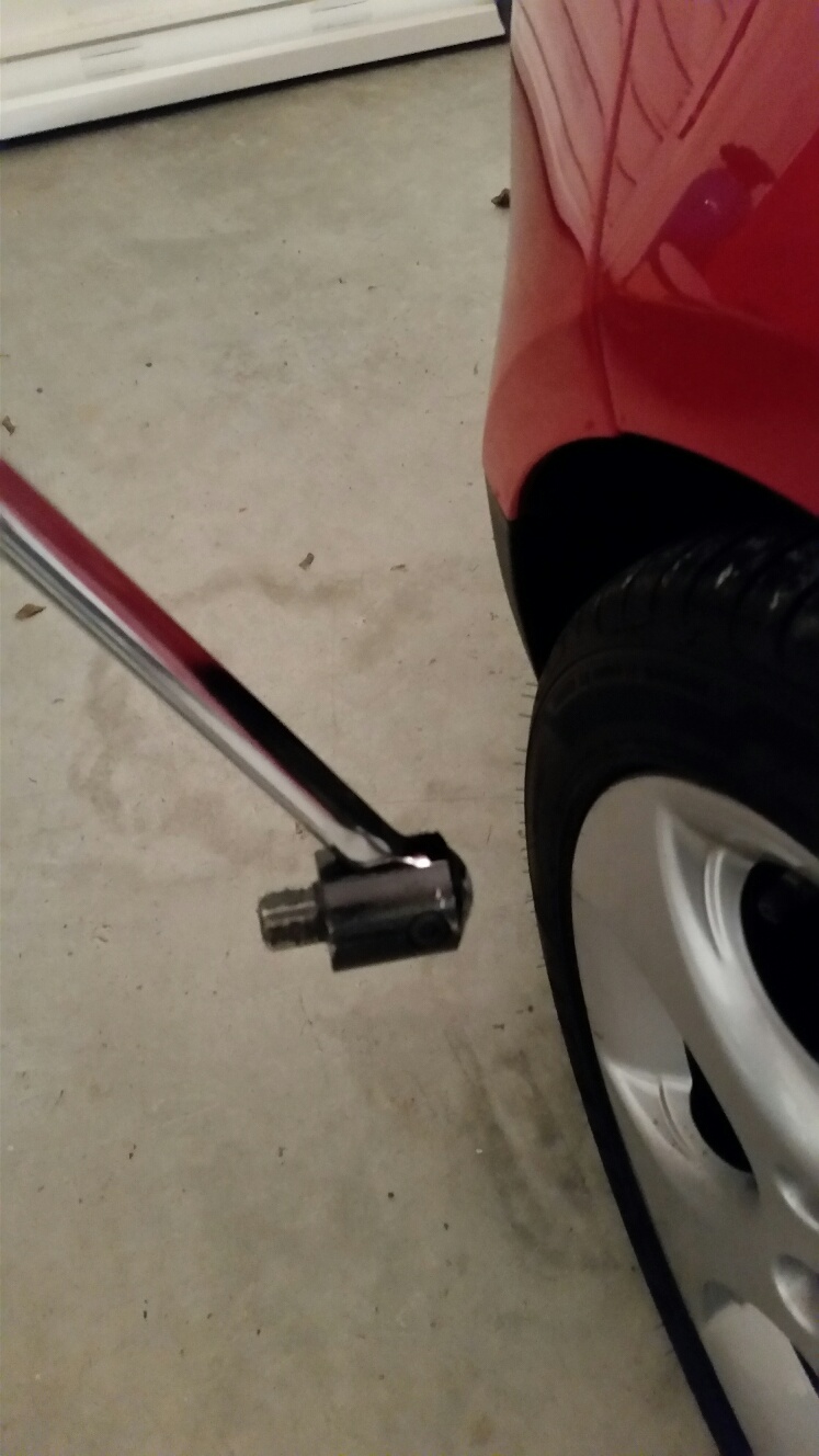

You can never be too safe IMO. I usually put it on an axle stand slacken off the jack then bring it back up so its just touching. And put the wheel you take off under the sill.
I didn't get mine up high enough  :ashamed: but managed to get them off from the top with the breaker bar sticking out of the wheel arch. Not recommended but thought i would share anyway. (tape on the wheel arch).

« Reply #13 on: January 08, 2016, 08:24:32 pm »
I got to the carrier bolts from the top you can get an idea from the pic above and i put some tape on the lip of the wheel arch to make sure i didn't scratch it.
