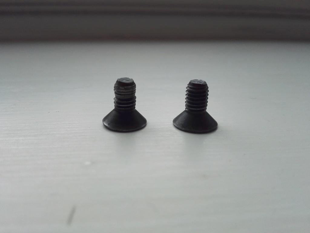

Photo showing the two bolts. You can see one is stripped
Video showing pins and theyre play withiut bolts. Thinking I can ask the welder to make sure they are welded as far apart from each other as possible

« Reply #438 on: March 27, 2016, 02:33:25 pm »
If the pins can freely move/rotate, there's a chance of the pins being welded in the wrong position - mark the pins to the plate so the welder doesn't get it wrong.
Pleased to see you've got the opportunity of a complete head so things are looking up.

« Reply #439 on: March 27, 2016, 03:02:37 pm »
Ok mark them so he gets the right rotation? In terms of them being welded so they are vetically correct, will asking him to weld them as far apart as they can go suffice?
