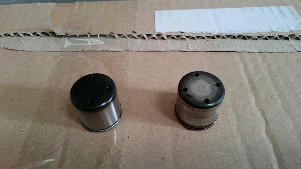

A mate changed this for me today, 96k miles. Piece of mind now..... cheers for the guide vRS Carl  :happy2:  :congrats:
Trying to work out if mine was stage 1 or 2 in the Rtech wear scale?!  :scared:

You'll be ok damage wise I would think, but it needed changing!

This is mine I did 2 weeks ago, 94100 on the clock
