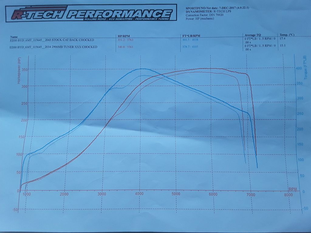

Finally getting this to work kind of. Printout of my results after my visit to R-Tech. Apologies for the stupid photobucket logo I dont know how to remove it.  :fighting:
My own review of my R-Tech map.
Now I had just done the RFD and intake valve clean 2 days before I went down for this map and the car was feeling great, the reason I went to R-Tech was for a couple of reasons mainly I wanted it custom mapped to my liking though.
Nicky done an amazing job with the car. He removed the RFD fault codes so they wouldnt return and also mapped it out so it doesnt run roughish at idle when cold...tbh mine didnt really do this anyway but I wanted it perfected as much as possible.
Also my APR 2+ map was crazy aggresive and I would break traction constantly in the wet....even trying to feather the throttle was difficult with the APR map in wet conditions it was either on or off kinda feeling. I always run mich PS4s so no cheapo on the tyre side of things. APR map wasnt the most fuel efficient either.
Now the linear throttle/boost I wasnt sure about tbh BEFORE I went down and the mapped traction control I didnt really care about or put much thought into since if im going quick or on track it gets switched off instantly anyway...HOWEVER after getting this adjusted also day to day driving it does make a big difference the car is  much more usable as it doesnt come in as harsh or immediate which it did with the APR map which is handy at junctions or any normal pulling away scenario it does make the car a much more usable machine now....again mainly in the wet if your attempting to move a bit sharp.
Linear throttle /boost does make the car drive completely different and at first I was like hmmm...BUT its the bum dyno that throws you as when you actually do compare to the way the car was driving before its much much quicker...the fact i can get traction earlier and keep it down a bit more the car motors like fck. Plus I went againt my mate from works RS3 and lol what a difference.
I dont drive the car every day now but have been using it a lot after this as it has become much more usable and the power stays wayyy longer..
I dont rag the car ever and never hit the limiter (Or anywhere near it tbh) but Nicky did say it could be used right up to the limiter now which would get the most from it.....fck aye does it!! I gave it an ehh controlled run on a closed off road we will say to see what it could do as i kept looking at the map and thght fck it im giving it a go.....now to be clear I never do this as im not a 20 year old idiot anymore but i had to see what it could do.
Car pulls constantly strong to the limiter and keeps up with my colleague from works RS3...to an insane top speed btw.
After driving it now for a week or so I love the R-Tech map...doesnt feel as aggresive but is wayyyyy quicker overall I cant stress that enough.
More usable
More efficiant
Quicker and faster
Cheaper than Revo and APR which are generic
Im not slating these maps/companies as I have been happy with my APR 2+ up until this point however the car is quicker more efficient and my LTFTs are back down to approx 2% which is amazing...My APR map was over 10% albeit I did have slight air leak which i sorted before hand.
I drove 6 hours each way for this and i feel it was worth it so if you live near R-Tech or even in England and only a couple hours away I would highly suggest going to them.
Anyway this is just my personal opinion but there is no doubt the car is running better with this map...I run a standard back box as im 34 and I like to keep it subtle but with a full system Nicky says the car would get really good BHP numbers if you into that...but its now not my daily so considering it :smiley:

Some very healthy numbers there mate  :happy2:  I was up there at one point but have gone back to Mr Chilled Revo Stage 1  :grin:  It would be interesting to see if you get the same numbers after 500 miles.  The ECU always adapts down.  After a fresh map upload, or after pulling the battery, everything is the best it can be......and then after some miles the ECU pulls it back for lifespan.  Annoying.  I never got quite those numbers though.  410lbft torque but only 350ish hp.  Stock exhaust and intake though.  TBH I found it a pain in the arse as it's a daily car.  It's much more useable on the road with less grunt  :grin:  One wheel peels were tedious. Spin doesn't win.  I've found the car is much faster point-to-point on my local roads with top notch coil overs and modest power  :smiley:
I had the linear throttle and hated it personally.  I much prefer the stock throttle mapping, but each to our own  :happy2:  Glad you're happy though and did you ever sort the misfiring problems?  I think you're on the slippery slope now.  TTE420 and a diff for you next  :grin:
I also pulled the torque back because running 400+ torque on stock BYDs can crack the ring lands.  Maybe Shoduchi can confirm, but I think the BYD is not as strong as the CDL.  Having said that, even CDLs bite the dust running those numbers over a long period.  Not trying to put a downer on your good times, but if yours isn't a daily, it's less of a risk  :happy2:

Cheers mate :happy2: I wasnt sure about the linear throttle map before hand but it makes such a massive difference to the usability of the car its night and day mainly in the wet (how long did you drive with the linear map and was it custom or revo cos i genuinly cannot see past it now?), like i said the APR was far too aggressive and didnt give you enough wiggle room before spinning up the wheels which is useless in wet weather conditions where as this map has much more torque which is usable and can be utilised much more efficiciently without having to sacrifice the power. I was going down the Wavetrack route before this but im saving the cash now for other things tbh....not that it compares to a diff but it has made sucha usable difference I can hold off a while longer.
I have a standard back box but i do have the VWR intake so it doesnt feel as choked as it did on the standard intake tbh and the noise is controllable...not a fan of open intakes. I agree about the coilovers, I dont run ohlins but I do run H&R V2s which are height and dampening adjust...not too bad defo do the trick and not some cheapish APs or anything...quite fancy Ohlins just cant justify it now due to how much ive already sunk into the car over the years...if it was 3 years ago and they went lower I probably wld have tbh love the idea of them but they are probs a 3rd the price of the car now lol.
