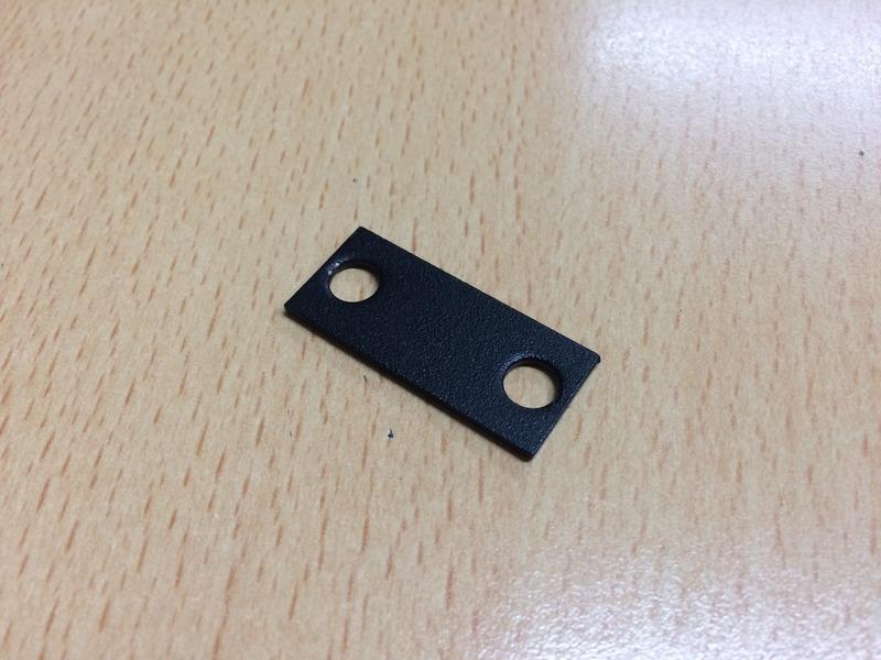

I installed the Revo camcoat intake yesterday and my heat shield rattles on top of the radiator. I'm sure I have fitted it correctly as per the (limited) instructions. I have one piece left over that Is not mentioned in the instructions so i'm just checking I have it correct. The piece is a small black rectangle of metal, A bracket of some kind. It's about 10mm x 25mm and has 2 holes either end. Should this be used somewhere?

bacillus, I have that one fitted correctly and the one on the front that uses the hole from the OE intake. I have also used the spacer from the engine mount to the pipe. Still have this one bracket left unless it's meant for a KO3 setup or a different car maybe?
I have not contacted revo yet, I was just asking to see if anyone has had the same problem. I will try and take a picture of it later if i can get away from my office today.  :fighting2:

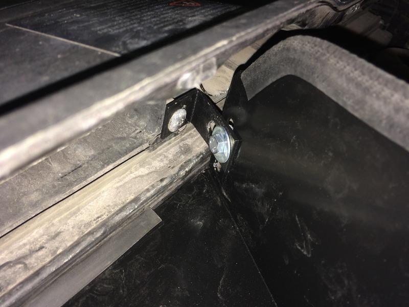

Here are the the pictures of how i have fitted mine.
This is the engine to pipe fitting using the plastic spacer. It's not that secure and does move a little.
Rear of the heat shield.
Front of the heat shield. (I fitted the rubber strip to try and stop it rattling on the radiator but it didnt work)
And the left over bracket

Yep the Revo approved place I had mine fitted at put that left over bracket between the engine mount and the mid-pipe instead of the spacer
