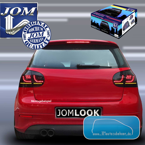

Hoping someone has fitted these or knows someone that has.
I purchased these aftermarket LED rear lights for my ED30 the other day and they require some messing about to get these wired up.
http://www.ebay.co.uk/itm/131778439224?_trksid=p2057872.m2749.l2649&ssPageName=STRK%3AMEBIDX%3AIT
The problem is not getting the lights to work, but actually feeding the wiring from by boot lid lights down to the main lights without having the wires exposed. If anyone has an easy way of doing this or can offer suggestions, please let me know. Otherwise I'll end up paying someone else to do it (which I don't like)
Also, noticed that the reverse light and fog lights are the opposite way around, probably as they're non UK spec. I have two options here:
1 - Can you change these around in VAGCOM
2 - I extend the wires and swap these around (a bit of messing about)
They end up looking like this once on
Please help!!
