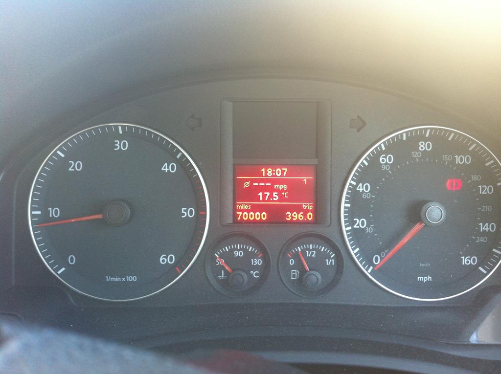

Golf ticked over the 70k mark today. The day I bought it then it ticked over 60k so almost exactly 10k in a year (it's a year plus about a week).
MOT tomorrow and hopefully should go through without any trouble. Gave it a good hoover out this evening and will give it a wash in the morning, I know it won't make any odds to the MOT but it's always nice to have a clean car, especially when other people are looking at it that closely.  :happy2:

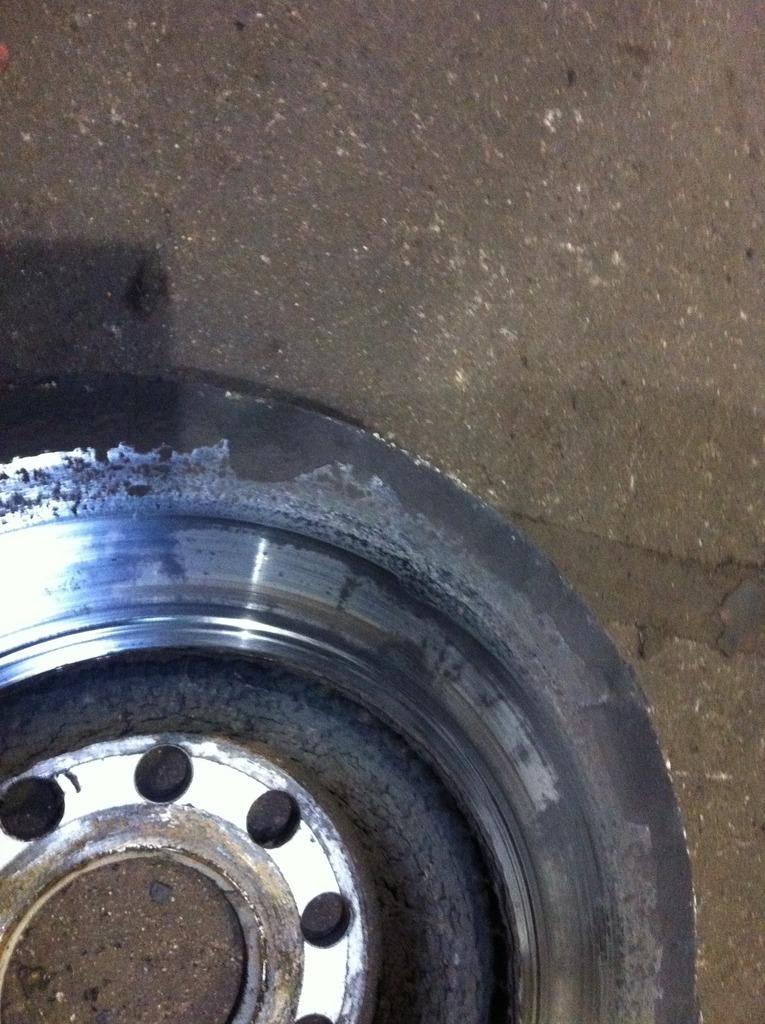

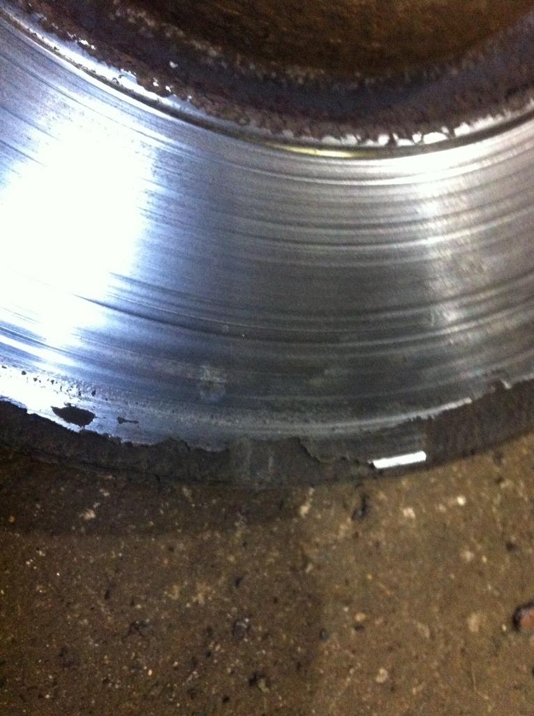

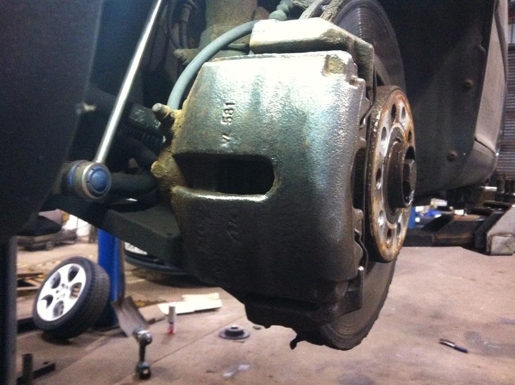

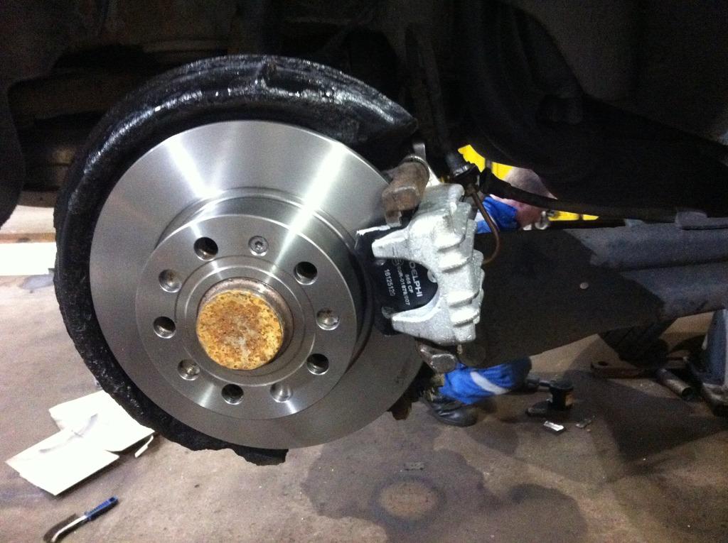

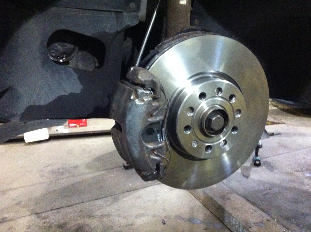

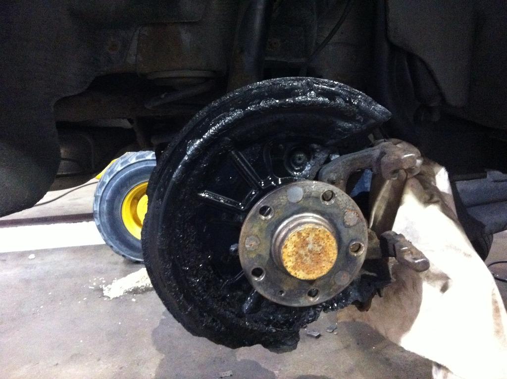

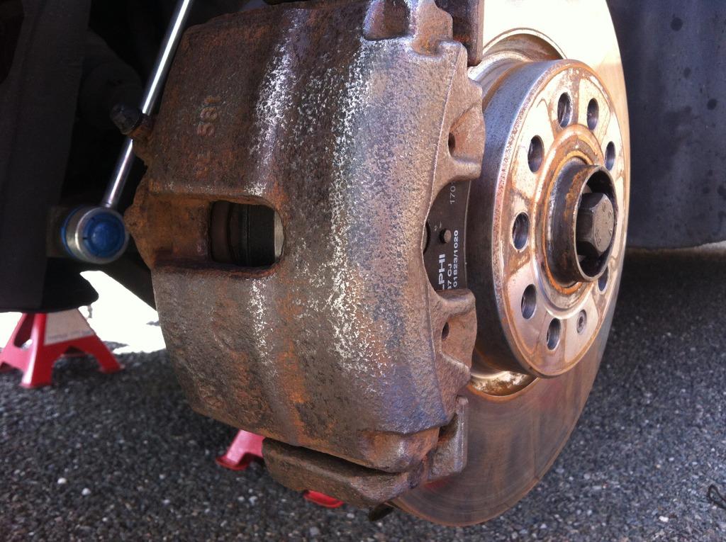

New discs and pads fitted all around, new offside rear caliper plus a bit of new brake pipe, wire brushed and then painted the rear dust shields with a quick coat of black paint to protect them a little longer and can only get to them when the discs were off. Calipers cleaned with needle gun and then air powered wire wheel to give them a good freshen up ready for painting which I'll hopefully manage to do in the next few weeks. They'll just need a good wash, quick once over with wire brush again and then some IPA before primer and paint.
Some pictures, all from Iphone 4 so not the best quality but you get the idea.

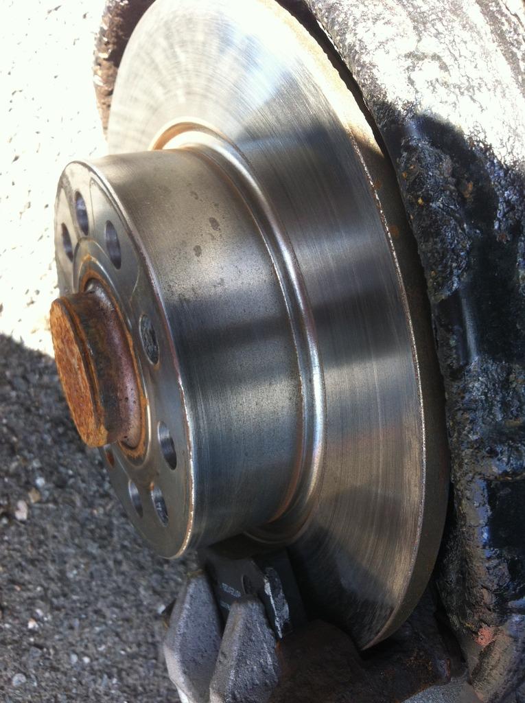

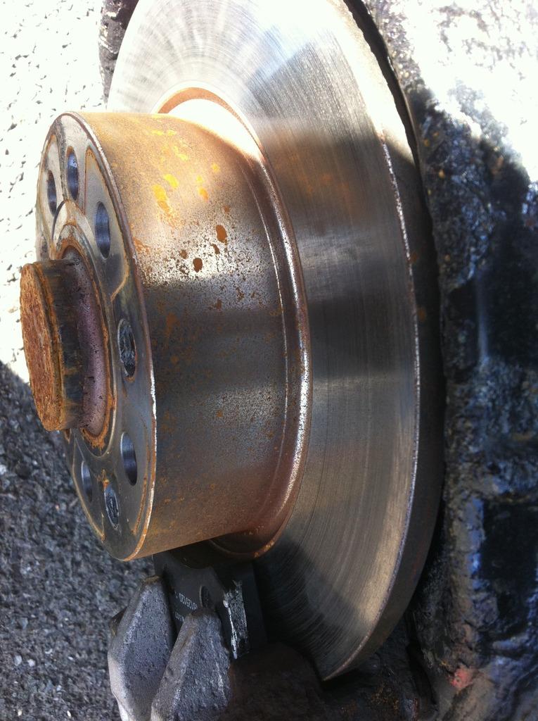

So this is the front offside disc which was the advisory on the MOT last week. as you can see the inside face of it is pretty bad, the outside face didn't look too bad but it was definitely time for them to be changed as it had quite a bad lip and quite deep waves/grooves on both faces:
Inside face:
Outside face, this was the worst part of the outer lip:

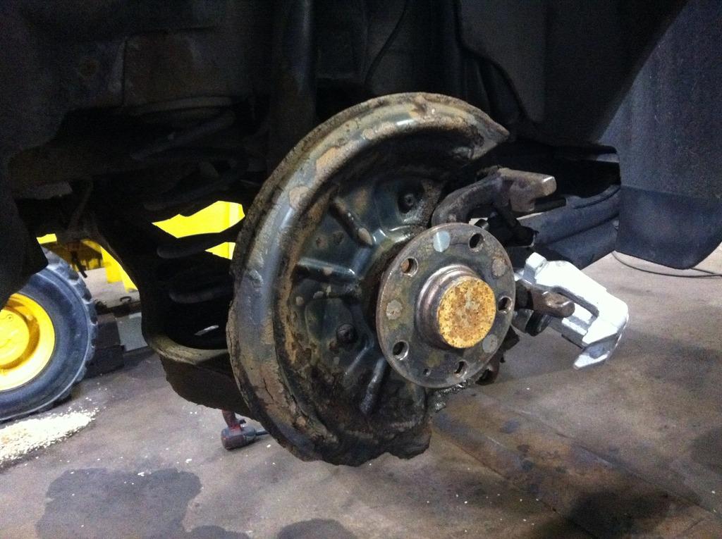

Rear dust sheilds are both pretty corroded on the bottom edges but mounting points all seem to be fairly solid so gave them a quick once over with a wire brush and then some black paint to protect them a little:
Before:
After, not perfect but a lot better and hopefully will help it last a bit longer:
Front caliper 50/50 cleaned up:
Front caliper fully cleaned up:
New rear disc, pads, caliper and brake pipe (just the little solid pipe that goes from caliper to flexible pipe - I wouldn't have known where to start with that but Murray just made one up in a couple of minutes  :drinking: ):
New front disc, pads and caliper all cleaned up:

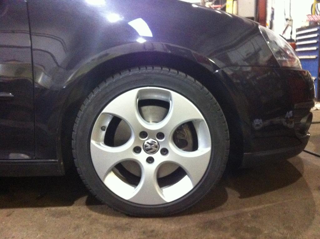

all back together and back on the ground looking much better:
Can't wait to paint the calipers red as they'll look so much nicer but even just cleaned up they look a lot better.
The new brakes feel really nice, obviously only done about 20 miles with them but they're silky smooth with plenty of progressive bite. Really impressed with the delphi stuff that I got, well packaged, came with everything you needed, little fitting kit bits etc and seems to be nice quality.
Couldn't have done it without my friend Murray and having the car up on the lift just makes life so much easier!

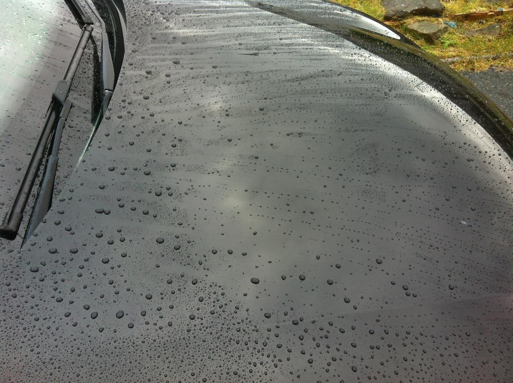

Bit of Gtechniq C2v3 beading, it's amazing how well this product works and how long it lasts for just being a spray on/wipe off product.

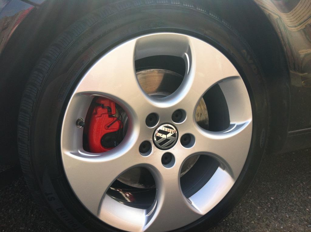

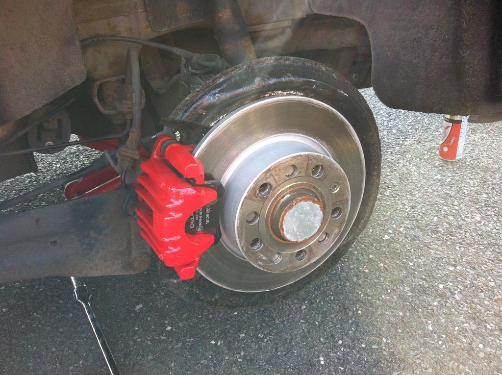

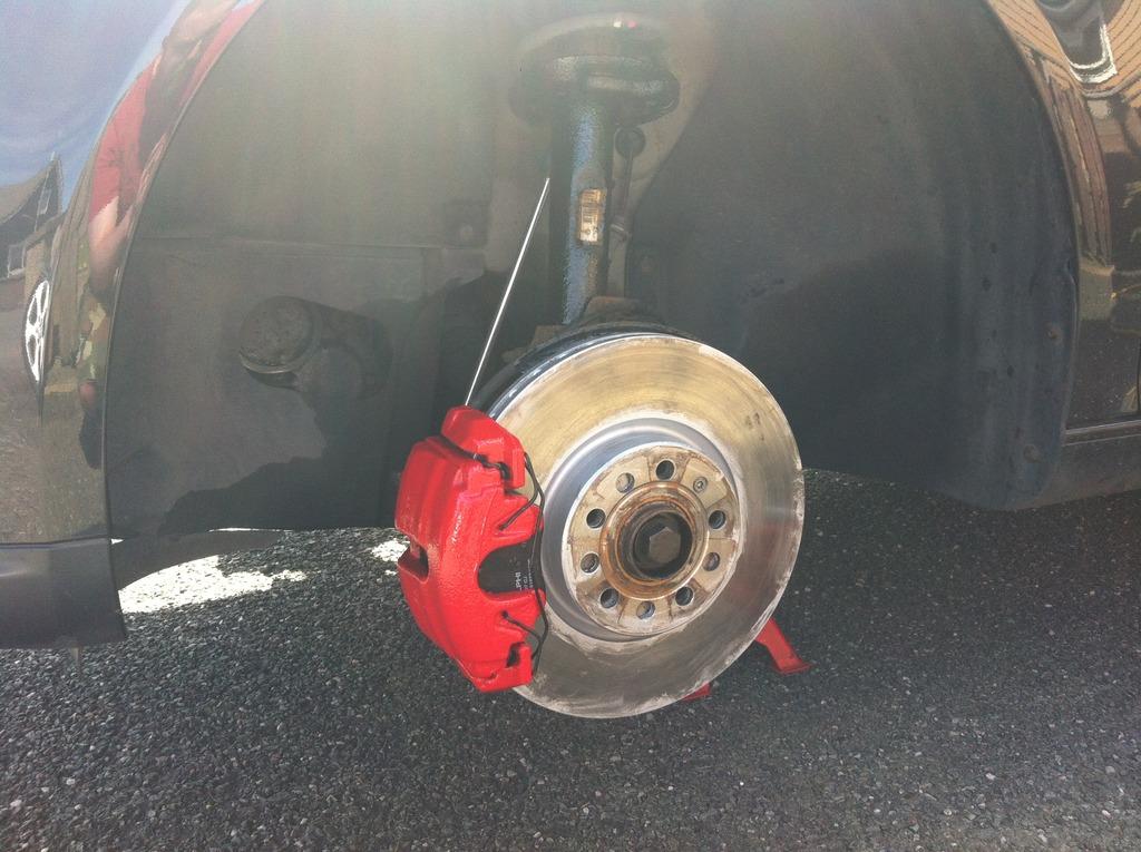

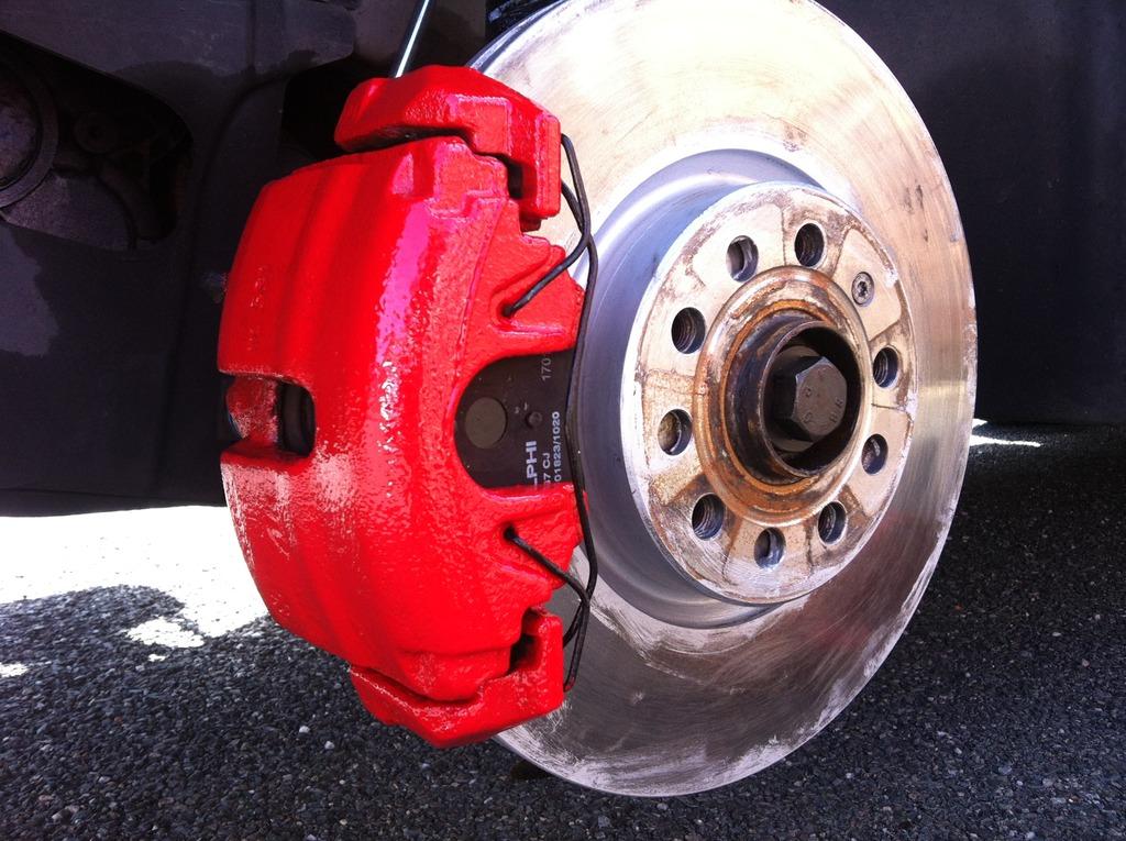

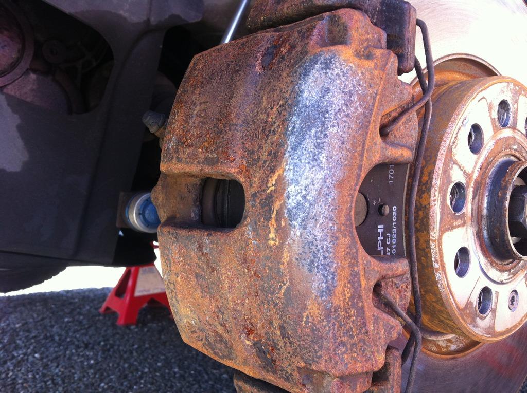

Managed to get my brake calipers all painted and i'm over the moon with how they look now. I did most of the cleaning work a couple of weeks ago when I replaced the discs and pads but the calipers had started to rust over again and the hubs on the new discs were getting quite rusty already too so gave them all a quick clean and then painted the hubs and edges of the discs with silver hammerite and the calipers with red caliper paint. Cleaned and painted a few other bits and pieces like suspension struts and dust shields while I had the wheels off too.
So here are some pictures from my day:
Calipers rusting over again were cleaned with a wire brush and some 800 grit sandpaper then wiped down with holts brake cleaner to make sure they were super clean ready for paint.
Before:
After:
Painted, spring retainer clip sanded and painted with black hammerite:
Painted suspension strut:
Fronts all done and deep cleaned wheels back on:
Rear hubs going rusty:
After a scrub with some 800 grit sandpaper:

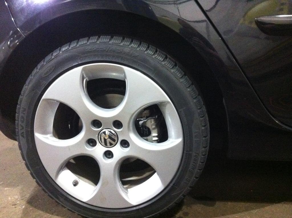

Rears painted:

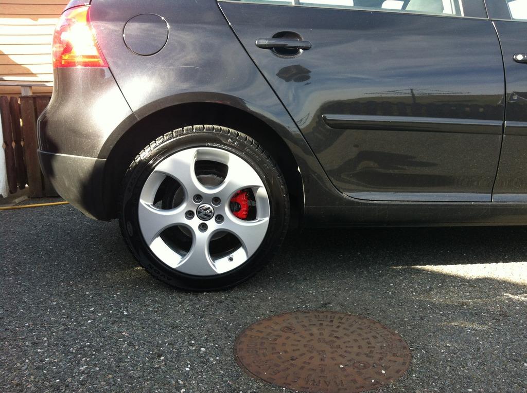

Rear wheels back on:

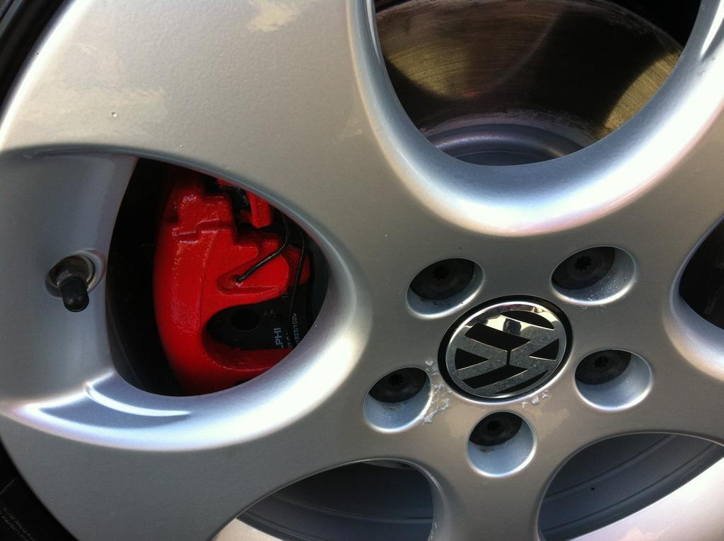

Couple of closer finished shots:
Fronts:
Rears:
Both:
Cheers,

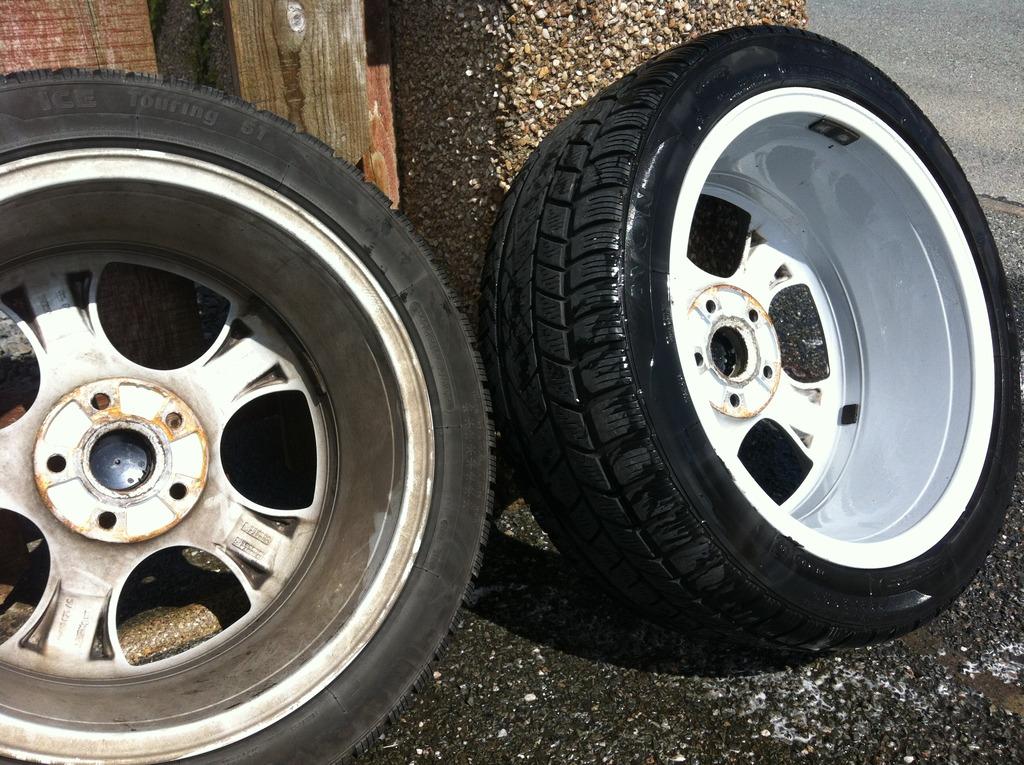

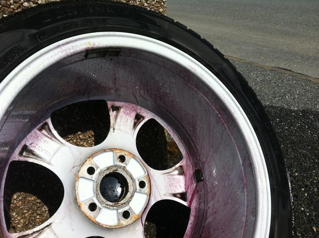

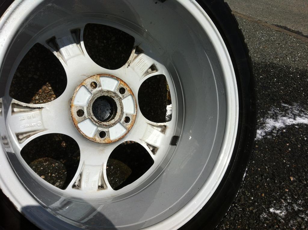

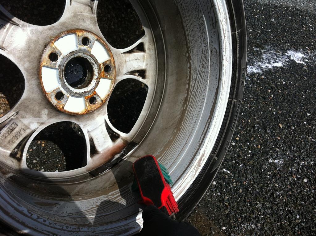

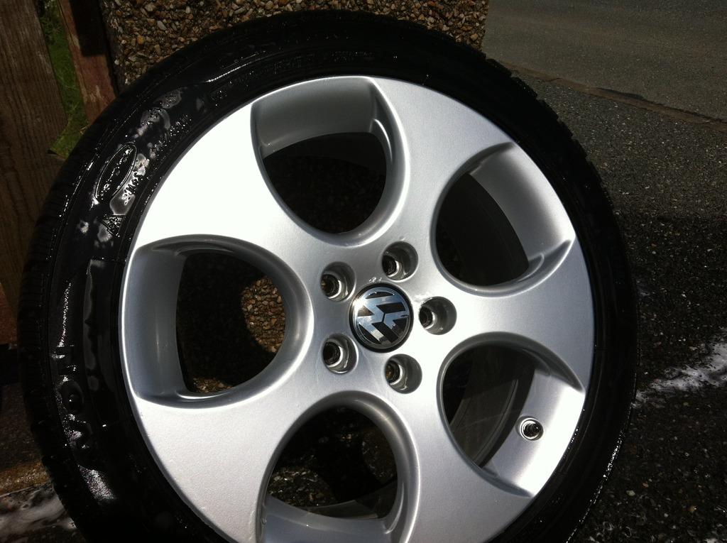

Deep cleaned the wheels while they were off for painting the calipers, I polished them and then sealed them with Gtechniq C5 and EXO when I first got them and before fitting them to the car so they were super easy to clean this time and came up really well.
I used a Vikan wheel brush,
Bilberry Wheel cleaner (non acidic so isn't as harsh on the wheels),
Iron X.
50/50:
Bilberry wheel cleaner and Vikan brush:
Iron X left to dwell for a few minutes, not a huge amount of contamination:
Washed with Bilberry wheel cleaner again and given a good rinse off. The little spots that are left are tar but There wasn't that much and I wanted to get on with my brakes so left it for now but will give them a going over again soon and remove it then:
Faces all cleaned in the same order:
I then left them to dry while finishing my brakes and put some Gtechniq tyre and trim on the tyre sidewalls to give them a little shine as can be seen in my last post with the brakes painted.

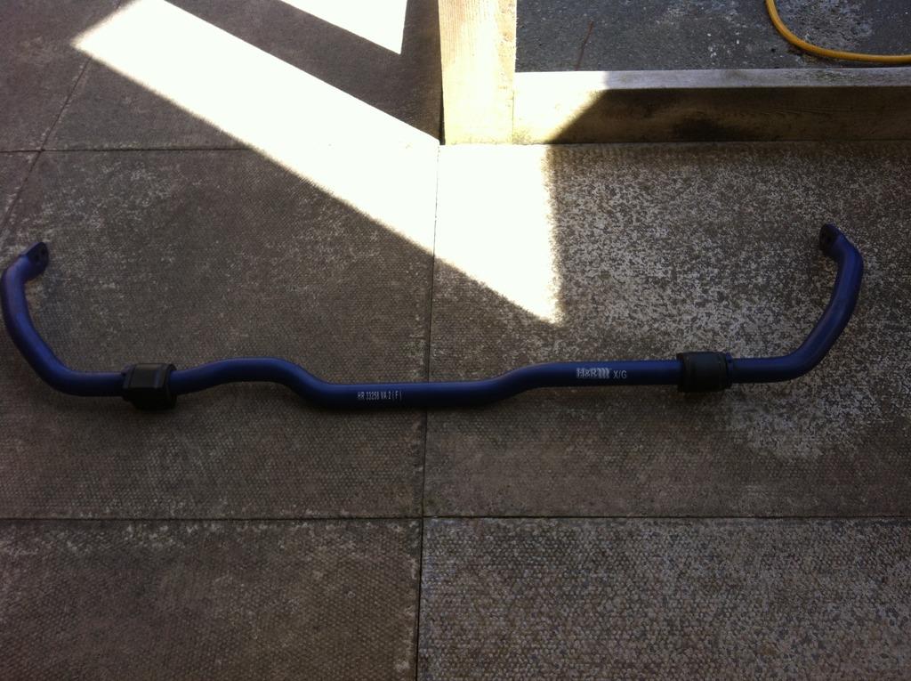

My H&R front anti roll bar also arrived after buying it from a forum member, thanks again @Biano44 . Going to get it fitted once I have a rear one to be fitted at the same time (hopefully that and a set of H&R lowering springs going to be bought soon):

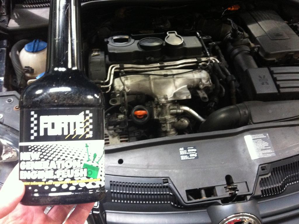

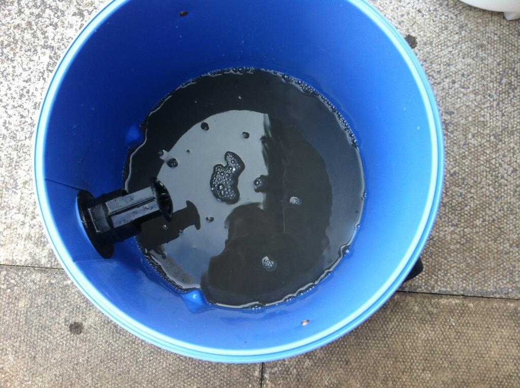

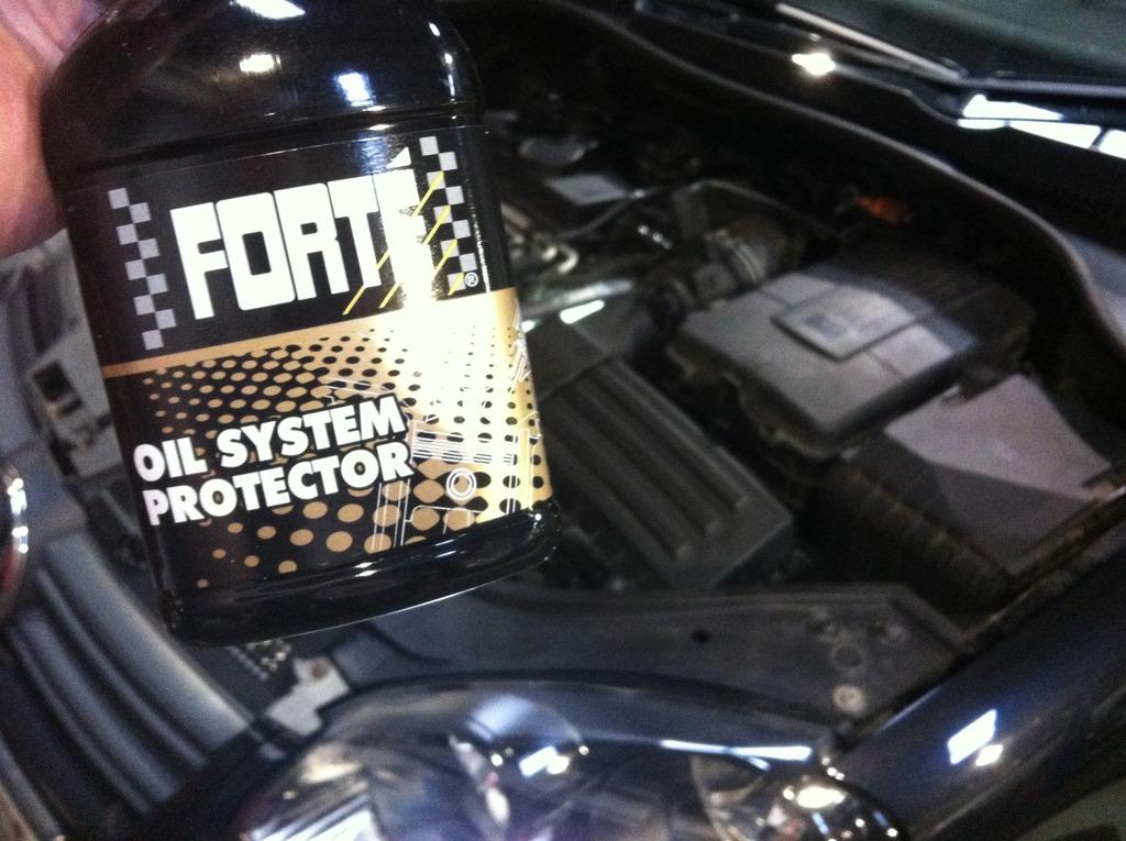

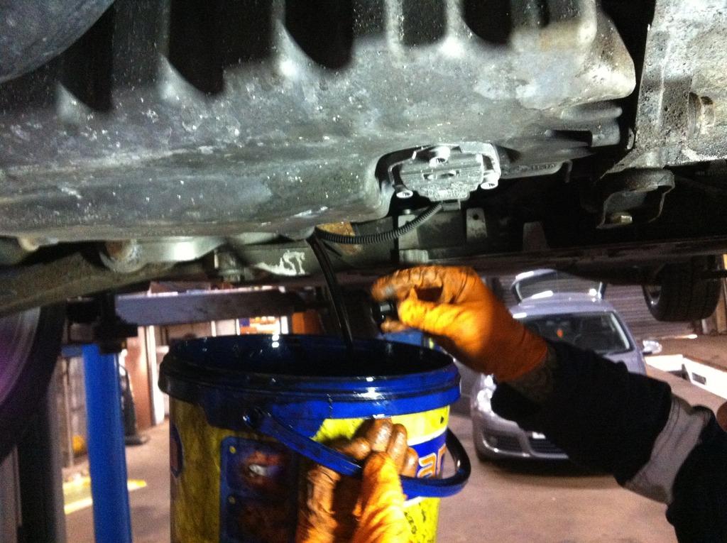

Oil change done tonight at 70500 miles with Quantum dpf safe low ash oil. Also gave it a flush with forte new generation engine flush before dropping the old oil and then put in Forte oil system protector additive with the new oil. I never usually do an engine flush when changing the oil but my mechanic friend said it was a good idea so if he says it's worth it then I trust that.
Engine flush going in with the old oil, car left to idle for a while to let it get around the system and apparently helps remove varnishing and gunky deposits:
Old oil dropped out:
Oil system protector additive which went in with the new oil:

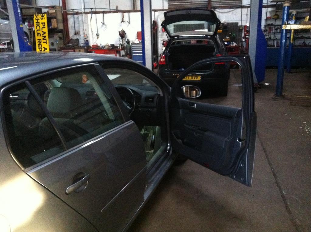

While my car was sitting idling then I helped my friend Murray, who has just bought a mk5 gt tdi 170 with a few bits on his car. He fitted the hardware for the boot pop kit and then I used VCDS to code the centre button on the key fob to make it pop the boot. I also switched off the selective door locking/unlocking as well as activating the horn/alarm chirp when locking/unlocking the car. We also fitted an LED interior light kit to his car.
Here's a photo of the two of them, my car idling at the lift and can see the footwell LED's have been Done on Murrays:

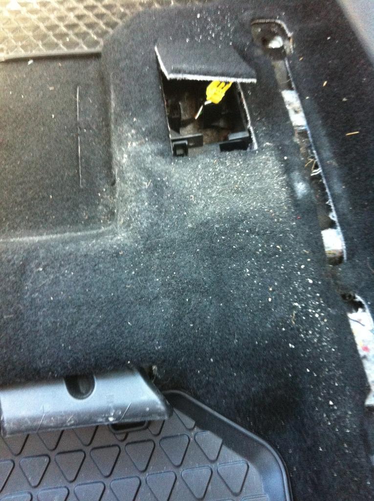

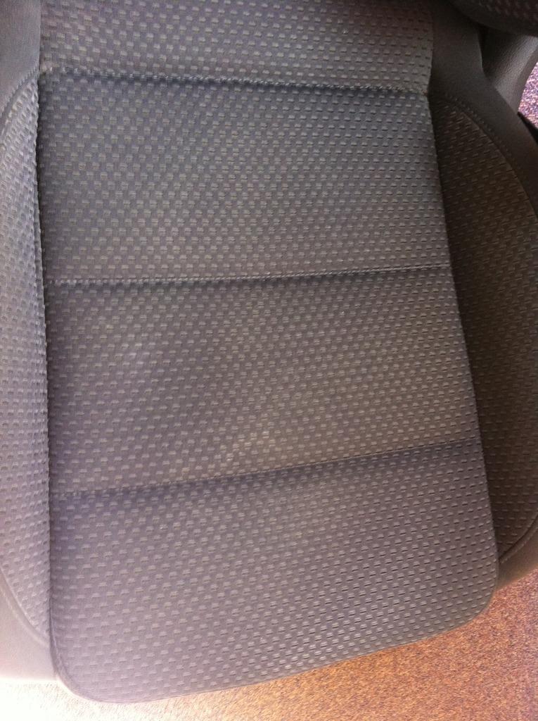

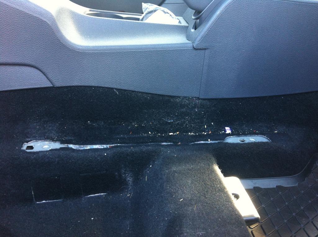

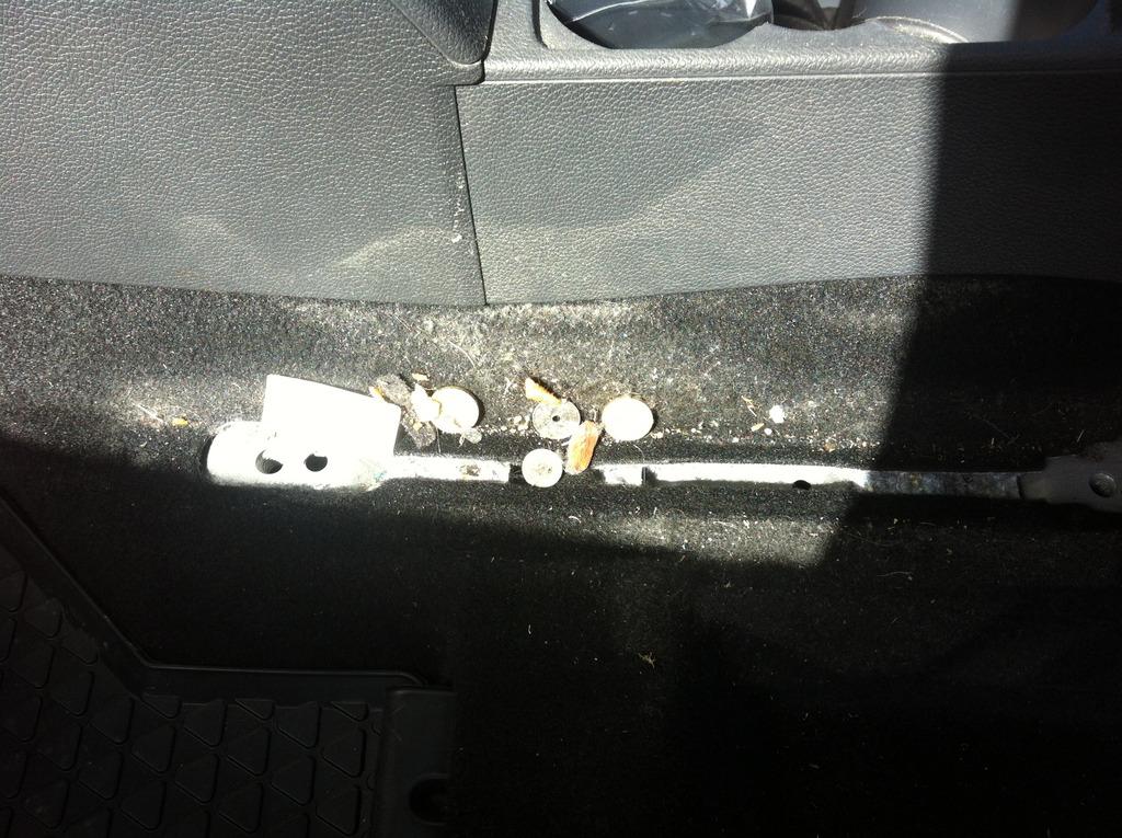

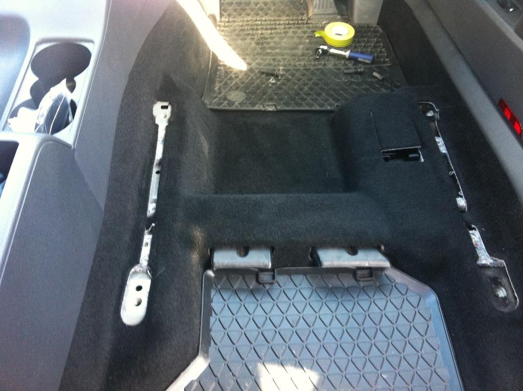

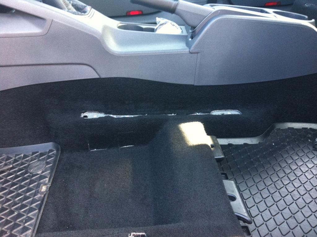

Removed the seats and gave everything a good wet vac. The interior wasn't bad at all but it's amazing how much the wet vac can extract. In total I found £2.27 and 1 Norwegian Krone  :grin: It was pretty dusty down the inside edge of the seats and the only way to get to it properly is to remove them, only 4 screws and a couple of electrical connectors (One of which is for the seat side airbags so battery was disconnected before hand and connector taped up to avoid any accidental discharge oooer!  :scared:)
A few pictures:
This was with the drivers seat removed:
Cleaned:
Passenger side seat removed:
Cleaned:
Drivers seat doesn't look too bad but a little bit of dirt ingrained in the fabric:
This was just from the drivers seat  :surprised: :surprised:
And the rest of the car:
Didn't really get any finished pictures but looks much better.

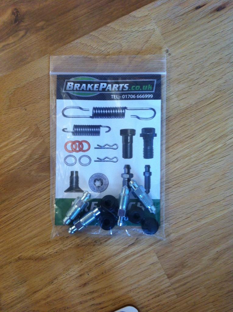

Also ordered some new bleed nipples as I'm going to be replacing the brake fluid soon and the nipples on the calipers look a bit worse for wear so going to replace them:
