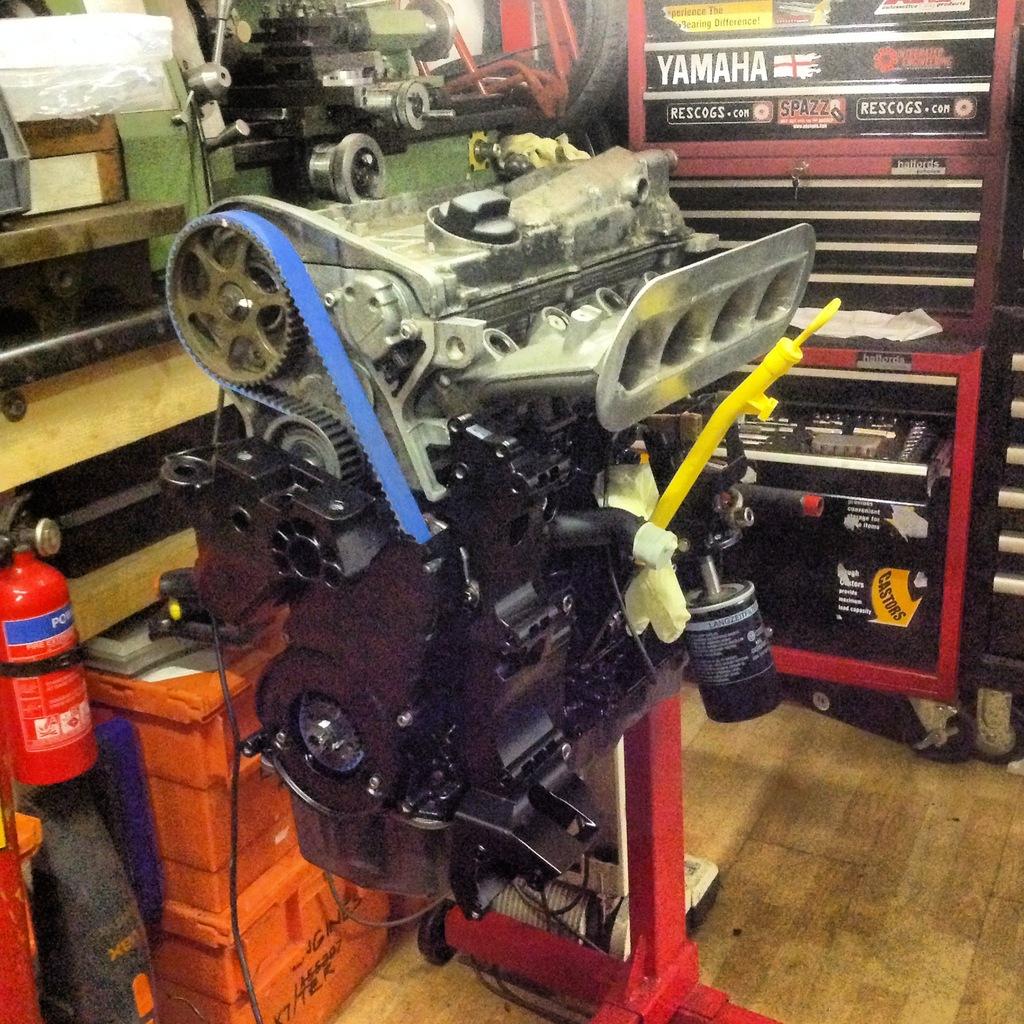

Original Engine spec:
AGU block 1mm oversize 1825cc
AGU Big port head, ported, polished, full supertec valve train, piper cams.
Wossner Pistons (Std compression)
I.E Rifle Drilled Rods 20mm
Splutter Bearings, OEM thrust bearings
ARP Hardware throughout
New OEM oil pump, chains tensioner, chain, water pump etc.
Pinned bottom pulley

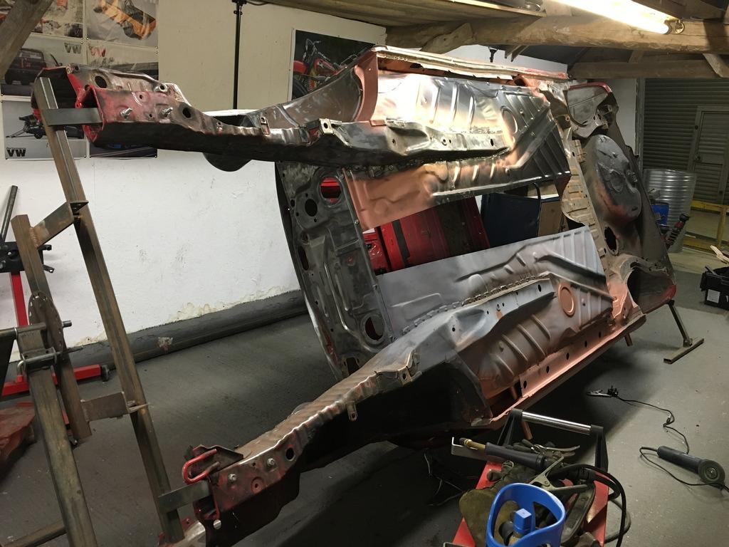

Strip Down:

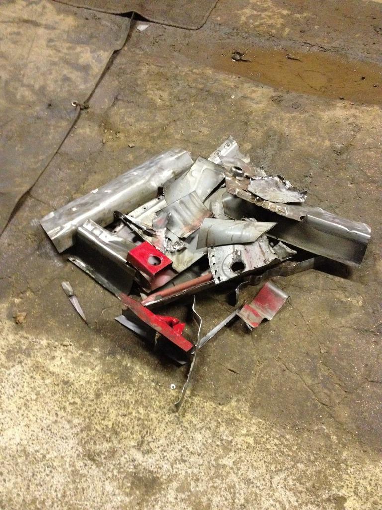

Stripping Underseal and sound deadening…..again. Well over 20kg removed which will help with the final target weight.
Also removed the rear bench support, more weight gone.
New Panels:

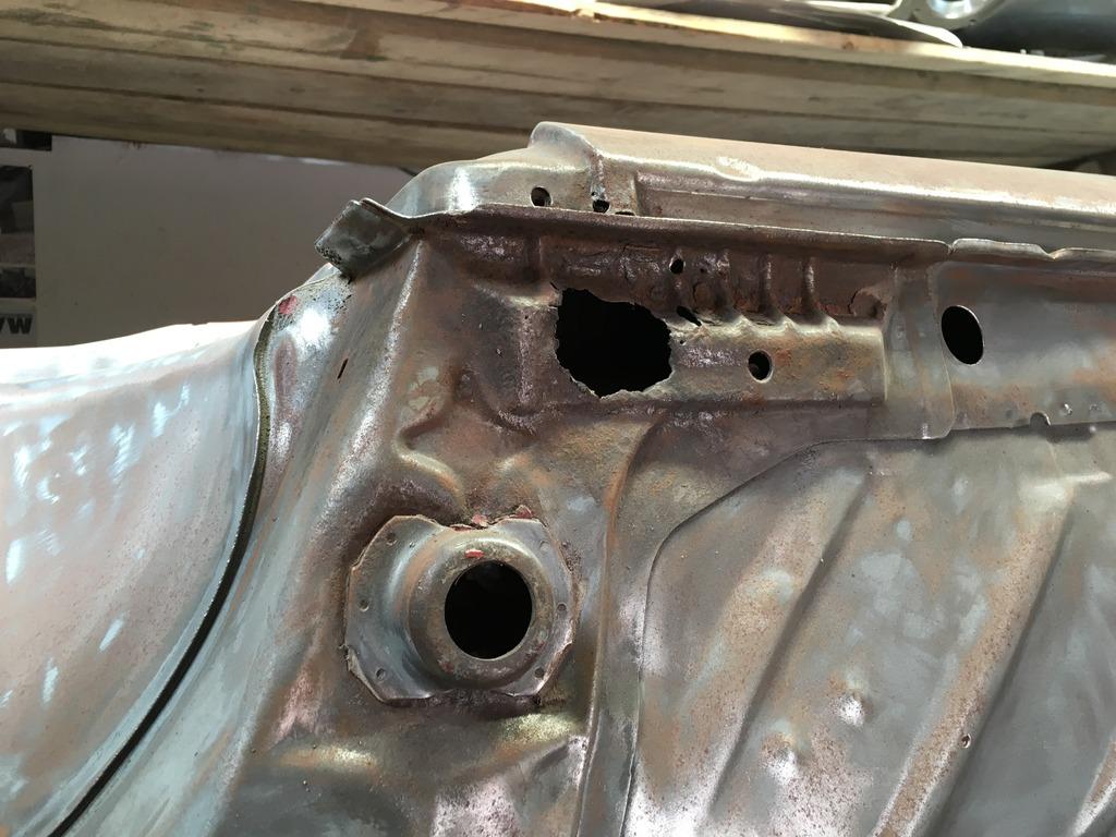

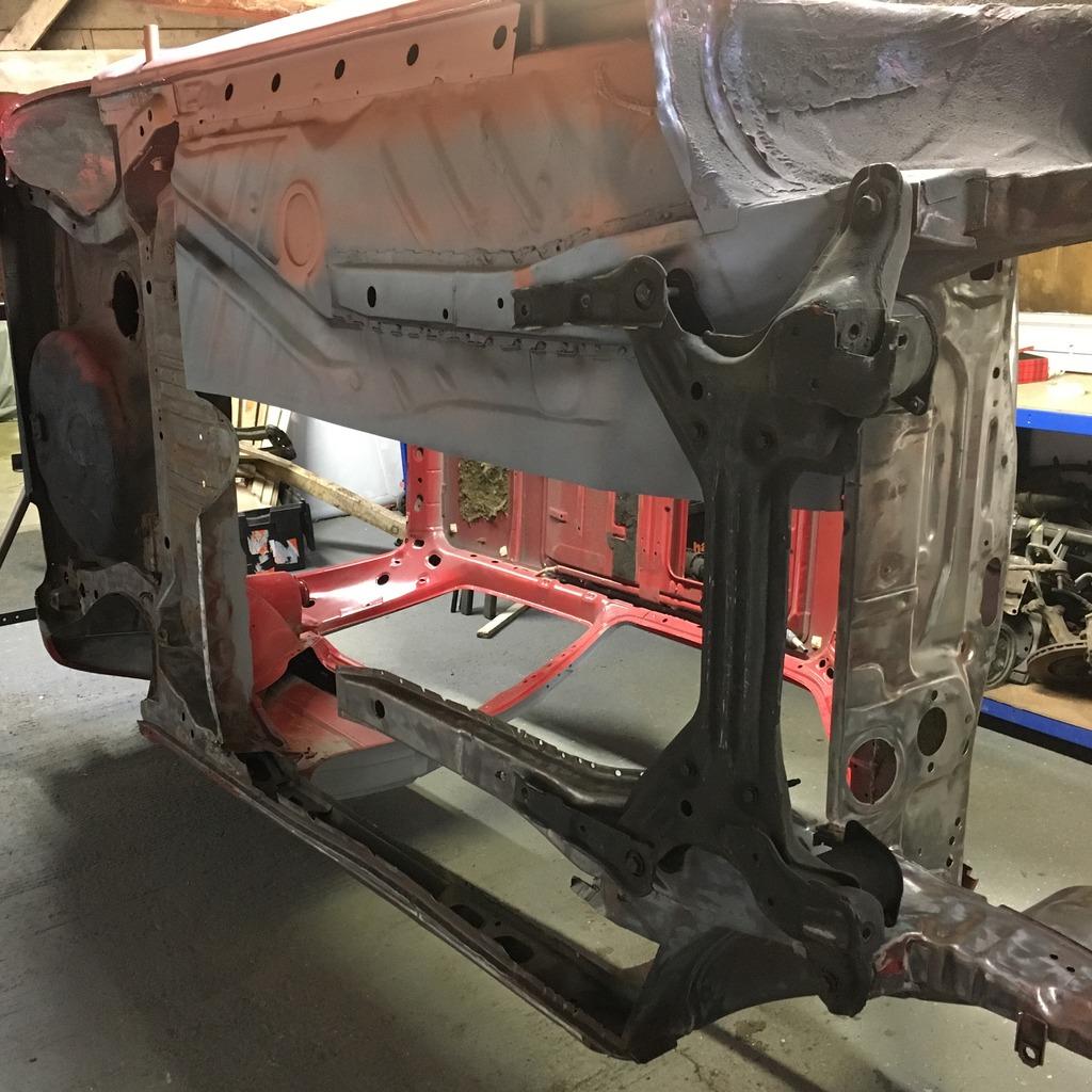

Once the car was stripped it was clear that the shell wasn’t as clean as first thought. Although the floors could probably be repaired in sections, I didn’t want to have a patch work quilt so replacing the whole lot was the best option. A brace was made to run across the door aperture to keep things nice and straight. A few hours later and I got to this point. Out it comes!!
With the floor removed I could clean up the inside of the sills and the front chassis arms. This also meant the removal of a small piece of channel that the original fuel lines ran through. Which was a complete water trap and also rusted through.

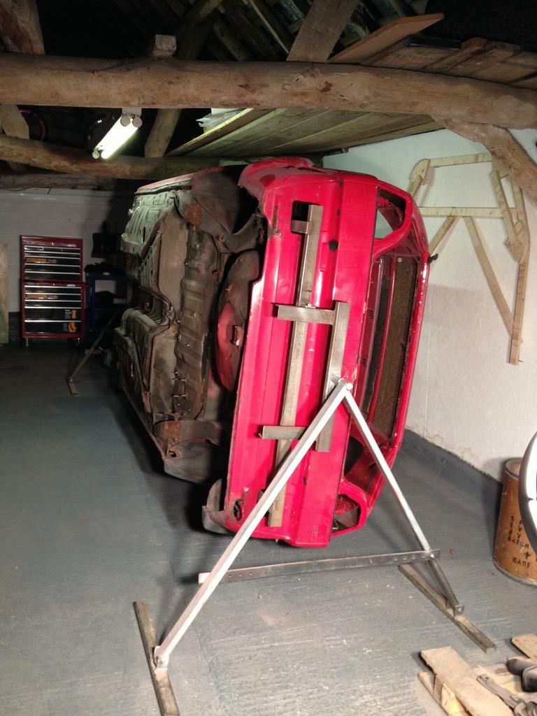

Sill Stands:

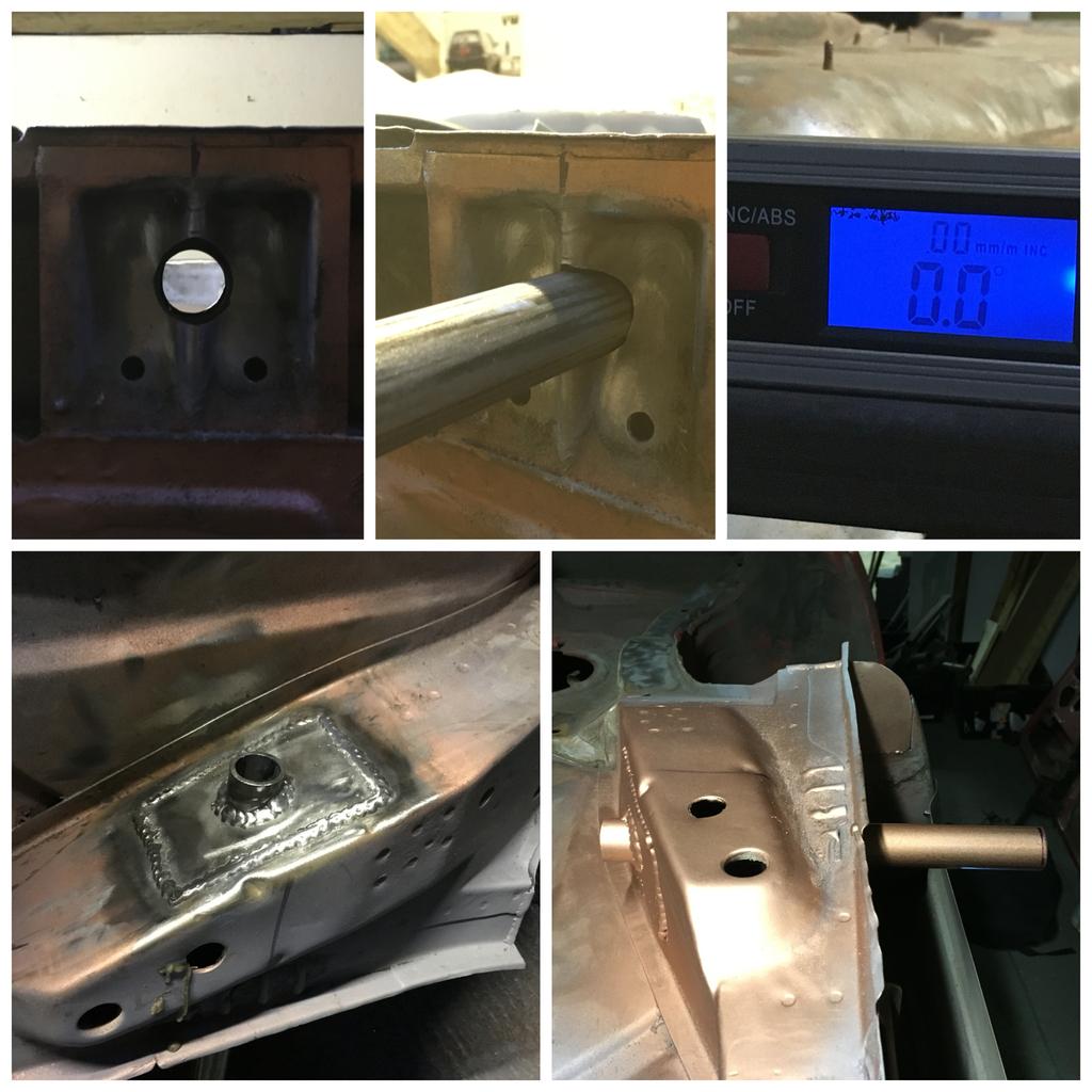

Before the outer sills got welded on I decided a race car isn’t complete without sill stands. Due to the nature of the car and what I will be asking it to do. It will break! Whatever I can do to make maintenance and servicing easier the better. The sill tubes are 26.9mm OD with a 3mm wall. Leaving an internal diameter of 21mm. the stands will use 20mm pins. Axle stands aren’t fun at the best of times so this is a much simpler and safer way of getting the car up in the air. We can also make different height stands to suit.
Example of the stands we are building
Drilling a hole through 4 pieces was quite a challenge
Tube test fit
All in and welded up, copy and paste to do the fronts then.

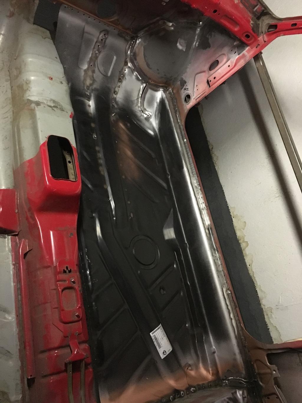

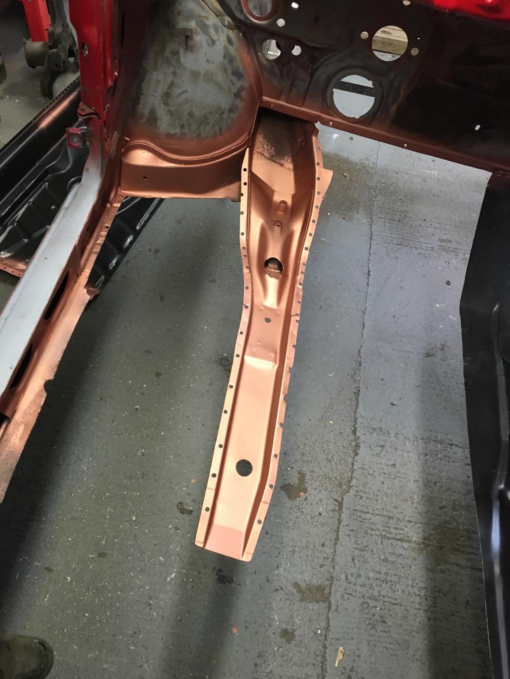

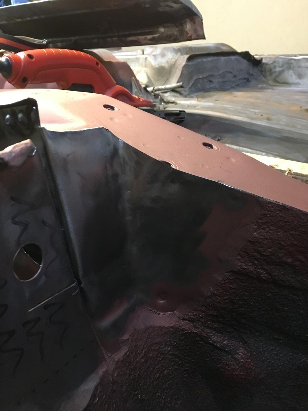

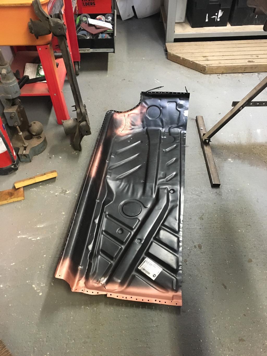

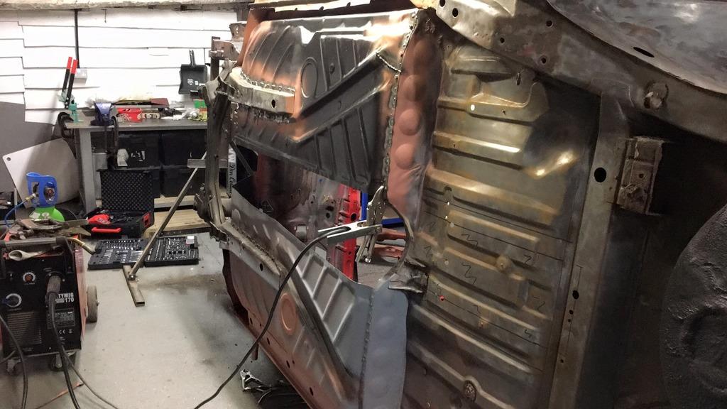

Managed to grab a couple of evenings last week and made a start on the other floor panel. Again nothing major but some idiot in the past has jacked the car up from the middle of the sill and this has collapsed. So as I have to repair that it’s a simple enough task to do this as well.
Front Jacking Point
Original floor and tunnel removed
New panel ready to go in
Rails cleaned out and painted with weld through primer, will be filled with wax oil once the cars been painted so this will protect it for now.
Time to weld her up. Held in place with a variety of clamps and tec screws.

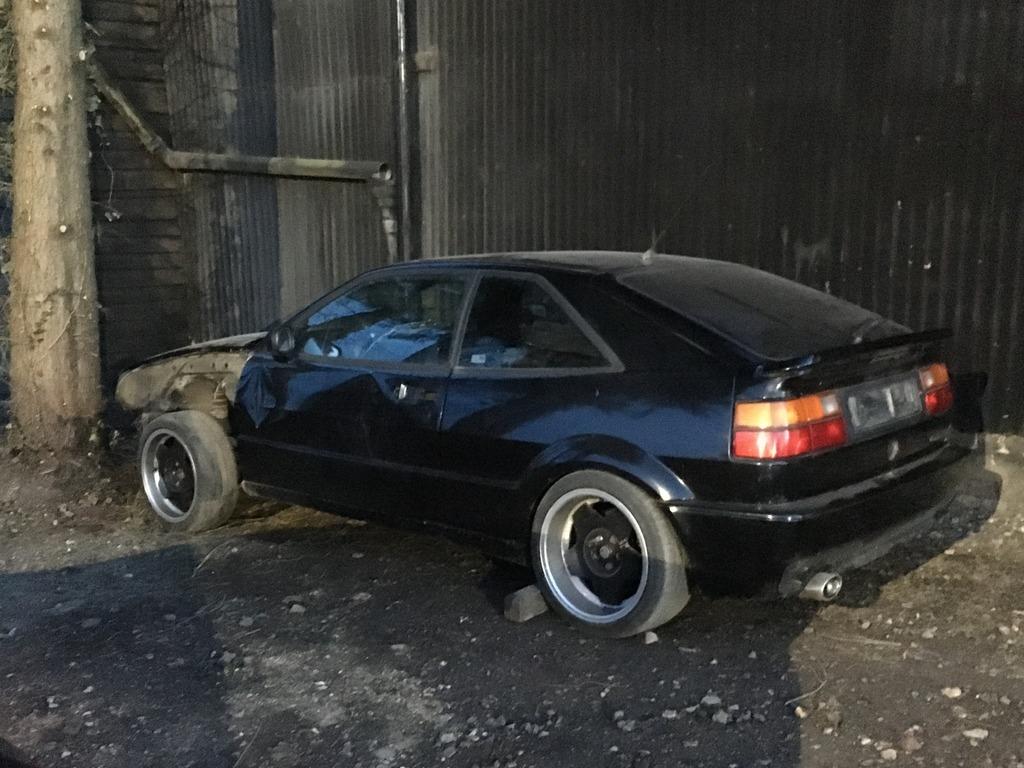

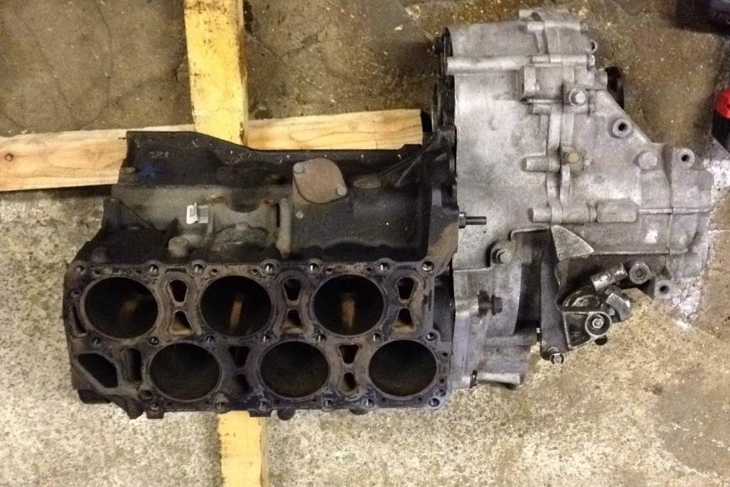

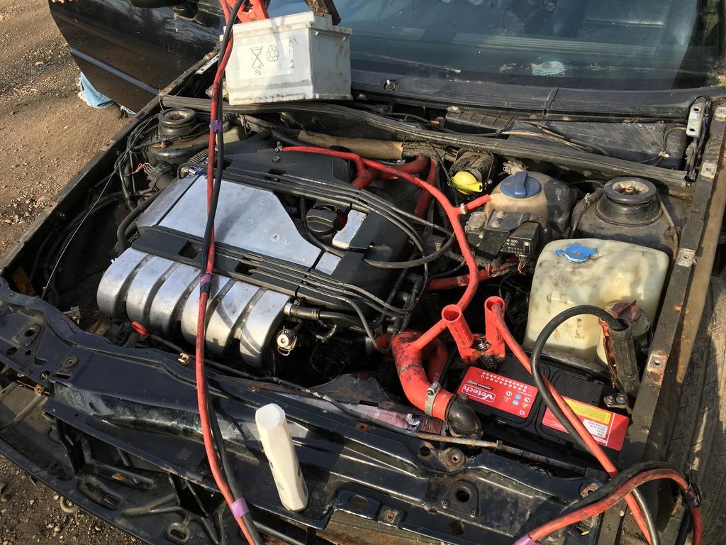

Did a buy! A friend of a friend of a friend of a friend has had this corrado sat in his garden for years. Interior was completely shot and the shell is rotten through but (excluding the wheels) he only wanted £100!!
Even better news was it’s a VR6, so that’s all the engine mounts, front hubs, cross member and a few other bits I can use. We managed to coax it into life for a few seconds aswell.
There were rumours that it was a forged engine which were quickly expelled once we pulled the head off. Not to worry the crank will find a new life in my R30 build.
