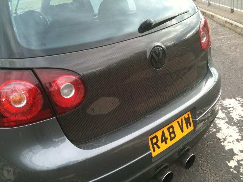

well had a mishap last year  :ashamed:
eventually got my finger out and been working to sort my back end  :chicken:
got myself a US R32 back end,Milltek R32 zorst and also a Seibon carbon bootlid  :party:
excuse the crappy iphone pics
not 100% on the exhaust fitment as i might still adjust it back a bit (altho the pics are after some "spirited driving") and still got a bit of tidying up to do on the back end.
Overall happy with the way its turned out  :jumpmove:

My r32 milltek exhaust sat like that, loosen the clamp between the centre section and the downpipe/milltek connecting pipe and tap the whole thing back with a rubber mallet. Loosen the rear section clamp and tap the tailpipes up to sit closer to the bumper :happy2:

Black real carbon with Steel Grey looks great  :drool: - Did you get your Seibon here in the UK or from across the pond?
That sticky plaster 'X' is brilliant!  :notworthy:

Echo what RR said. Fantastic  :notworthy:

Ohhhhh that carbon bootlid looks the bolloc*s how much was that??
