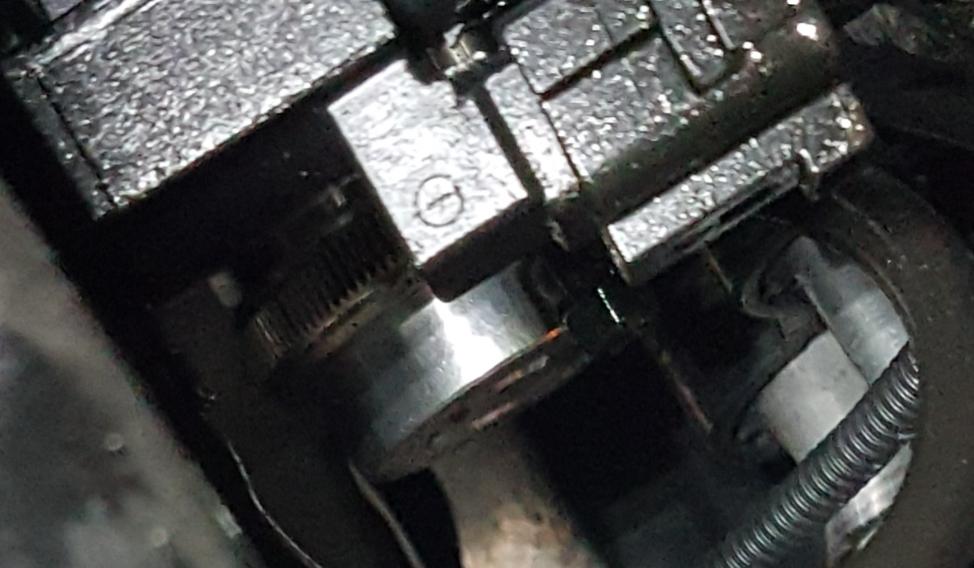

The bad news... I took her for a dyno run to see how she is performing. She made 155bhp and 200ft-lb. Very concerning... They suspected it was a boost leak so I have contacted the dealer and without any fuss he asked me to bring her in for their garage to diagnose. Strange though how its making stock torque but not stock bhp...?
I went to check the DV as I know these are common but I couldn't find it. It seems to have some sort of billet metal contraption installed where the DV should be? With hoses coming off it?
I think it's this because it looks almost identical, it even has the little mount for the solenoid as seen in the install guide on the following page:
http://www.modbargains.com/forge-motorsport-diverter-valve-mk5-mk6-gti-gli.htm
Anyone know what the heck this is, take a look:

You'll see from many posts on here the Diverter Valve (commonly referred to as the DV here) is a weak point on these, so many people replace them as routine maintenance with an updated version. I expect the previous owner went for an uprated one, but that looks like it's covered in oil, so might be a point of weakness.

Didn't Rich confirm it's a forge on another thread?
@r5gtt recently mentioned the forge leaks boost too so that could be the case.
Be interested to see if a new DV (opt for a GFB DV+) will cure the problem.
Yeah he did but I posted this before I created that thread :).
I will let the dealer attempt to find the boost leak and advise how they plan to rectify the issue :).
I'll search now for boost leaks from the Forge DV though, that's worrying.

Yes @lukemk5gti I did and I don't trust the forge or any forge or that matter as they are prone to leak and have serviceable parts where as the GFB DV + does not. Hope that helps.  :smiley:

If I was you I would get rid of the Forge diverter valve and put in a stock item for now to get the boost leak sorted. I went with the Stock DV, and then upgrade the internal parts with GFB DV+ which is a great peace of kit, very well made, it's been installed on my car for 3 years now without a problem. Also look at the PCV valve which is a weak point.

I would like to remove the Forge DV in place for the Rev G DV but will need to spend some time reading the install instructions for the Forge one as it appears to be more complicated than just a plug and play DV. I.e. removal will be more complicated.
