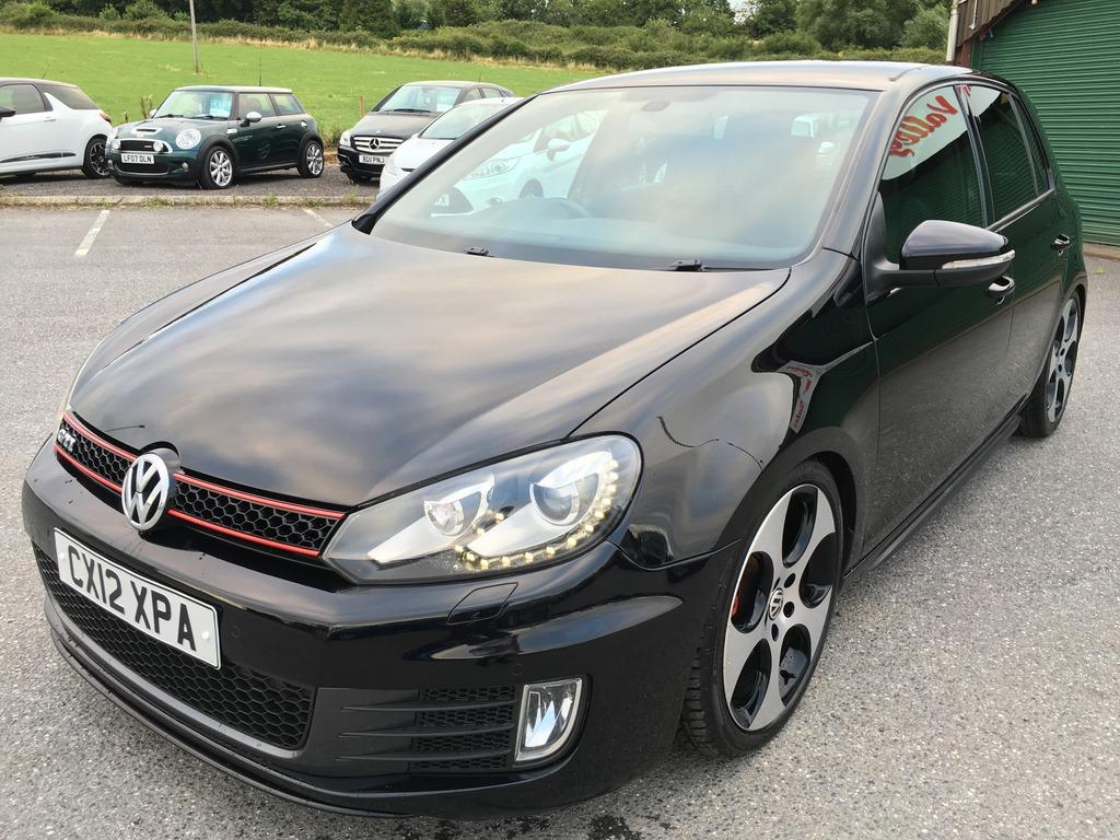

I've had an account for a while now but never really used it. I got my Mk6 golf gti back in March 2015 after looking/wanting one for a while !
Heres how it looked when I picked her up

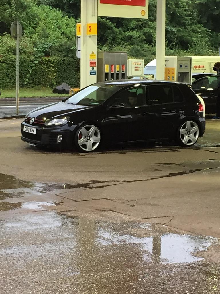

Didn't really do much to it for the first few months. Then I decided to get a stage 1 map which made a very nice difference, along with a full turbo back exhaust, which is a little too loud sometimes but was a bargain. Then I chucked some AP coilovers on her and some bentleys (which are no longer on the car)
I know its not to everyones taste but you can't please everyone

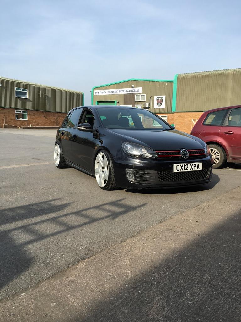

I have recently put some R8 coilpacks and uprated spark plugs in, and last week had the front end resprayed due to aload of stone chips. Apart from that I haven't done a lot for a while as I was considering selling up.

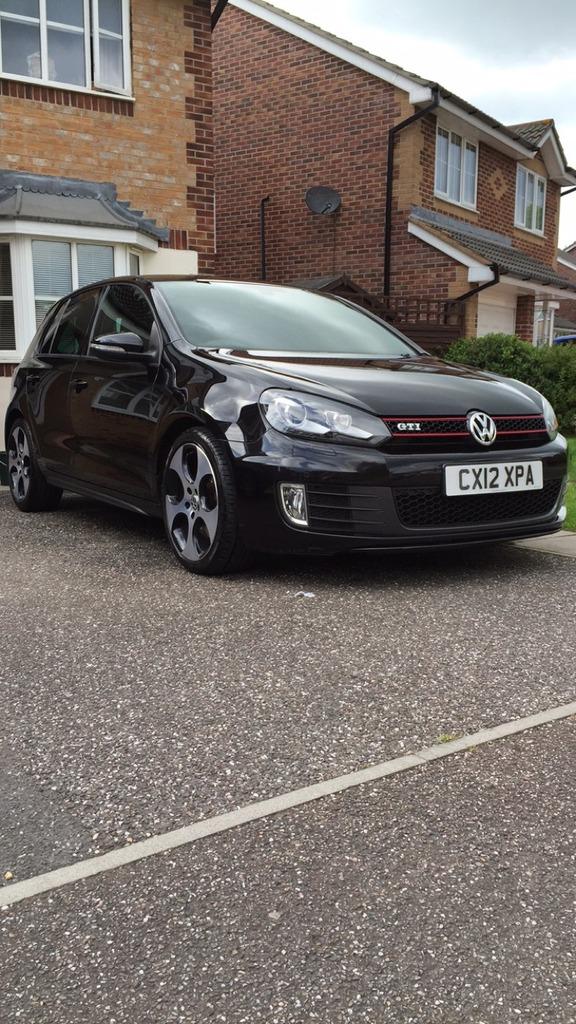

This is how she currently sits
I have changed my mind about selling and now thinking about going stage 2
