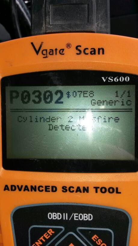

Guess what...... the misfires came back.
This time I did get a code, and the misfire has stayed on cylinder 2. So that rules plugs out in theory.
The more I get these misfires the more I'm starting to recognise a pattern: WOT in 3rd at 2500-3500rpm 'triggers' it. I reckon if I never used full throttle I'd never get this misfire.
Anyway, the misfire seemed to ease somewhat, then I parked up for 5 minutes, tried again, and the misfire was gone.
I'm a bit p*ssed off that it didn't miss a beat with you @Tfsi_Mike. It's all quite perplexing. So, the drama continues. I can at least now rule out both plugs and coils, but I was pretty sure that was the case anyway.

Just a bit more info. In the run up to the misfire, going round bends at say 3000-4000rpm on light throttle it felt like it was just being 'held back' momentarily. Like it'd feel if the brakes were really lightly applied for a second or two.
Also, remembering an earlier post on this thread I attempted 'driving through' the misfires, so pushed to full throttle on boost, and at one point the misfire was quite severe and I heard a metallic clink from the engine that coincided exactly with the misfire. It really didn't sound healthy, so I didn't attempt to drive through the misfires again..
