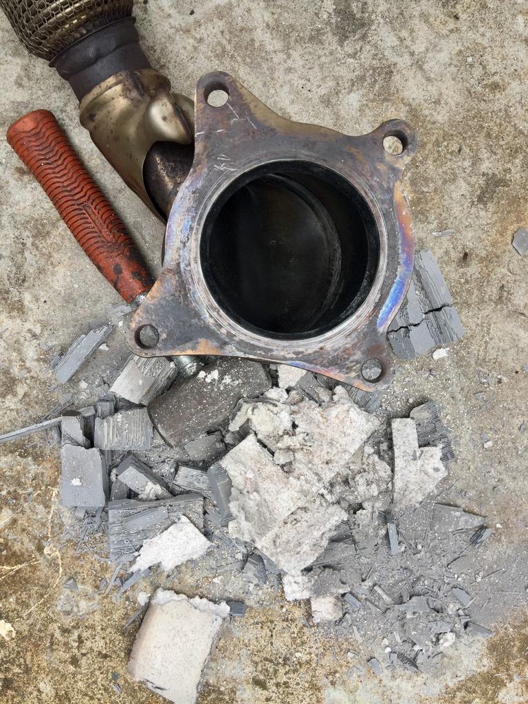

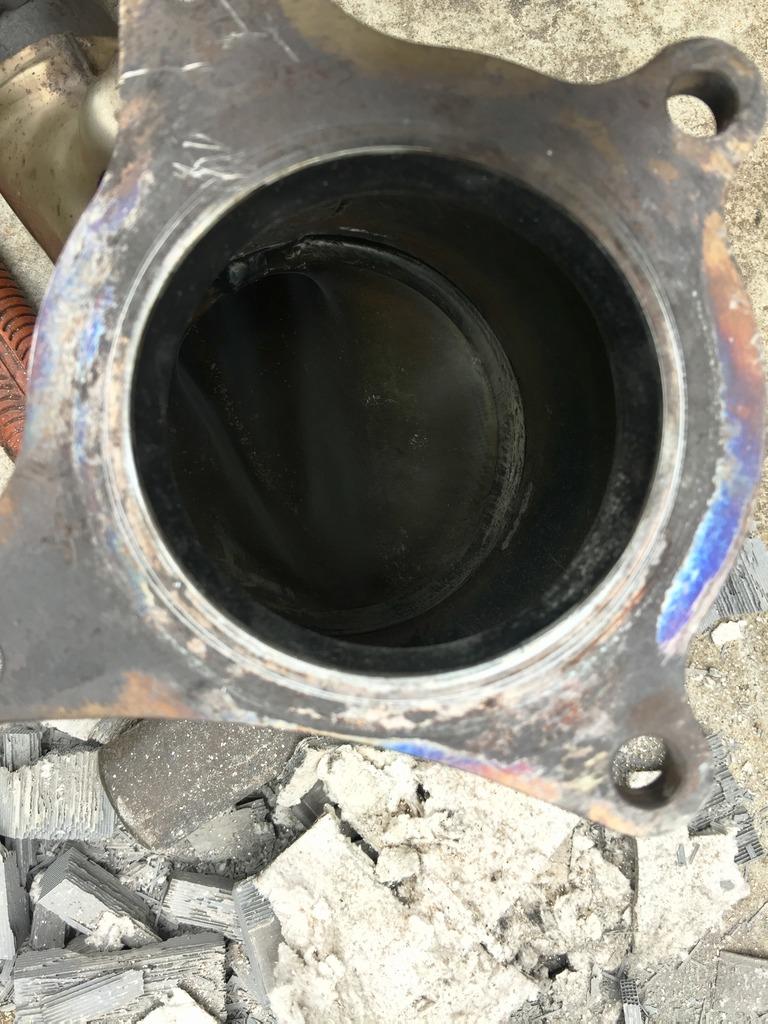

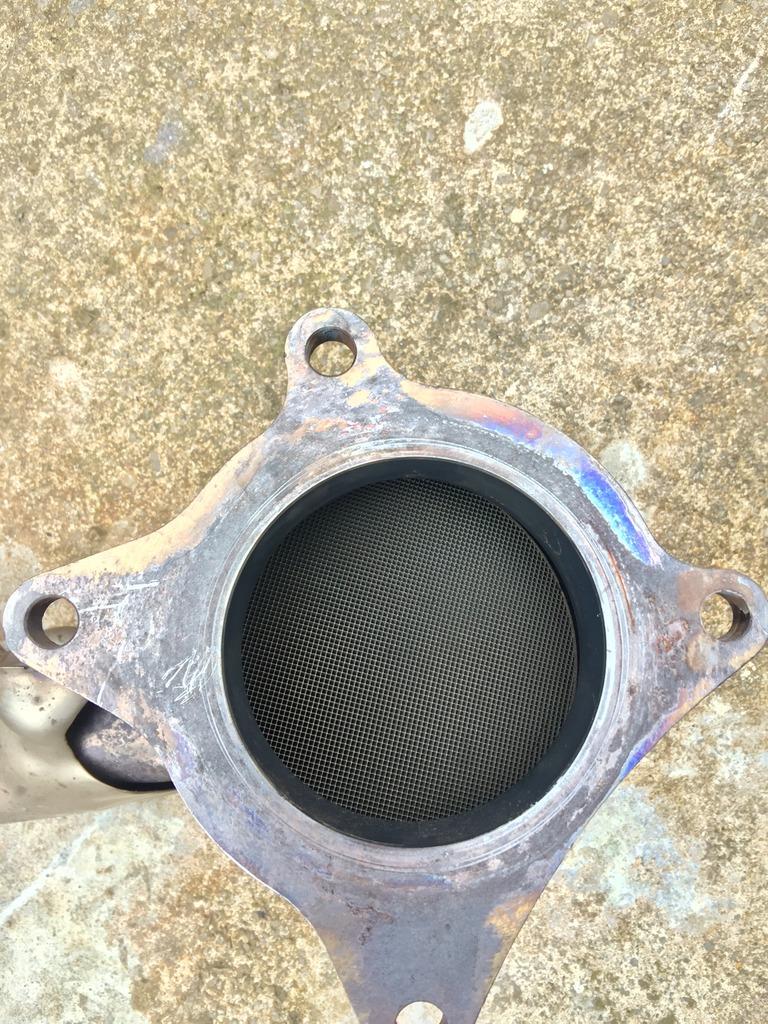

Decided to smash the precat out
Before
During
After
Little more noise and response and dsg makes a bit more of a crack noise than a muffled fart!

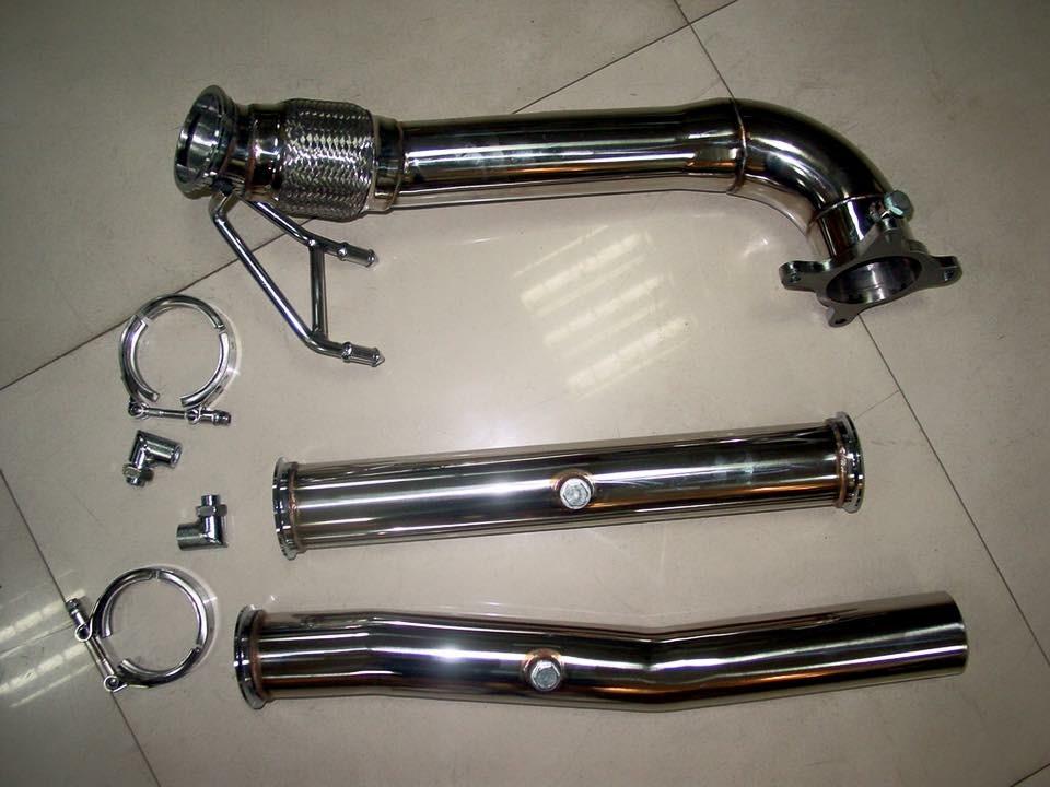

After all that effort tonight I ordered a 3.5" downpipe from Sam Bryant/Relentless tuning.
Makes perfect sense to me as the 3.5" is a port match to the turbo/gasket whereas all the 3" ones are smaller than the turbo outlet!

On the Relentless 3.5" dp. Is it one of the originals or the revised revision? I have one of the early ones fitted and was told that you should fit a poly bush in the dog bone mount. This is due to the flexy being to small and it will cause the hanger to fail.
