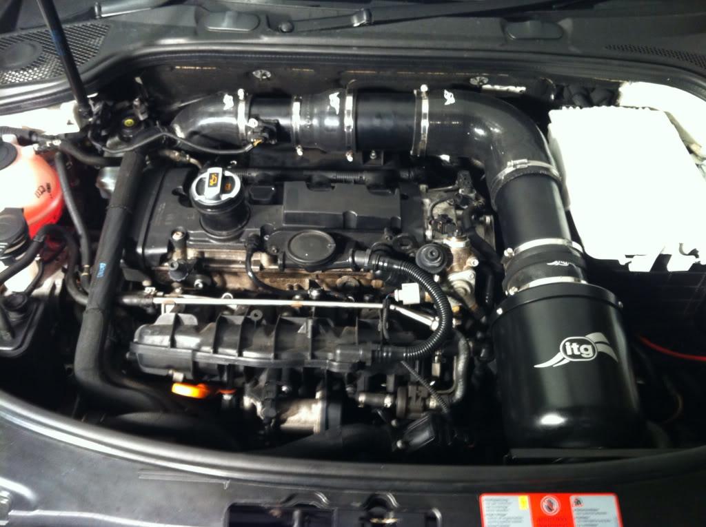

I can't say I am experiencing any negative effects running a Revo Intake, I am a big fan of running the OE Airbox and have done on previous cars but on the Golf R I plan on going beyond Stage 1 and so the Airbox has had to go.
I saw an Audi S3 8P in at R-Tech recently for a Stage 2 Map, Hardware wise it had a Full BCS Turbo Back Exhaust but was running the stock Airbox. It made 317BHP & 332LB/FT.
Another S3, Similar car but Stage 1 with the Pre-Cat removed and running a Revo Intake....330BHP & 338LB/FT.
Niki said that the Hardware was holding the Stage 2 powered car back, It should have been around the 340BHP mark.
I know they are different cars and not all cars perform the same.
If I could have got away with keeping the stock airbox and going Stage 2 or 2+ then I would have but it will become a Major restriction at those levels.

The closed cone intake is also made by ITG but with different pipe work:
Also available with the less jointed pipework too....
http://www.mk5golfgti.co.uk/forum/index.php?topic=98172.0
