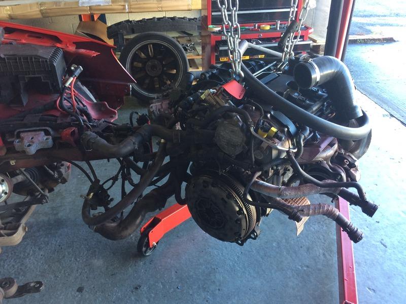

There were a few engine bay jobs that needed doing so planned as many as I could I one day/weekend. It was mainly the gearbox & clutch/flywheel install and new revo engine mounts but after some thinking about how to drop the gearbox out it was just as easy to whip the engine out and do what we needed to.
I had a couple of stripped studs on the turbo manifold that needed sorting and took advantage of the engine being out to install the new front ARB.
Using the crane to lower the engine on the gearbox side didn't really work. I'm glad we gave up on that one now.
It's out! To be honest most of it was already disconnected. I think the only pipe we had to take off was the water and fuel but they were both empty anyway.
I couldn't see a way to disconnect the cables running to the engine from the passenger side so left them connected. It was going back in on the same day anyway.
Gearbox off, quite a small engine to be honest!

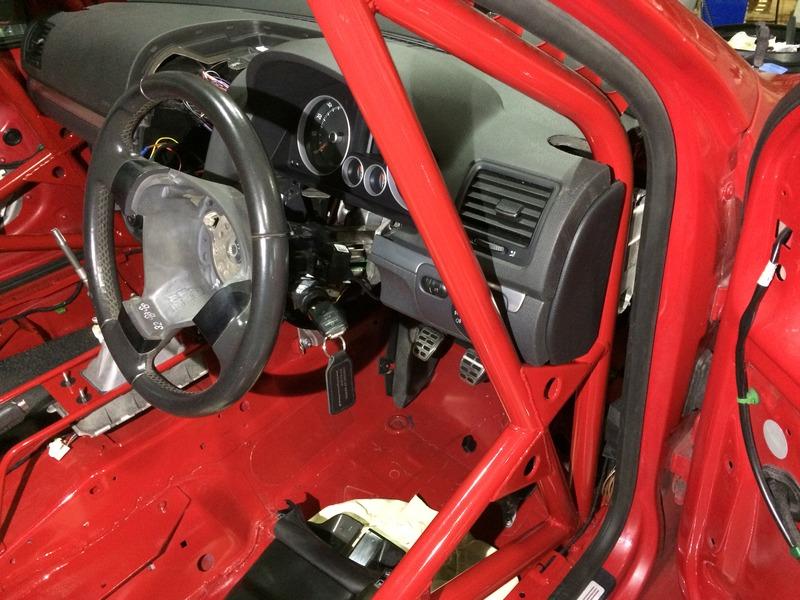

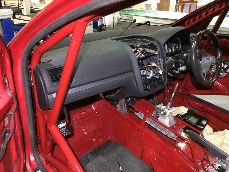

Dashboard back in! I had to cut the plastics around the cage but it worked out well in the end. I would have left them off but some are key to the structure of the dash and some hold switches, for example the headlight switch so it just made sense to put it back in with a few bit's cut off. All in the name of saving weight, right?
You can see the gap i have on the top of the dash for the bar, it's huge but was required to actually get the dash into that position. A small cover plate will be made to hide that later.

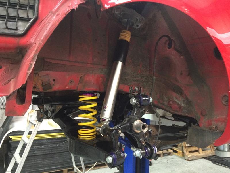

Time to remove the suspension. Being a separate shock/spring on the MK5's makes this job easy.
The only pain is limited room to compress the spring enough. In the end we took a bolt out of the lower arm and just let it hang down so the spring fell out.
Lowering the old beam down
One of the bushes on the old beam. Look past the flaking paint, that happens to most but the actual rubber part was really loose and floppy.
Old & new. It was good to put them next to each other to compare. We had to swap over a couple of small brackets for ABS sensors etc but it was 95% there.
The new one bolted up like a dream, no issues at all.
Lets chuck some new suspension on it. Time to crack open the fancy stuff! KW clubsports which are dampening adjustable via a little purple knob on the bottom of the strut, you can just see it in the picture.
