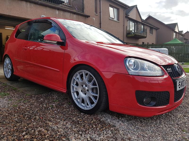

I think my car styling is looking really nice atm but the front of the car is looking a little old with the yellow
halogens and scratched acrylic lenses... so... question to all you guys is this:
What the &^%&% can I do because yesterday I started trawling through the forums and yt and decided to try
baking soda and vinegar...  haha I must say if I needed to get an old car through the mot it would be great for that but... no good
for styling your pride and joy!
I  know I have a few option but I have not had the chance to see some cars with projector headlights up close with headlights in mind.
so ..
option 1:    Do I get a headlight restoration kit/buy new standard headlights  and put some osram cool blue intense/similar.
                 this option seems viable with all these new high end halogen bulbs ( osram nightbreaker laser just out)@
option2:    buy some depo projectors (can't find hella ones anywhere) and use halogens\hid kit without auto adjust, etc
option3:   wait for a good second hand pair of original r32 xenons with balasts and find someone who can sort out 12 pin adapter , modules, wheel sensors. etc.
               so I can have auto adjust and maybe bi xenon?
finally - what is with the black painted inside of these lights? does that really look better ?  to some of the photos i see on google  don't convince me  !
but as I said I have not seen much in person- maybe i should have a look on autotrader and go see some cars nearby.

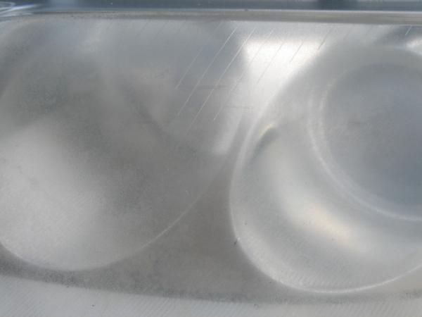

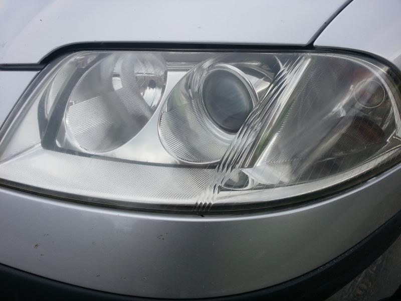

I restored my headlights (on a couple of passats) with wet & dry sandpaper and polish.  I first tried the toothpaste method and all that, and they worked to a degree, but just get some 800, 1500, 2500 grit w&d sandpaper, making sure to keep the lights wet when doing it, starting on the roughest, and finishing with the lightest.  Then polish the living heck out of them.  Then seal them right up, preferably with some UV sealant if you can, but if not, then just regular car sealant will do.
After this, they MAY need done every 12-18 months or so, but it's cheap to do, and not too difficult.
For reference, mine went from this:
To this:
Assuming that's what your problem is of course.
