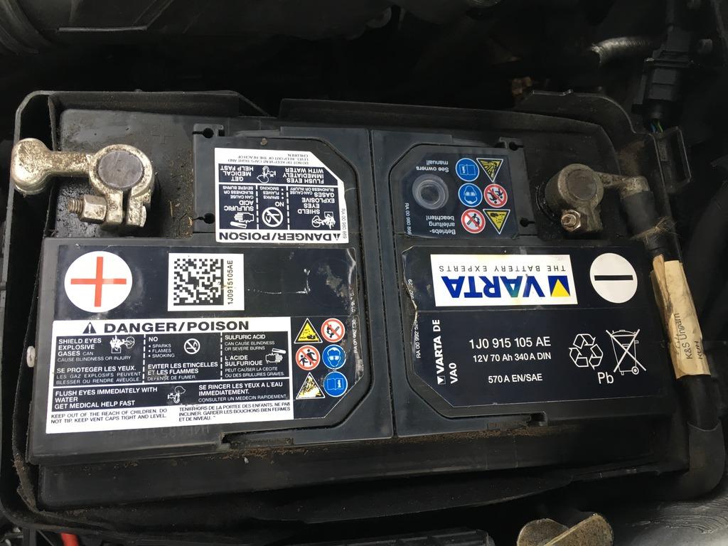

« Reply #7 on: October 20, 2016, 04:46:15 pm »
Just got in & took a pic:
Is this original 2006?? :notworthy:

« Reply #9 on: October 20, 2016, 06:42:25 pm »
That looks like mine, which was the 8 yo original

« Reply #10 on: October 20, 2016, 11:50:59 pm »
That's defo the original battery mate same as mine, I'm gonna buy me a varta e44 before winter kicks in

I'd recommend uprated Varta as above or similar Bosch which I went for. 11 years on original battery is pretty good going!
