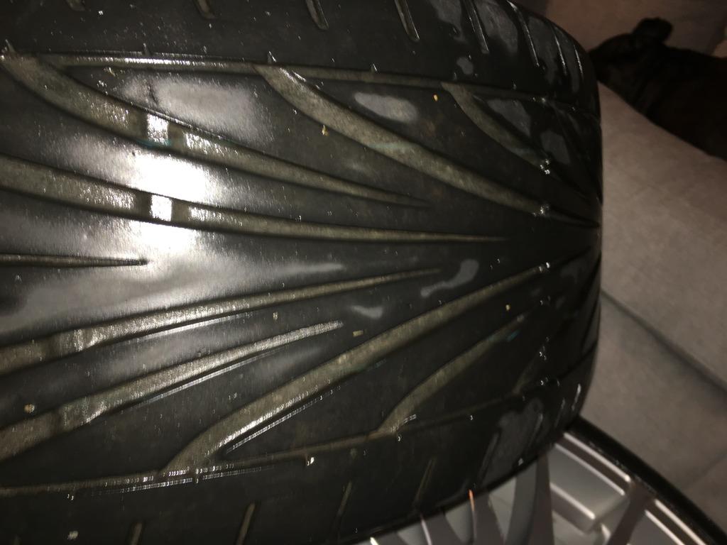

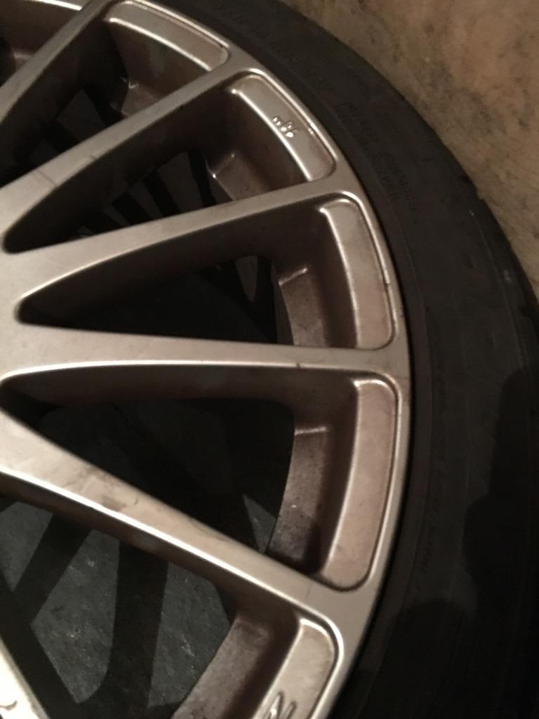

Got them home:
In need of some TLC but all straight, no leaks and only two have a few little marks. If the new one doesn't sell I may stick that on and sell the other cheaper.
Made a start on bringing them up. First a wash and some Wonder wheels treatment:

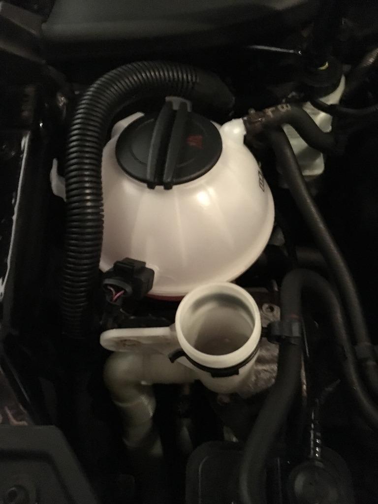

Also made a start on tidying up the engine bay.
Picked up a new coolant expansion tank and a black VW cap (getting the black washer fluid one to match next).
Easy job to do, drained the fluid from old tank into a jug then fitted new one and refilled.
New vs old:
Whilst was out gave it all a clean, before:
After:
Old tank was due to go:
Putting back together:
Sprayed washer pipe bolt:
All back together:

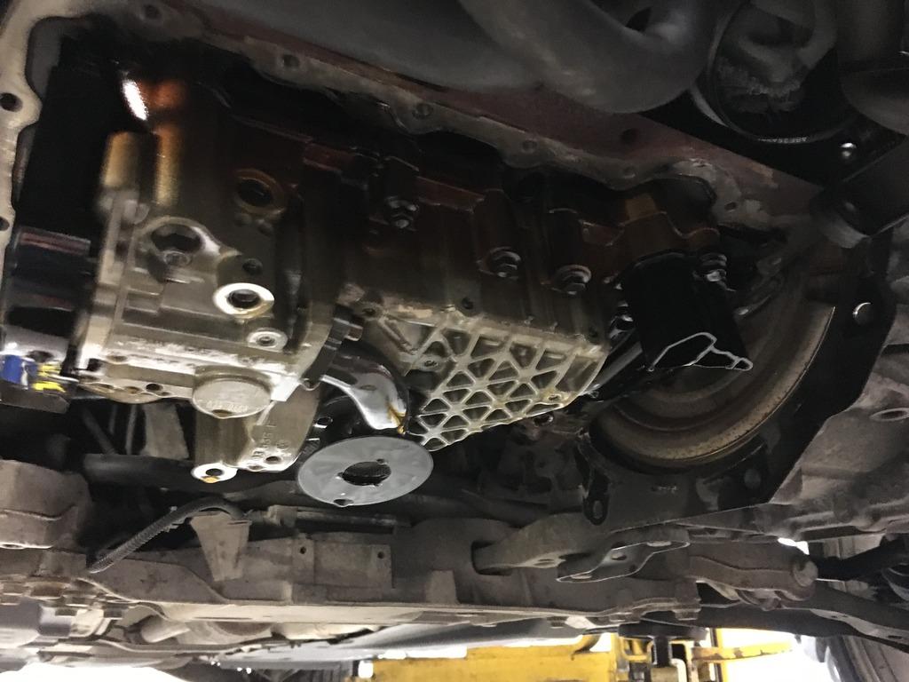

Time to drop the sump now:
All bolts in same ordered:
Sump came of nice and easy (think test runs helped). Oil pick up pipe was in a bit of a mess, plus a lot of debris in it and the bottom of sump:
Washed old pick up pipe out just to see what crude was in there:
New vs old:
Cleaning sump out:
Much better:
Running small bead on new sealant:
All bolts torqued up to factory settings:
Gave everything a little clean under there:
Then whilst the sealant was setting before putting good oil in, started to take the cam chain housing off. Ended up taking fuel pump, battery, turbo heat shield all off so as to make room, plus make sure nice and lined up when refitting.
Once we took the cam chain housing off, one of the seals was broken in the bottom of it, so 100% my issue. At last problem solved!!
New chain and tensioner all perfect:
Removed old seals:
New ones fitted:
All back together:
Plus I can report after 70 miles now no EML light!! Yes. Sorted. So pleased to get done. Plus if anyone else thinking of doing or getting cam chain done replace those seals, only £30
