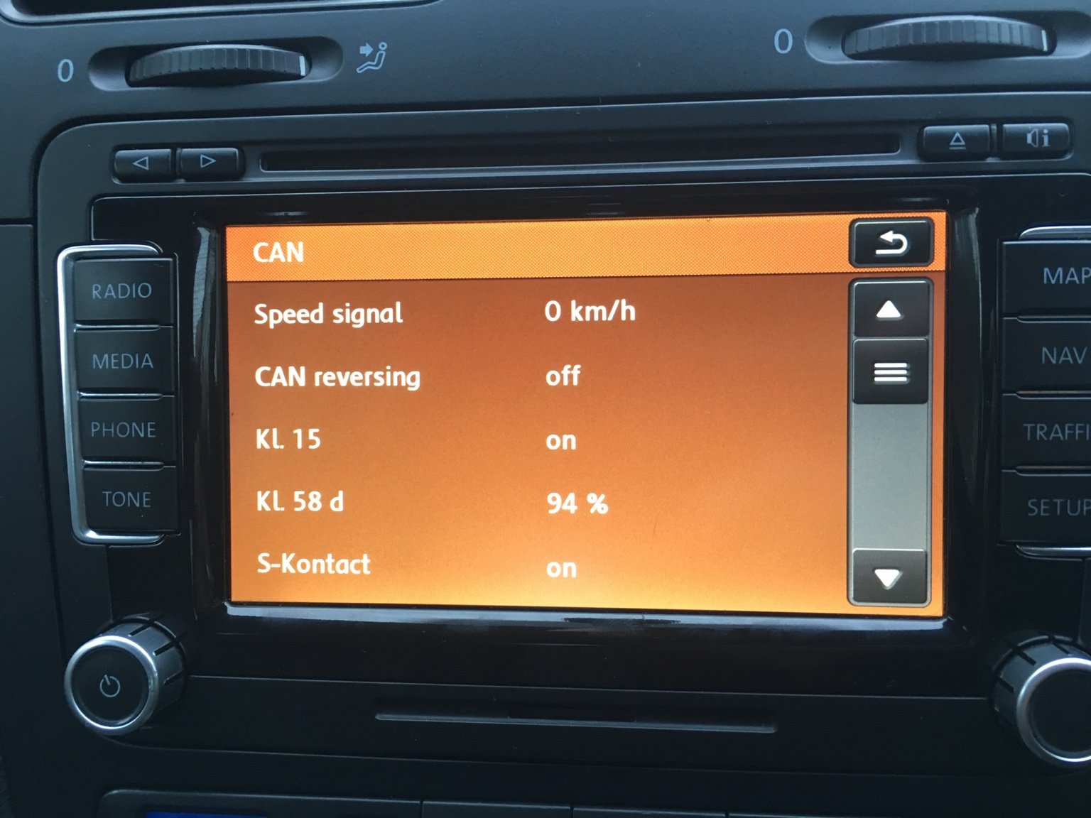

Ive pulled the CAN information from the unit
Speed Signal 0km/h
CAN Reversing off
KL15 on
KL58 d 94%
S-Kontact on
Mute bit off
Analog mute off
Mute Value 0
Do these look ok?

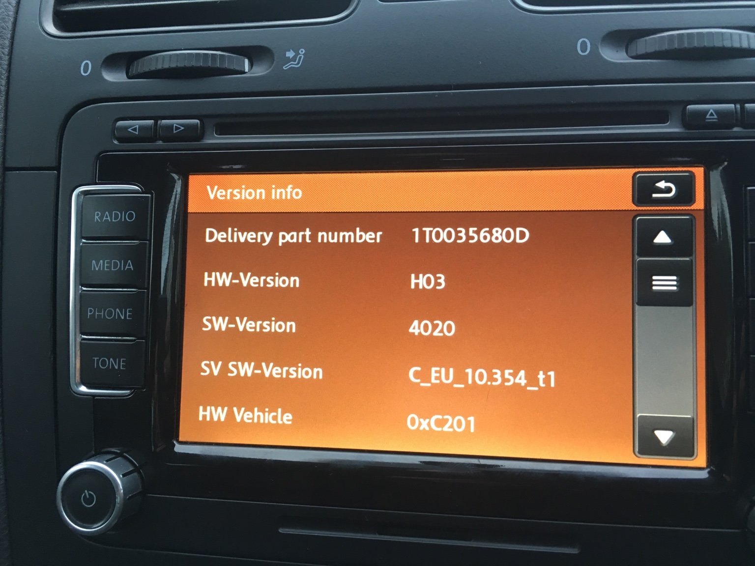

These are the details.
Was told it had to be sent to France...

So now I've been told SW4020 is not compatible with H03 and could cause damage to the LCD board I've been told to downgrade to 3810.

I had a modded 4020 with an H03 unit and an A hardware.
I would revert the firmware to try, but if you go older than 3800 you will repartition the hard drive and lose your maps
I will use 3810 - I think I have D Hardware (1T0035680D) H03 unit...

I bet you have an A unit. When the firmware gets updated, it falsely updates the unit part number you see. It'll be on a sticker on the side, but you would have to remove it. A true D would have a star at the top right.
