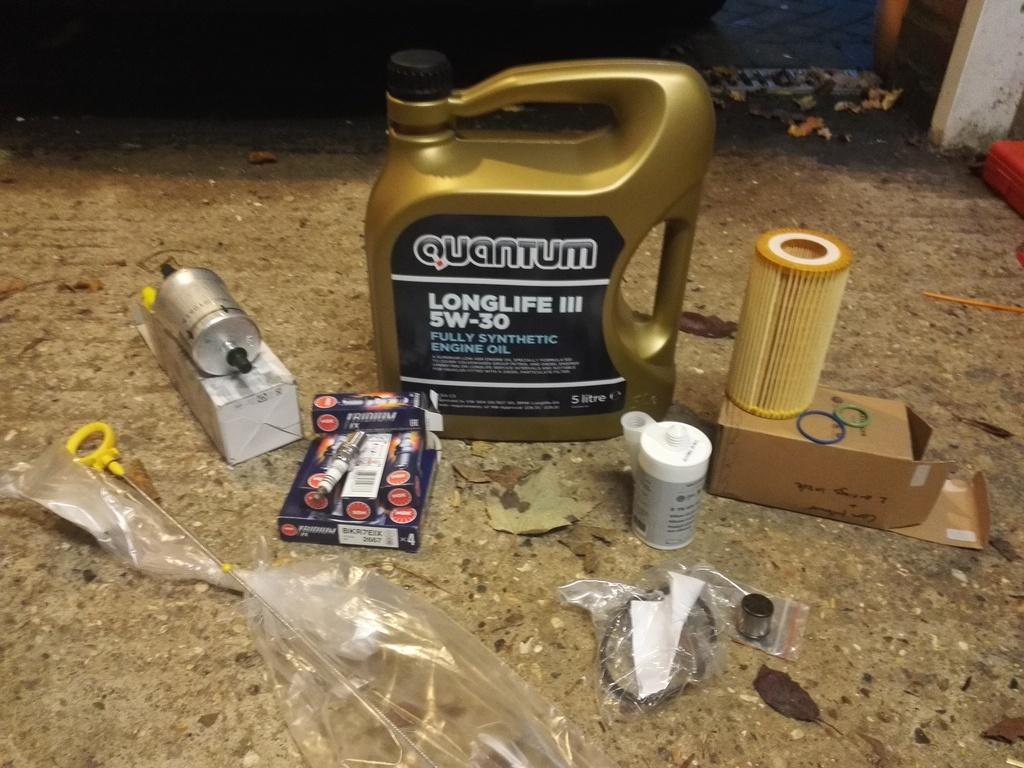

Oil and filter, bought cheap oil to run for 200ish miles before swapping to millers. New fuel filter, NGK-BKR7EIX spark plugs, cam follower, HPFP and pick-up pipe o-rings, sump sealant and a new dipstick as the little orange ball about half way had disappeared from the disptick... I was reunited with it later on.

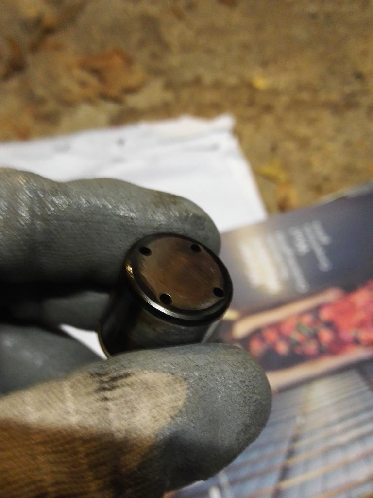

The old follower was pretty beat up, looks like its never been changed. Cam lobe looks and feels OK through the cam chain cover though. Hopefully its a Rev B inlet camshaft with the tougher two-piece lobe. I know some BWA engines come with Rev A inlet. I wont know untill i either do the cam chain at some point, or could take the vacuum pump out and have a look.

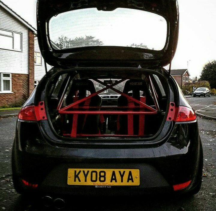

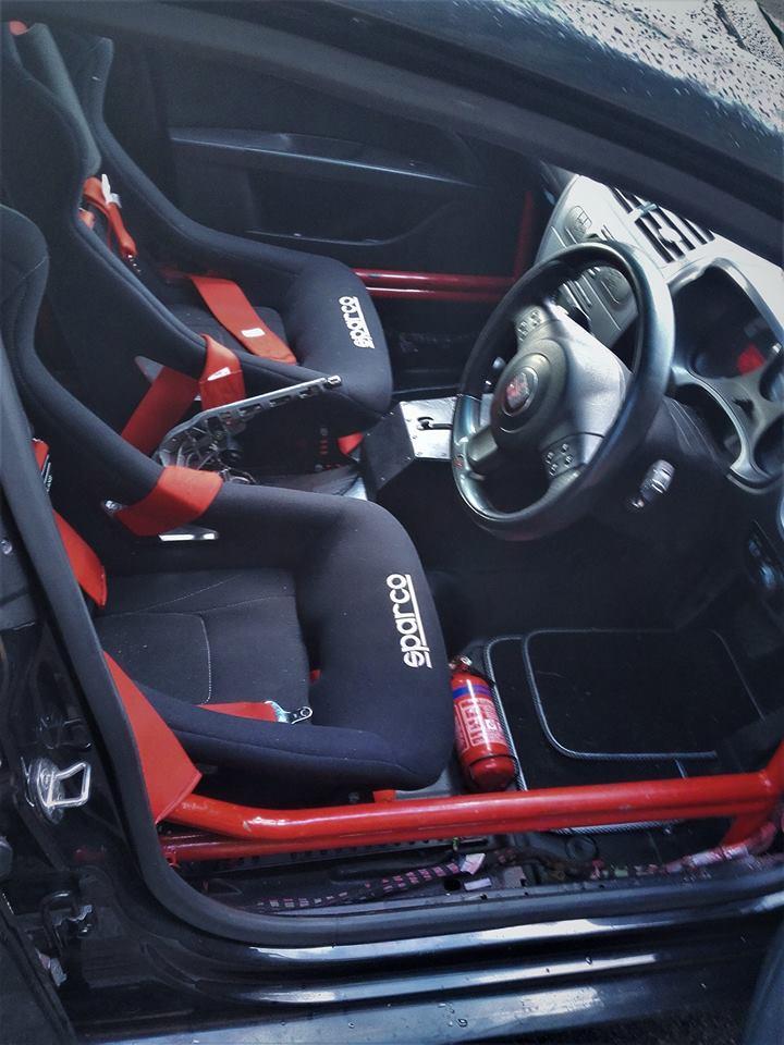

Mike - here are some pictures - I don't have many mate! I think you may have already seen them on the fb group? Although, the cage itself is coming out unfortunately. I'm not confident in the welds, the bends in the tubes + seeing as I drive it on the roads a bit as well I think its for the best. For now, a harness bar will be going in so I can still run bucket seats & harnesses. Although long term plan is a welded rear only half cage when funds allow.
