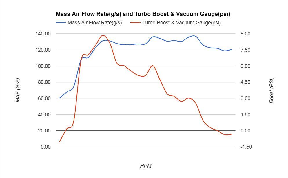

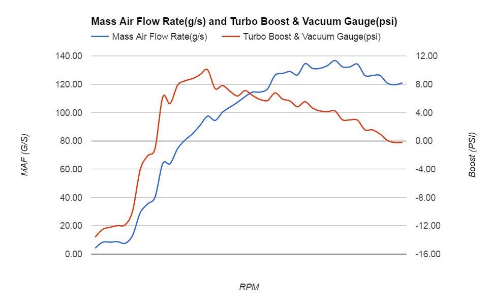

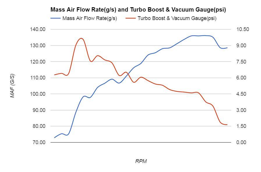

I originally bought Torque to diagnose a misfire (turned out to be a coil pack) but whilst messing around I noticed the MAF readings were waaay over what they should be according to what I read on here...turns out that was because the MAF sensor units in Torque were set to CFM rather than g/sec ( :congrats:) but I had also noticed peak boost seemed to be on the low side.
I've done a few 3rd gear pulls using Torque and here are the graphs, for some reason Google docs doesn't display RPM along the horizontal axis but they were done from approx 2krpm until 6krpm.
My initial thoughts are that the boost looks a bit lumpy, isn't peaking as high as it should and trails off faster than it should at high RPM? Equally I wasn't sure if an under reading MAF would make the ECU deliver less boost to protect the engine?
Please help, I just want have my car running as it should.
Run 1
Max boost: 9.5psi
Max MAF: 136 g/sec
Run 2
Max boost: 10psi
Max MAF: 134 g/sec
Max boost: 8.8psi
Max MAF: 136 g/sec

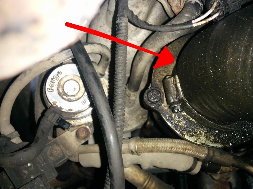

Don't know how to interpret the graphs but could it be a boost leak? Looking at your previous post have you removed the boost tap? Also looks like the outlet jubilee clip might not actually be on the hose?
Looking now there is a a fair amount of oil below so don't think the clip is on the hose

Bloody well spotted with that hose, I took some other photos that day so I'll have a look and see if there's a better angle.

Checked that hose at the weekend and it was solid, was just a funny angle/camera flash which did it.

Torque is terrible for accurate logging, find someone with VCDS or get yourself a £20 clone and use it yourself
Looking at your logs , boost is tailing off far more than it should be.... You should be holding at least 4 or 6 psi of boost at the redline, not tailing off to nothing, which also explains the low peak MAF figures..... VCDS logging will tell you whether a significant leak is causing this (real time lambda correction) aswell as comparing with the specified boost and N75 control to understand what the ECU is trying to achieve.
Torque can show you the real time fuel trims as well as the long term multiplicative figure which can indicate whether you have a significant leak. My money is on the actuator.
