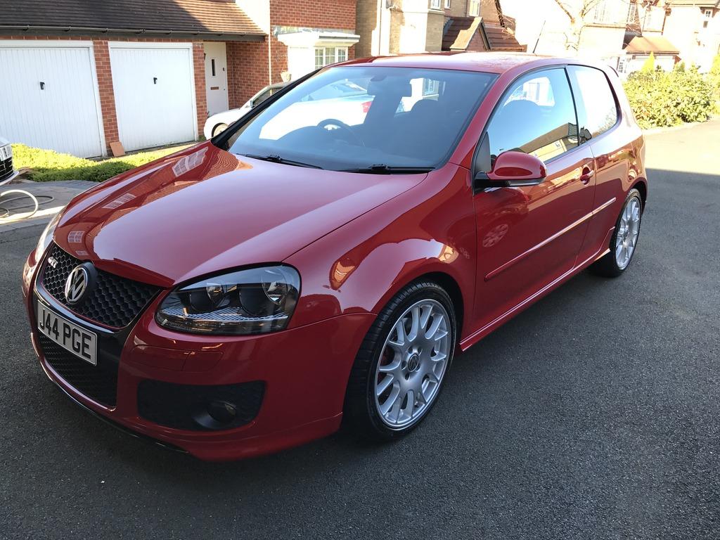

Heres a quick pic of the paint on the bonnet before we started,
We thought a 50/50 on the bonnet would be a good place to start to see if the haze would be removed by the compound or whether we would have to get something more coarse,
The above was after the cutting stage,we continued to do the rest of the bonnet and go over with the polishing compound the difference was unreal!
we then carried on around the car and the difference from when we started were night and day
To seal the paint we used Gyoen Paint sealent which will have around 6-12 months protection.

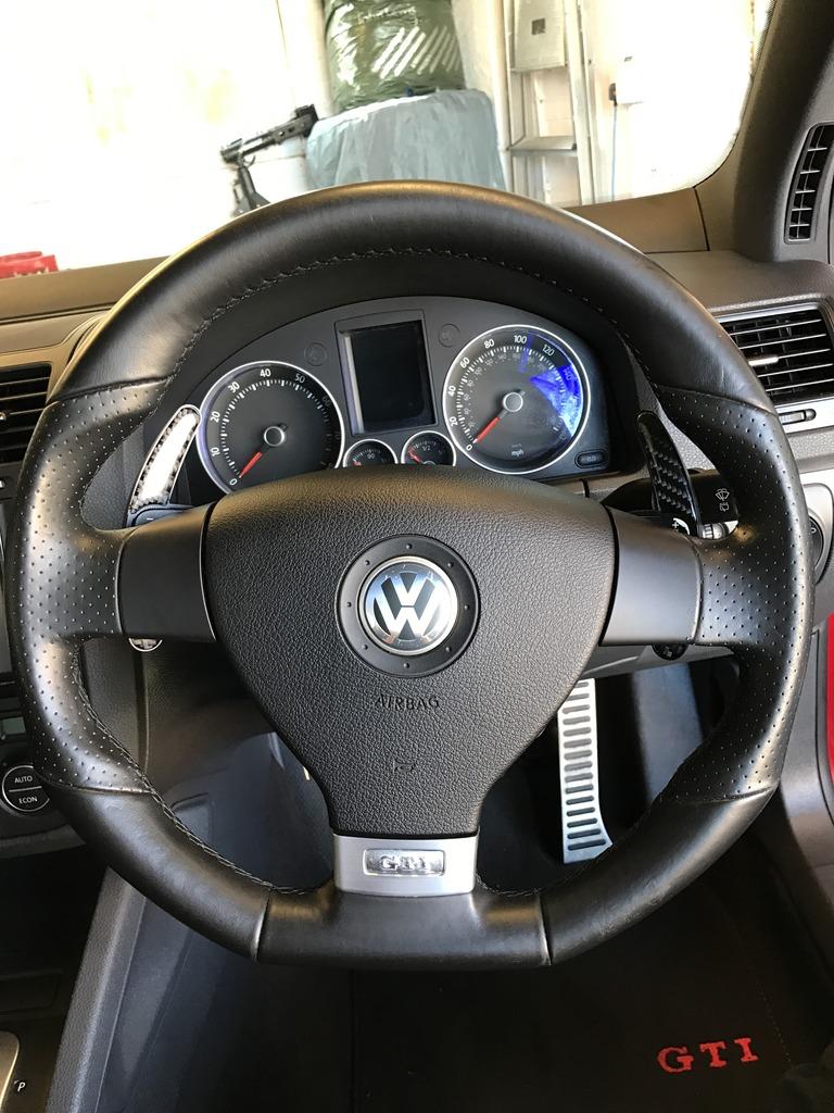

My friend then saw the steering wheel and was disgusted, said it was far to shiny and needs some attention, he grabbed some g-tehnique cleaner and a new white micro to see what came off it,
after around 5 - 10 minutes of cleaning it came out like this
it now has a nice matt finish again and looks 10 times better than the shiny plastic look prior.

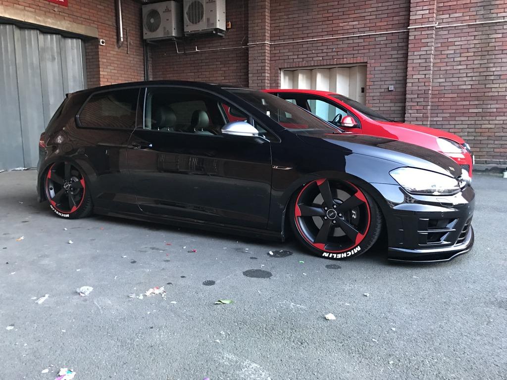

I then went to meet another friend who has a rather modified mk7 R, still rolling his genuine RS3 limitied edition wheels on Accuair Elevel air ride with a boot build installation completed by plush automotive!! :o
I am massively impressed with how the car came out and happy we managed to remove 99% of the swirls, obviously theirs still bits i want sorting after putting it next to the lads's mk7 R's but for 11 years old it hasn't come up bad at all!

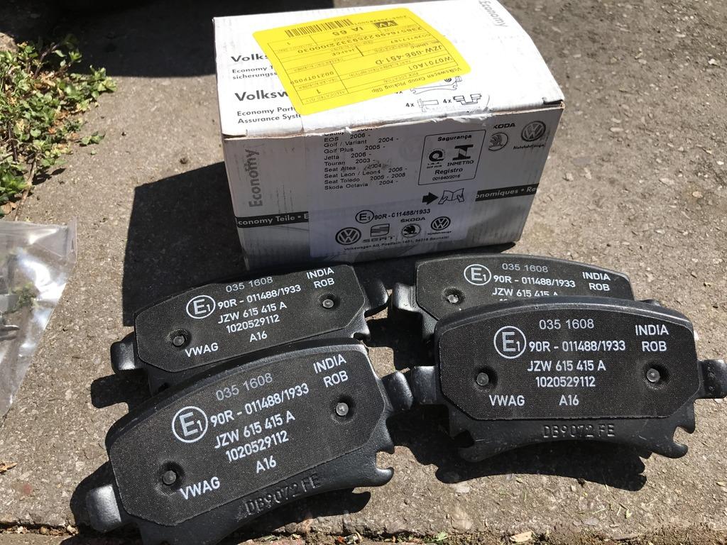

For a while now the rear disks and pads have bothered me,they have always looked really rusty and well worn so decided for how much they were id get my brother to pick me some up when at work.
I went for just the standard oem solid disks and oem pads

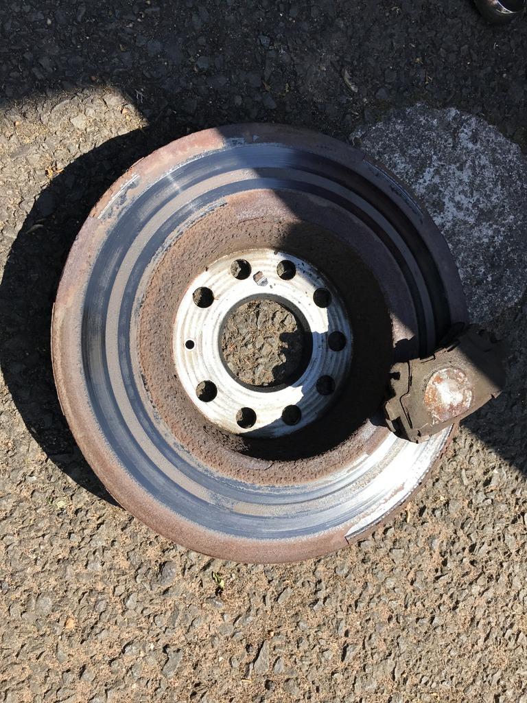

We started on the drivers side, after inspection they didn't look overly bad but changed them for the new parts anyway.
Then the passenger side..... deary me we had to do a double take to make sure it was the same car, extremely warn and hardly anything left on the pad, the disk had grooves, a big lip and looked in a real bad way. once we got the carrier off and whipped the pads out it appeared the seal on the piston had came out.
We doctored it the best we could and ended having to wind the piston back in using the breaker bar due to how far it had come out.

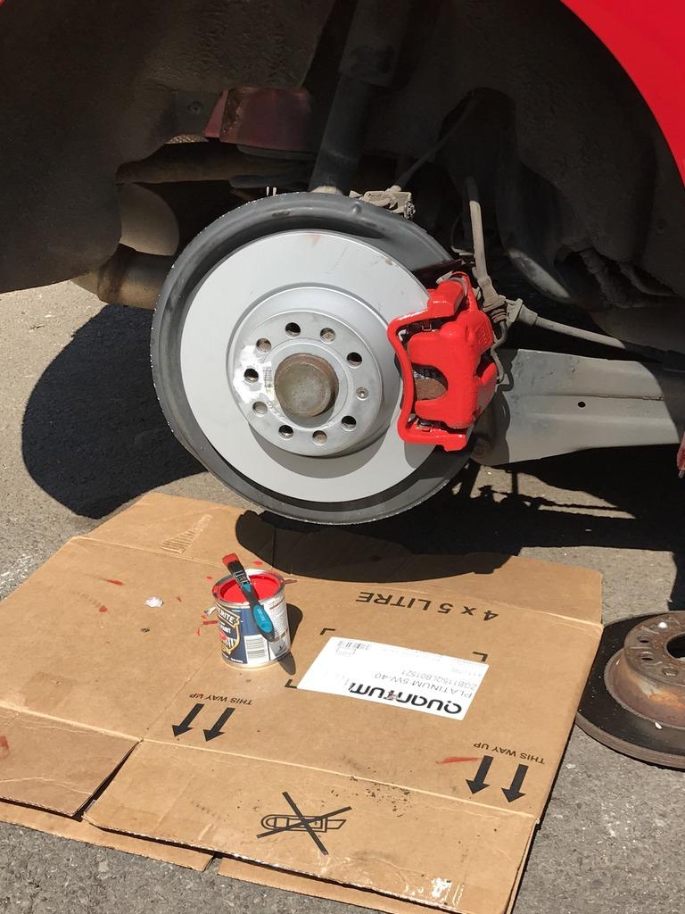

I then decided after looking at the calipers they could also do with a freshen up, I popped down the local hardware shop and picked up some red hammerite.
I know for proper job these should be properly stripped down etc but for a quick freshen up they dont look to bad at all.
The next day my brother had to borrow my car to get to work as his integra was in for a new timing chain, he rings me saying hes had to pull over as he could smell burning and surprise surprise it was coming from that passenger side caliper, it had seized on and as expected got extremely hot.
When he got to work he mentioned it to one of the techs and fair play to him he got it in the work shop on his dinner break and fitted me a new one but unfortunately it was a silver one as this was a bit cheaper.
so yes the day after having already done all 4 calipers it was back up in the air as I needed to paint this one.
Breaks are now great and handbrake is a lot better!

That mk7 is nuts! Like the red lip on the audi rotor wheels.

Hes currently changed those LTD edition RS3 wheels for some Scirocco VWR ones and omg slightly jealous  :grin: not bad for his 'winter wheels' are they haaa

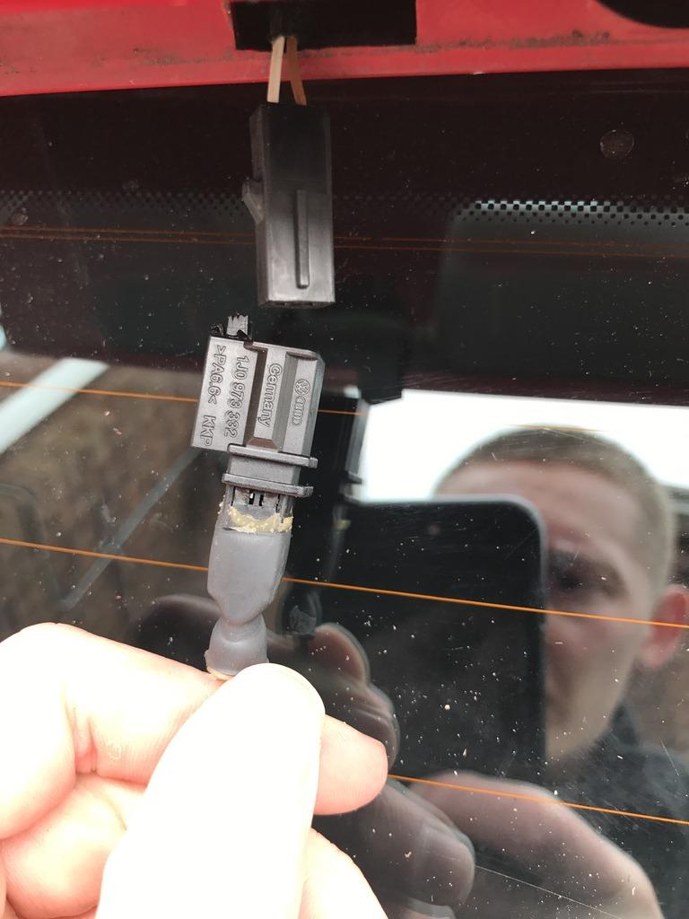

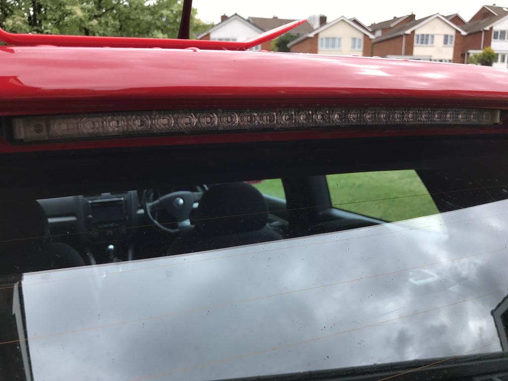

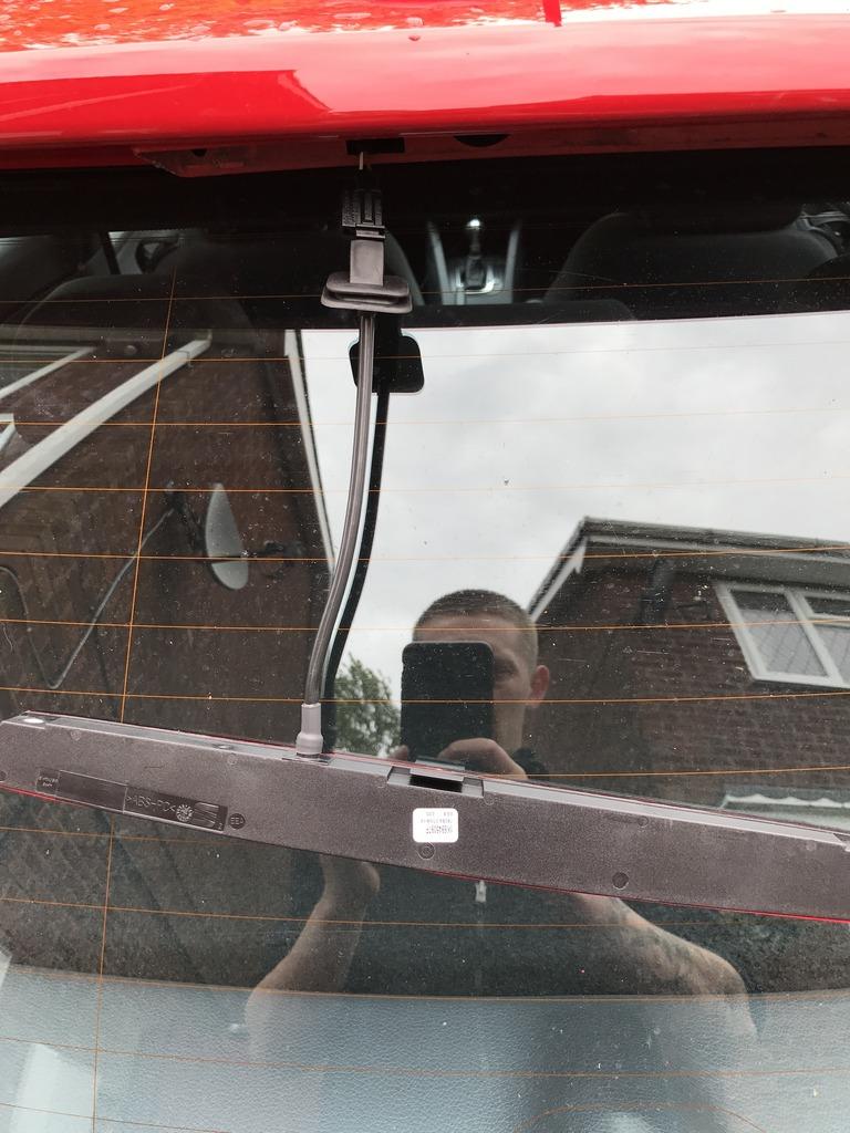

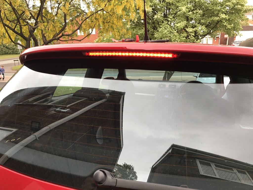

A few weeks ago my friend called me whilst we were in traffic and asked if I had my brakes on because my center brake light was near enough non-visible in daylight.
After searching through the forum I saw it was a common problem on the Mk5's and found a couple of how to guides so thought why not give it a go!
Same again my brother comes into it and picks me up a genuine light clusters from work, this was around the £35 mark.
Tools used:
- Small Flat Head Screw Driver
- Plastic Trim Tools (amazon)

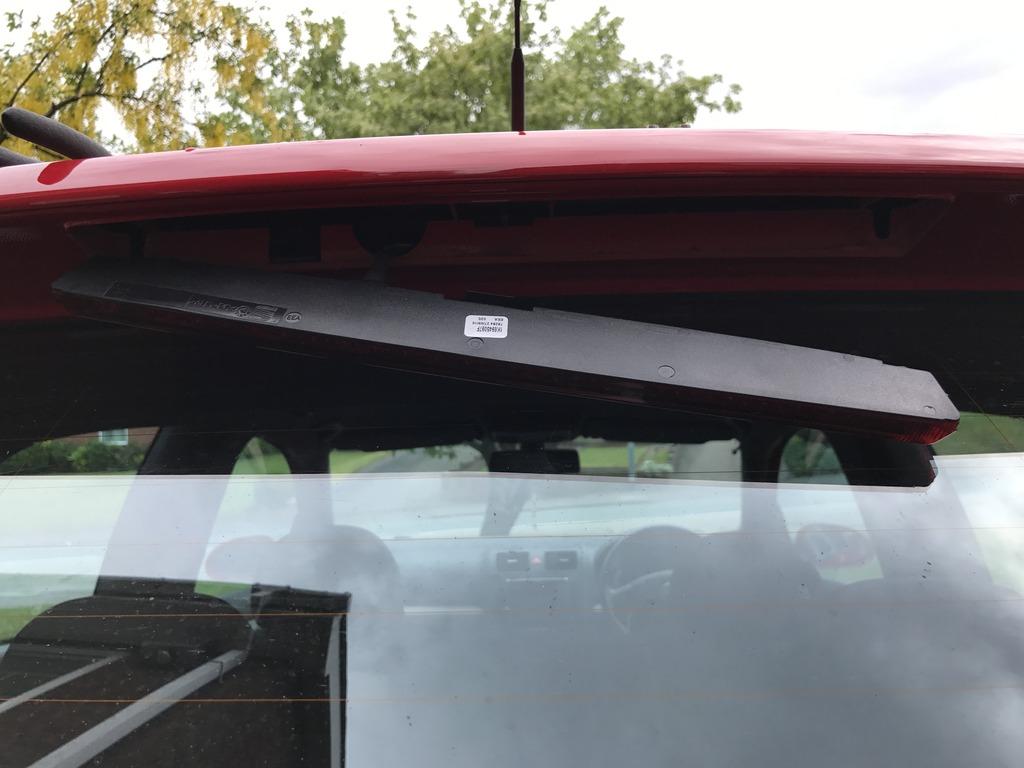

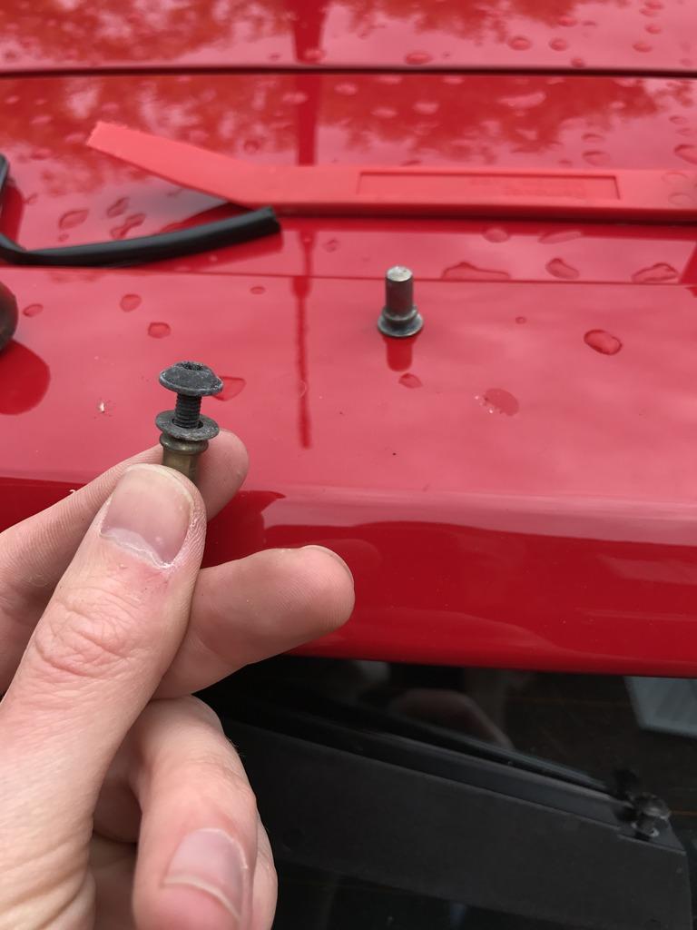

First of all I looked around the brake light cluster and on the left hand side the paint looked slightly disturbed as if someone fancied a go previously, I thought this would be a good place to start to save disturbing the other side.
- I used a flat head screw driver as the trim tools didn't seem sturdy enough to initiate the break of the lense.

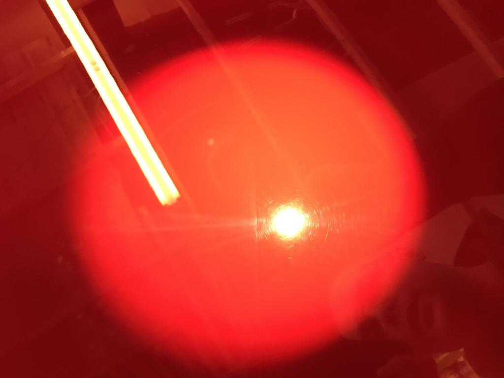

Quick picture of the first piece of lense broken, you can see by the disturbed paint where I started on the left hand side
- I then proceeded to remove the rest of the red lense using a trim tool,there is no nice way of doing this so you will hear some funny noises (As stated in the link be aware of pieces of plastic  as they have a tendensy to ping off in all direction)
- Once all the lense has been removed you will be presented with the led light cluster
- I then used a trim tool to pry the led strip out (there's x2 small wires going to the rear of the led strip,I just pulled these off as they were no long required)
- I then followed the guide to removing the black casing, this is held on by x2 retaining clip on each side and takes abit of prying from different areas.
- Once pried out the retaining clips stay in place and can be unhooked as they are also no longer needed

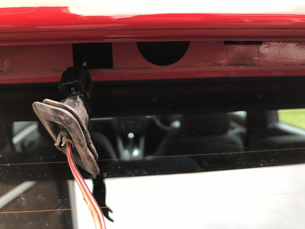

- The old light cluster will now be hanging as its still connected by a connector in the spoiler.
- If you follow the wire into the spoiler you will see the wire goes into a rubber grommet, I used a flat head screw driver to pry the grommet out, gently pull the grommet out of the spoiler and the connector will follow.

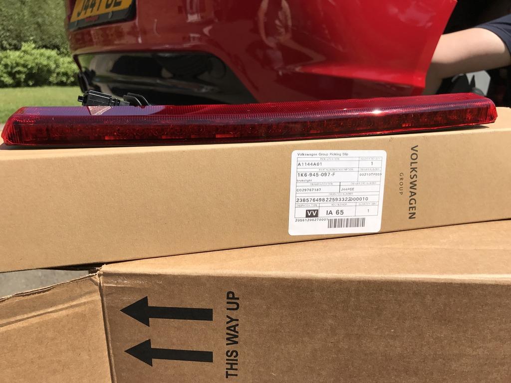

- You then need to disconnect the old light cluster (self explanatory the little block move to the side and then releases the car hard wiring).

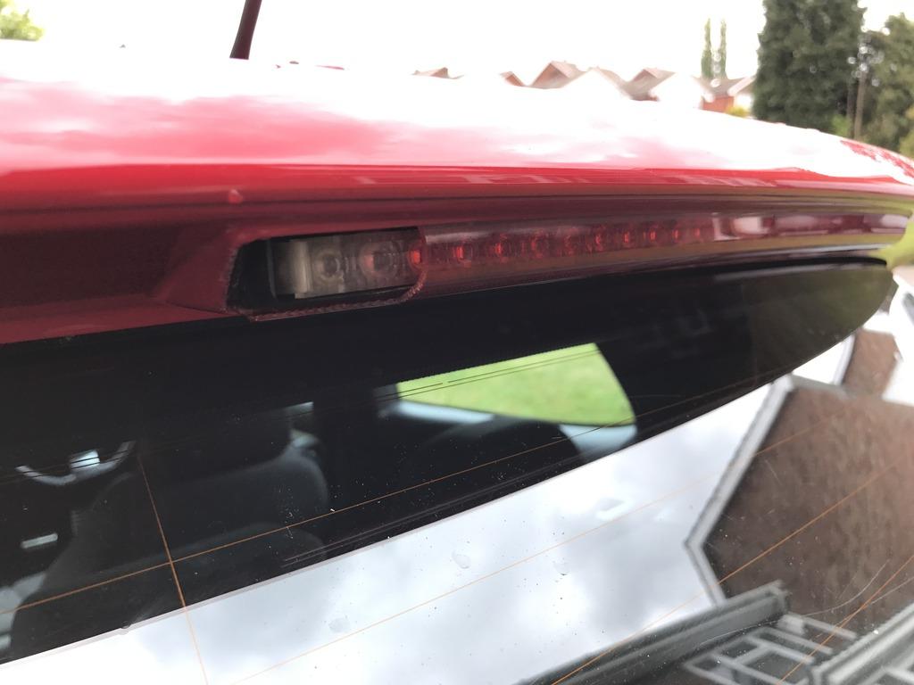

This is now the old light cluster removed and now a case of reversing the last few steps;
- Connect the new light into the wiring of the car.
- Push the rubber grommet back in and feed any excess wire back into the spoiler.
- You now have the choice on whether to put some silicone of some sort on the light to hold it in however Ive just used the clips and it seems more than sturdy.
Then the finished article.
