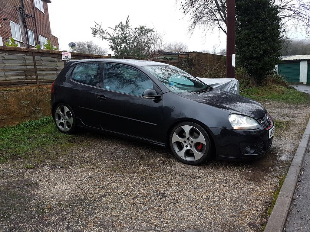

So I finally got my car lowered yesterday - bought Eibach Sportlines as I loved the fact that they look so subtle... however, mine do not. I feel like I've inadvertently turned my pride and joy into a chav-mobile.
Why has this happened?!
My car standard:

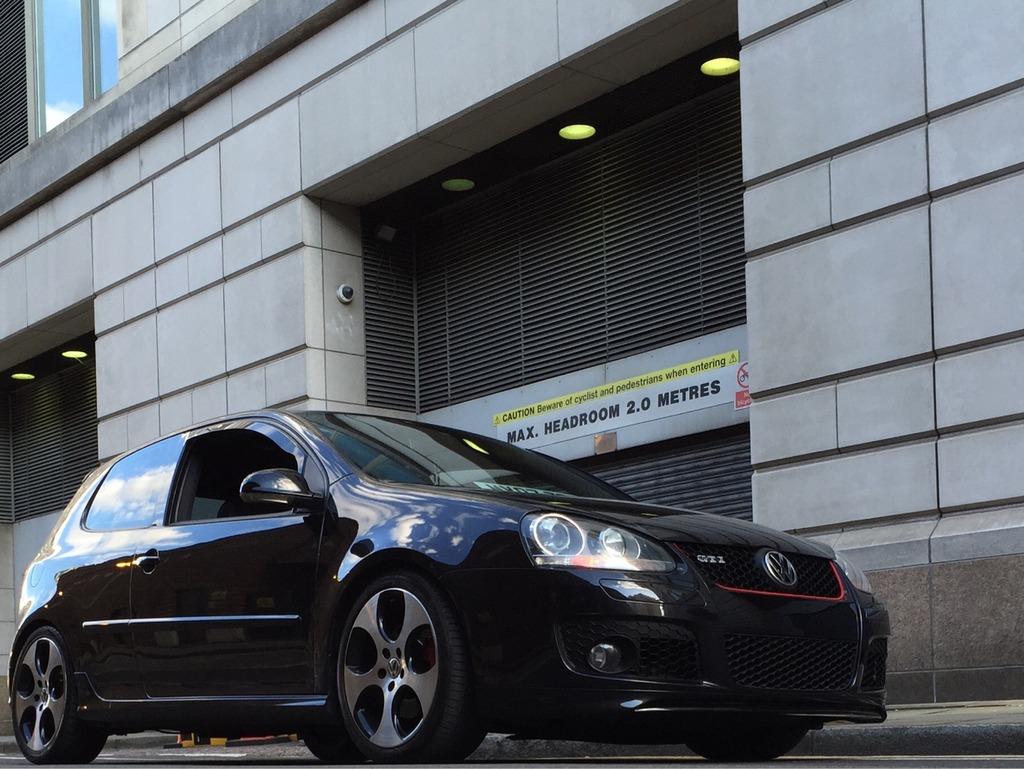

What I was aiming for (the beautiful beast belonging to MIJ_JAGGER):

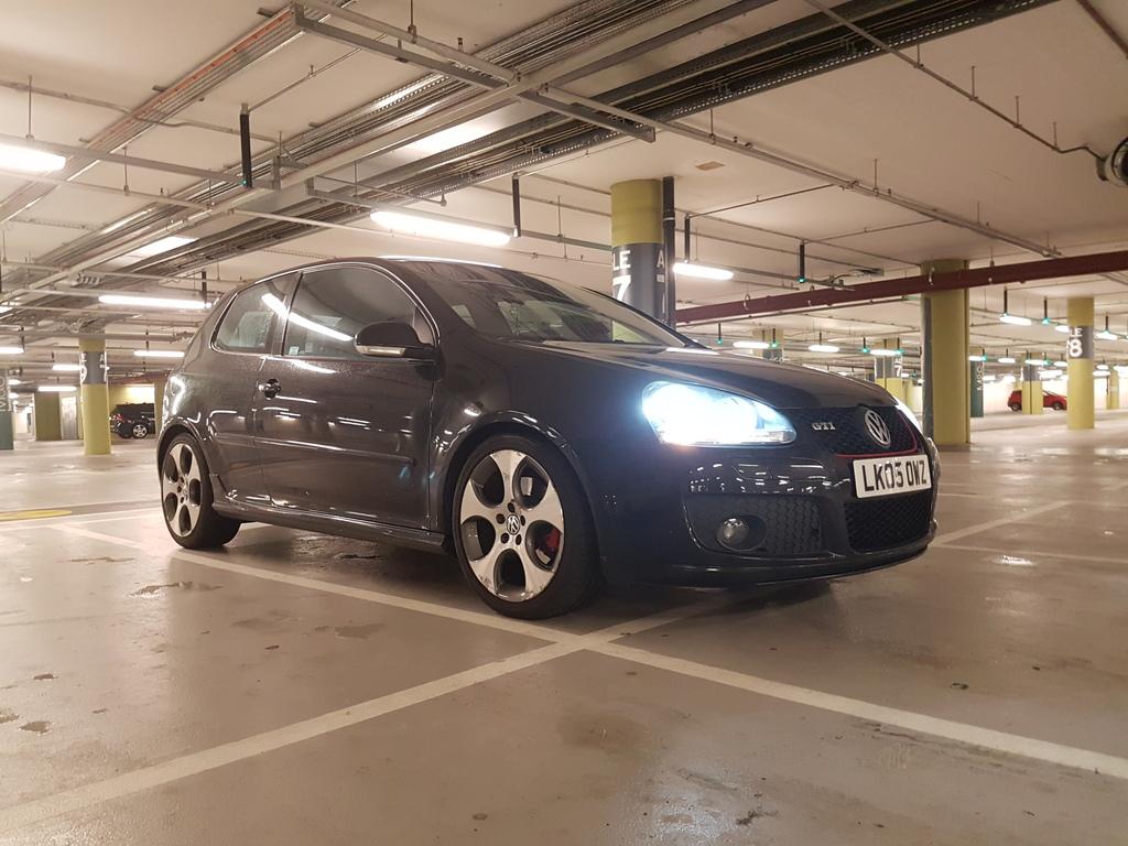

What I got:
I am clueless (hence why it's taken me this long to do anything major to my car) and now this happens! How come? I've never seen Eibach Sportlines so low  :sad1:

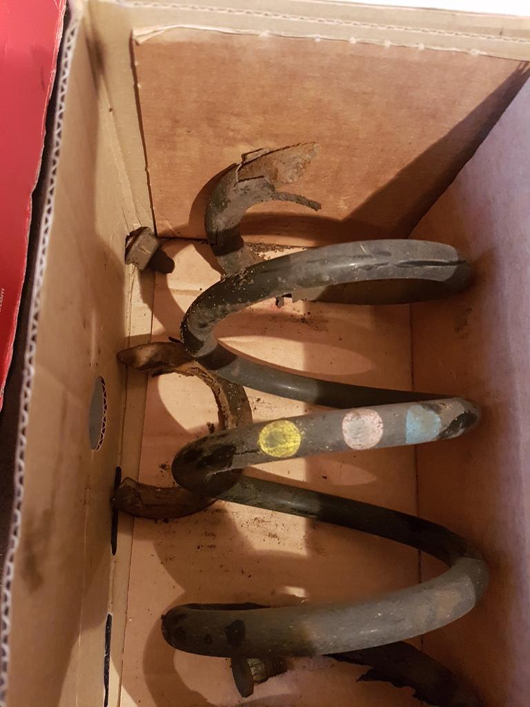

In case it might make any difference, my nsf damper was found to be not fully fitted into the hub, causing a difference of 1.5 inches between the left and right (which can only have happened 5+ years ago when I had a crappy company change the front suspension arm coz it was bent) and this had caused the nsr spring to snap which I hadn't even noticed!  :surprised: I know, I feel sorry for my car too  :sad1:

Imho I would say the two lowered photos look the same although the photo angle and all black (car/arches/tyres) doesn't help with judgement from a photo.
Bit shocking about the spring  :scared:

Measure from the floor to the arch, when the car is on level ground.

no two cars will ever lower exactly the same height.  a car with newer shocks might not go down as low as a car with older worn shocks for example. or even other way round. it is sort of a lottery of what you get with lowering springs and your specific circumstances

I'll measure mine when I can  from floor to arch and you can compare if you want?
I really think they look fine. As mentioned, give them a while

Rear springs snapping on these cars is very common.  Both of mine went and I didn't notice!
Not fitting the front damper into the bearing housing fully isn't great though, and dangerous!  Not sure how they even managed that.  Probably didn't have the correct spreader tool and just whacked the strut in as far as they could get it.  Bodgers!

Have you measured floor to arch like Rich suggested? It'd be worthwhile. If it's miles out we'll be able to tell you and you can investigate why. I wouldn't mind knowing anyway, just to compare with my H&R springs.

Just been out - fronts are bang on 2ft, rear 1inch higher.
