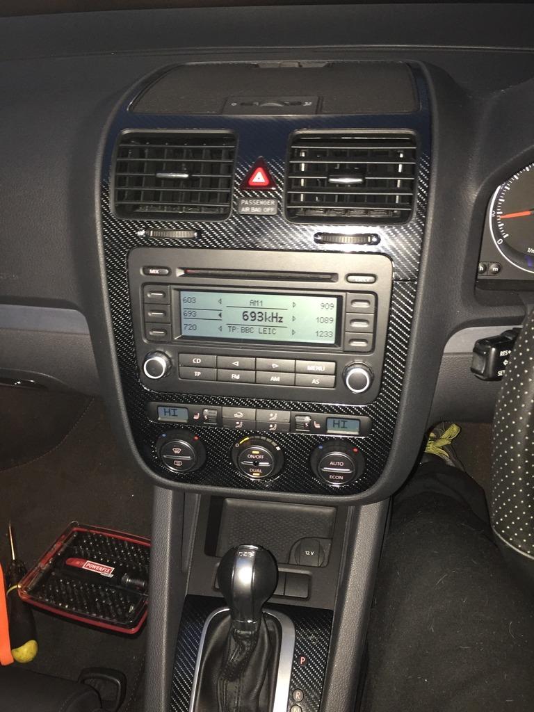

Thanks for the reply bud, this is mine below, I believe the mfd2 has sat nav which is what I'd like, I can't afford the new ones which I'd love to get but I can hopefully get this one for £50px.
I just wasn't sure if we could just swap the head unit and that's it, he's selling his car so thought I'd ask and he said yes if I take it out and obviously put mine in his.

I'm not sure if it'd need coding in (or further physical work) to get it all working properly with the nav etc.
There are quite a few bods on here with much better knowledge of this kind of thing than me. Hopefully someone can clarify things for you.
