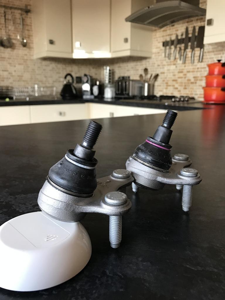

Picked up the Passat ball joints from VW today and just to confirm, the taper pin is 5mm longer than the GTI ball joint.  GTI on the left, Passat on the right.
This will put the wishbone back to the correct angle on moderately lowered GTIs  :happy2:

« Reply #10 on: March 31, 2017, 08:37:14 pm »
great kitchen!!
