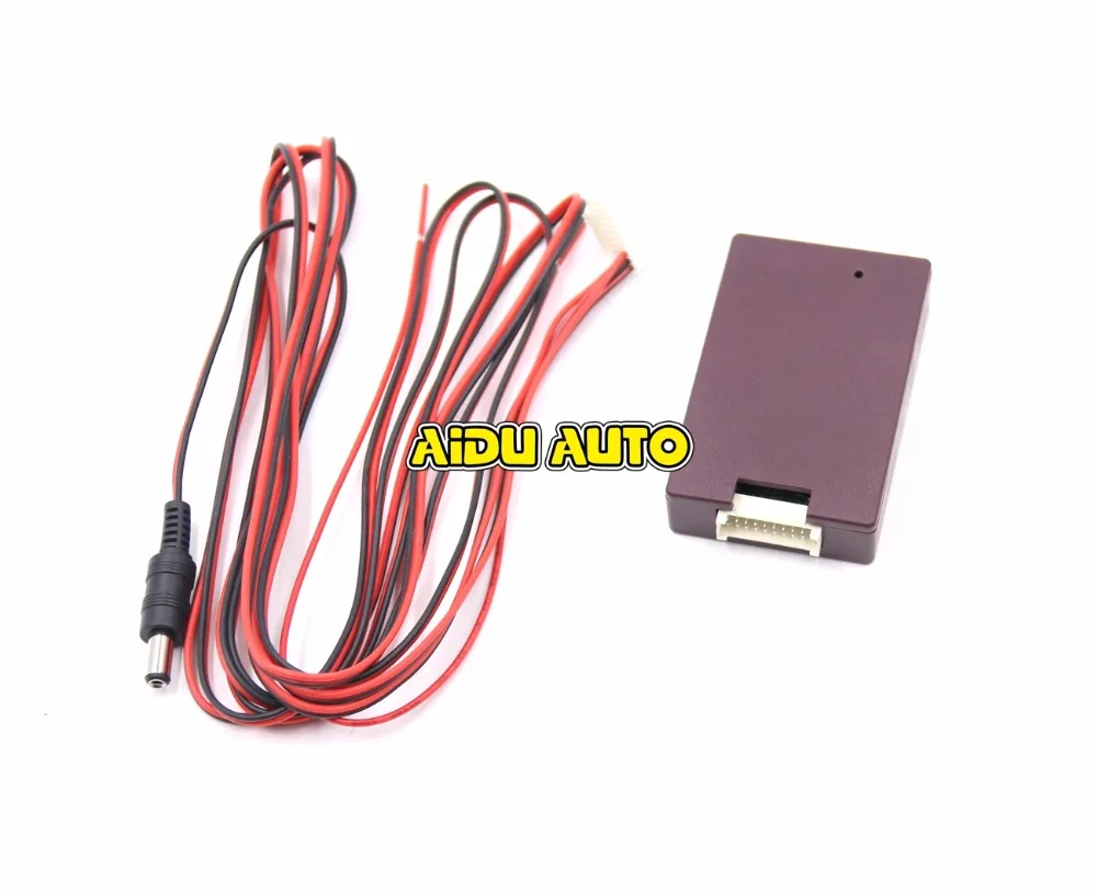

The stereo came with its own cambus decoder box that is connected to the stereo which is to save power I believe - of the battery.

I have fitted a camera to a RCD330.
I fit a delay power box. This basically has a switched live into it (from my rear cigarette socket) and then the reverse tigger (a blue and black cable under the left boot carpet) and then that powers the camera.
I think it just takes the reverse tigger and then power comes from the switched live while the tigger is activated and also for about 3 seconds after.
I was advised I need this in the MK5.
This may not be the same issue, but worth considering.

This is interesting! Yes you are right. The reason being is that the MK5 GTI has a european Canbus which is very stubborn. Can you please tell me whether your solution triggers into reverse mode (camera shot) when you trigger the gear into reverse? Bearing in mind mine is a AUTO DSG transmission.

Offline c.grex
  • Posts: 42
I think the timer delay I have fitted is essentially a relay with the added benefit of keeping power live to it for a few seconds after the reverse signal is lost (i.e. You put it back into Drive or 1st gear)
My car is a manual and black/blue cable is the tigger when the car goes into reverse. I think this black/blue cable turns white when it goes up behind the air bag / corner pillar and then to the reverse light.
