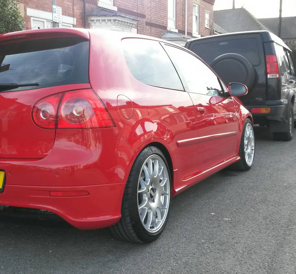

« Reply #5 on: April 18, 2017, 03:55:04 pm »
12mm front, 15mm back. Sits perfect imo. Sorry no pics
I'd go with that.
I'm on BBZ VZ which poke about 13mm more than a 7.5J et51 wheel.
Front looks perfect, and to the eye I could probably get away with a 3-5mm spacer on the rear if I wanted.
That's on 30mm H&R springs by the way. Coilies are going on tomorrow and I'm confident I won't have any issues going 15-20mm lower. Although I have just done the arch screw mod.
This should give you a rough idea...

That looks good, what is the off set and width of the bbs and what size tyres are you running ? as looking to move to 18's at a later date.
8J et44. Equivalent to a 7.5J et51 18" Monza with a 12-13mm spacer.
Tyres are 225 40 18 Michelin PSS all round in that pic. I'm now on Michelin PS4 on the front, and they're equally brilliant in British road conditions.
