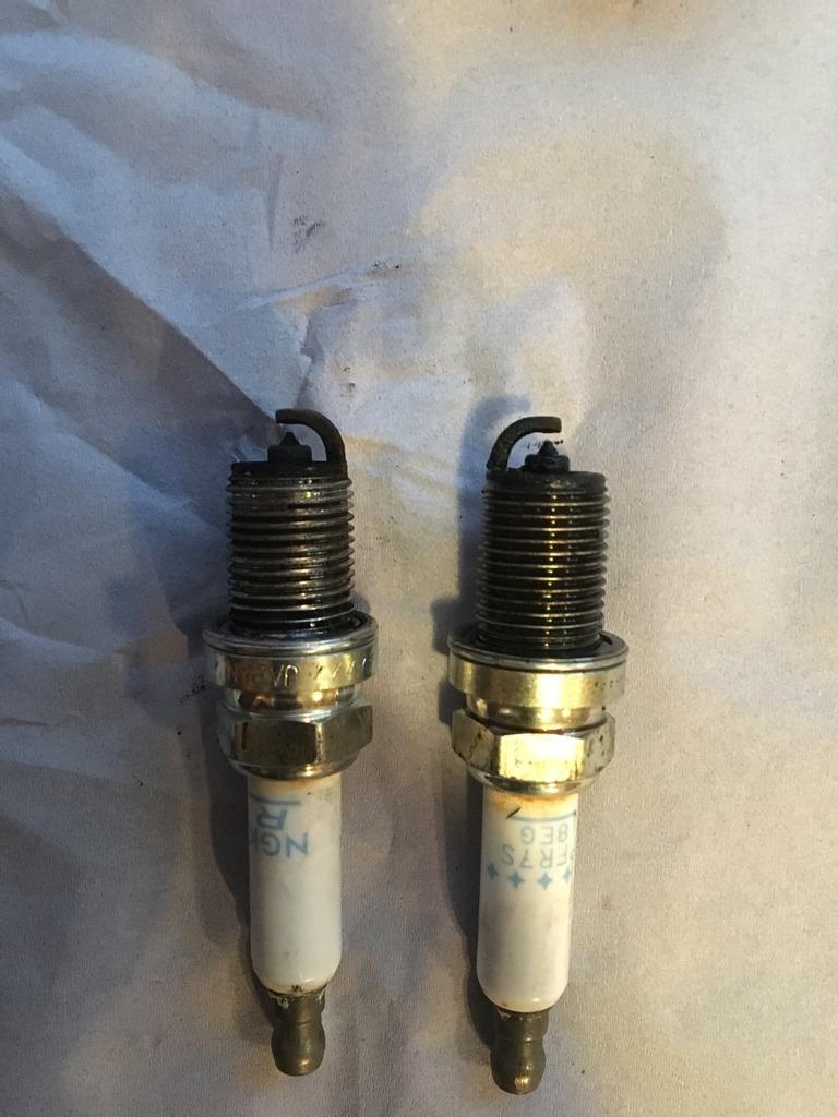

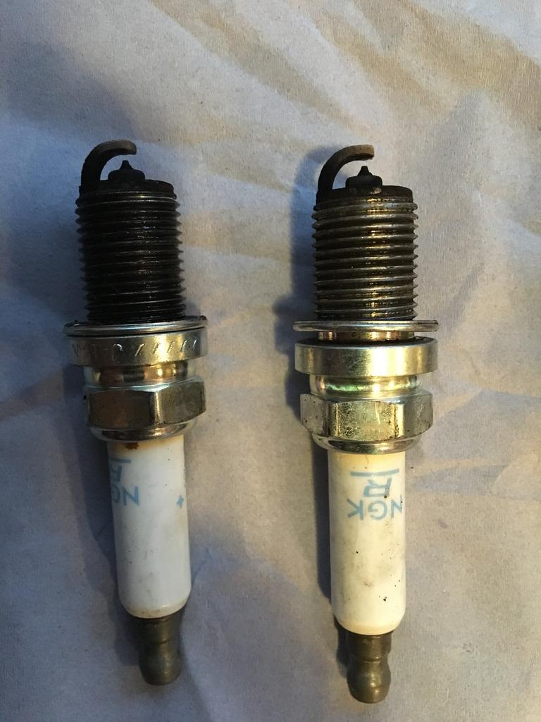

« Reply #11 on: April 25, 2017, 08:34:30 pm »
Hi,
Please find pics to show what I meant by "Burnt out".
First 2 from the Drivers side of the engine - the tips are "cleaner".
Second 2 from the passenger side show the 4th one with a burnt out tip
Let me know if you guys think there's anything untoward aside from one of the spark plugs being effectively "dead".
Just to add these are ~18k miles old and were put in about 600 miles before I went to R-Tech for a stage 1 when I had completed a full service with cam belt & cam chain etc.

Re: Where to buy the NGK-BKR7EIX spark plugs today?
« Reply #12 on: April 26, 2017, 09:48:51 am »
Are they OEM plugs or aftermarket?
Number 4 is oil fouled, which is explains why it eventually gave up sparking.   I think that cylinder needs a compression test / inspection because it's burning quite a bit of oil.   Hope it's not a broken piston ring land.  Seems to be very common on the TFSI group these days, especially on Stage 2 and above cars.

« Reply #13 on: April 26, 2017, 10:31:18 am »
The current plugs are OEM or equivelant -
 http://www.eurocarparts.com/ecp/c/Volkswagen_Golf_2.0_2005/p/car-parts/regular-service/car-service-parts/spark-plugs/?408441120&1&2a6c66423494a27daa7f10ccbb786e12bfddf13c&000301
This is what the garage (Audi/VW specialist) fitted when doing my service just over a year ago.
Would I have any other symptoms for a broken piston ring? It drives absolutely spot on and has been absolutely perfect aside from the day the spark plug gave up.
« Reply #14 on: April 26, 2017, 10:58:41 am »
Might not be a cracked ring land then if it's driving OK, but worth compression checking cyl 4 and comparing to the other 3.  That cylinder is definitely burning more oil than the other 3 though.
