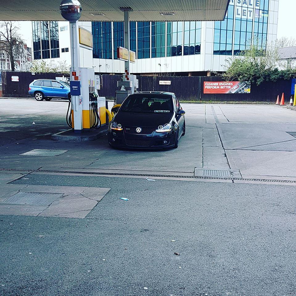

.... can't help, but if you're strapped for money, I'd save £100 fine by putting number plate one.
Have heard of three having fines this month for that.
Seems they are having a purge!
