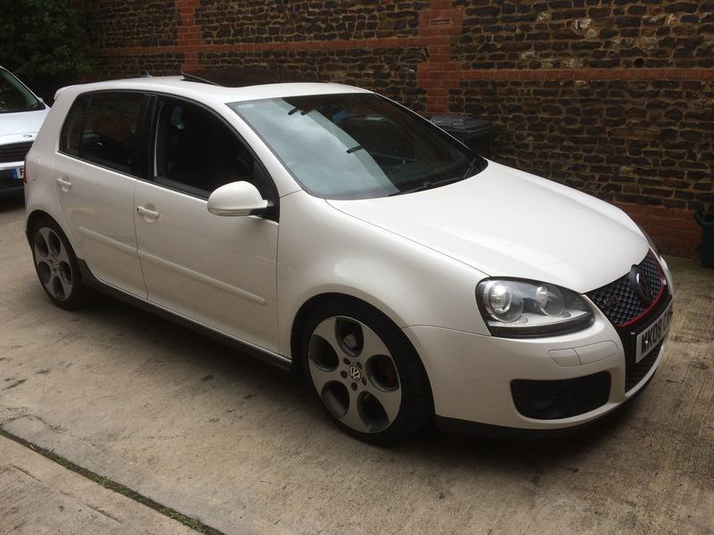

And a few of my new GTI.
I've owned it for a couple of weeks now and really enjoying being a bit more of an enthusiast again and doing some mods on it.
