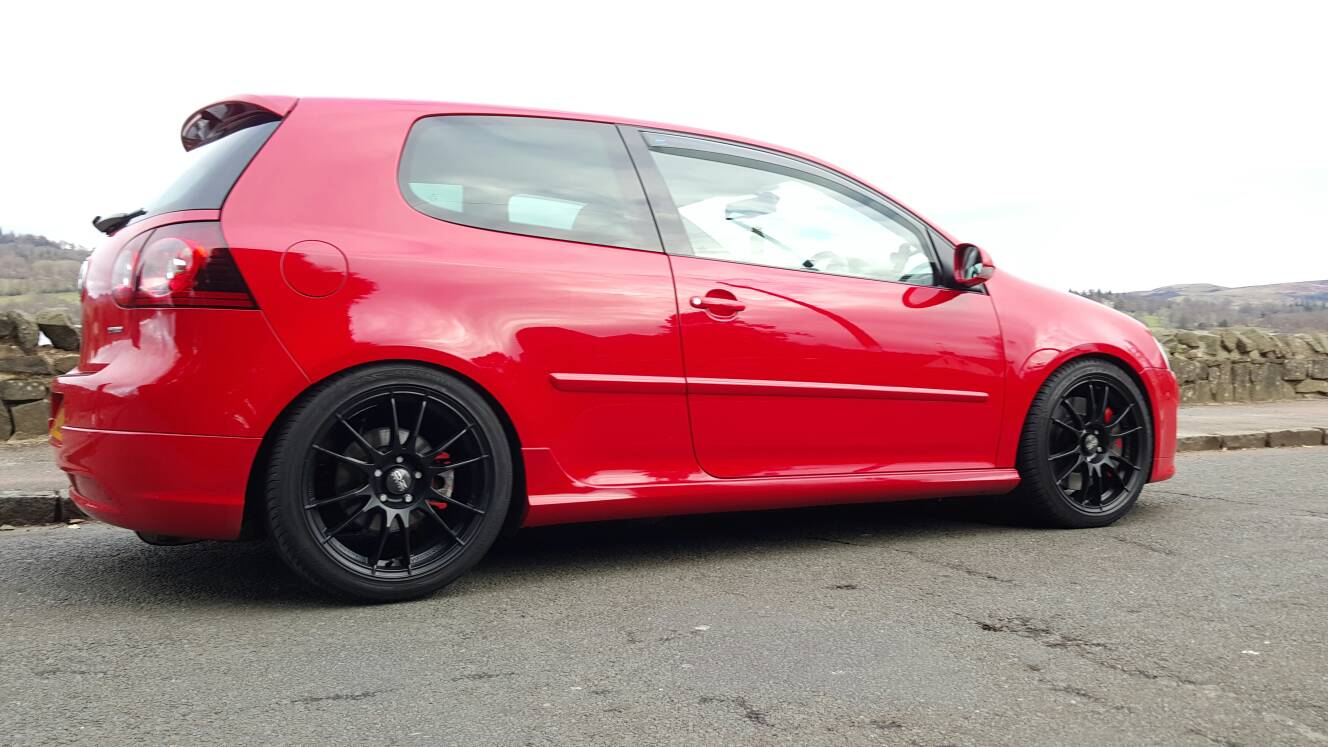

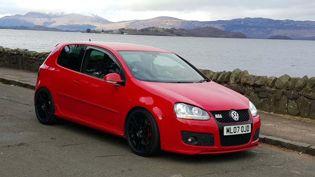

Morning all,
I thought I'd create a new build thread so i could keep everything separate from my previous Gti one (http://www.mk5golfgti.co.uk/forum/index.php/topic,78921.0.html)
On the 17th Dec, I took the trip up to Scotland to see howie1987 and his red Ed30. After a few hours chatting and been shown round the car, and how it drives etc, we agreed on a price I set off back to Sheffield.
Most of you probably recognise this car as it has been owned by quite a few members: howie1987, ed30sam123, cuprajake, N8KOW, kevinm. This being one of the reason I went to look at the car.
Car Spec:
Mk5 Ed30 DSG
Tornado red
Factory fitted xenons
Privacy glass
Lux pack
Cruise control
Highline dash
RNS 510
729B Bluetooth
MK6 Rear badge reversing camera
Modifications:
Polar FIS
Carbon wing mirror caps
Full Miltek nos-res exhaust
S3 Front brake setup
Autotech HPFP
OZ Ultraleggera
H&R Springs
Rtech Stage2+
Theres probably a load more that could be added so please excuse if anything is missing.
Disclaimer: Some pictures stolen from howie1987!

Love the ultraleggeras
Offline Joshy
  • Posts: 295
Re: Joshy's Ed30 Build Thread
« Reply #4 on: January 17, 2018, 06:58:46 pm »
Thanks MIJ :happy2:
They are beautiful wheels. Very happy that the previous owner put these on.
