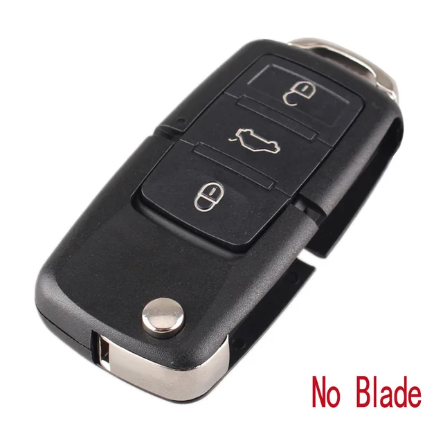

Thought I'd share this....
I recently picked up a new replacement case for my key from aliexpress for £1.68, it's come down in price since then:
https://www.aliexpress.com/item/KEYYOU-Folding-Car-Remote-Flip-Key-Shell-Case-Fob-For-Volkswagen-Vw-Jetta-Golf-Passat-Beetle/32822183218.html
It was delivered under 2 weeks and the quality is surprisingly good, I'll have a go at swapping the internals this weekend and will let you know how I get on.

Have you researched into the transponder inside the key? Be carful when doing the swap  :happy2:
N14hta
Re: New Key fob shell for less than a pound
« Reply #2 on: February 03, 2018, 12:30:16 pm »
Good deal, the immoboliser chip inside isnt too hard to get out. I soaked mine in acetone for around 30 minutes and the glue was loose enough to pry it out although I wouldnt recommend using a knife to cut around without soaking just incase you damage the chip

« Reply #4 on: February 04, 2018, 06:44:47 pm »
So got round to fitting it.
One of the locating pins for the circuit board was ever so slightly out so I just snipped it off, doesn't seem to be an issue. The cavity for the chip is open so if you split the key there's a chance it can fall out, I guess this was done make assembley simpler. I blocked it up with a hot glue gun, not wanting to take any chances of it falling out.
Took 10mins, key sticks out ever so slightly when in closed position but overall 8/10 I'd say. I'll have to order up a vw emblem at some point.
