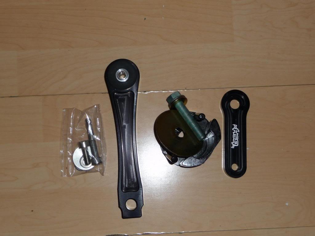

Some goodies arrived today:
4x4-O2 RS REVO stg 3 - 370HP-K04 turbo-Haldex controller-Autotech HPFP-S3 injectors-NGK sparks-RS4 FPR Valve-EVOMS CAI-S3 FMIC+Forge Twintercooler & Actuator-USP fluidampr-custom 3" Magnaflow exhaust-KW coilover kit V1-S3 brakes front/rear + TAROX F2000 discs-LOBA-Sachs stg 2-VF Mounts-BSH PCV revamp-Forge short shifter-W.A.L.K.-H&R AntiRollBar kit + BSH end links -Team Dynamics ProRace 1.21 8x8J Anthracite/White
