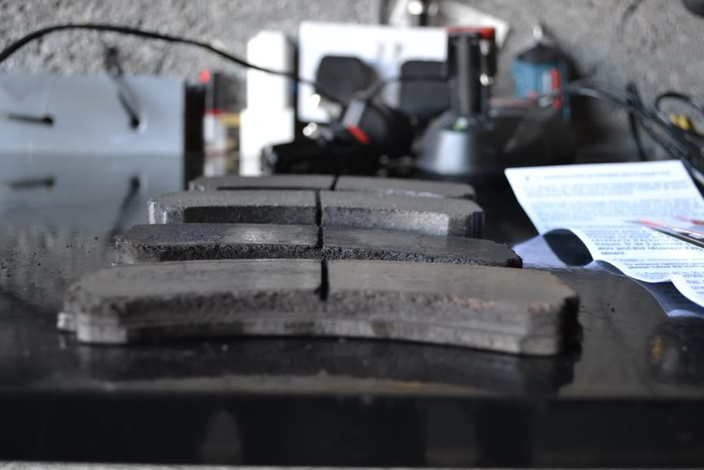

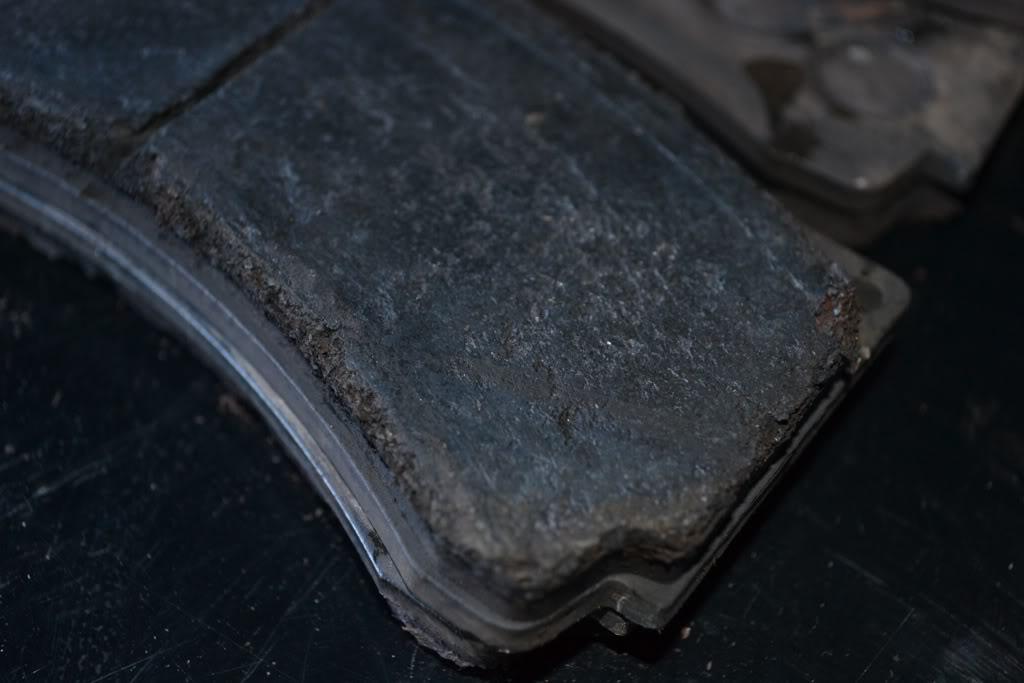

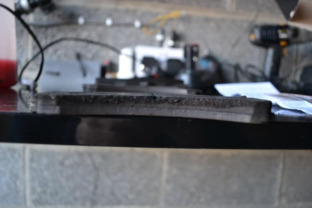

Like I said it all depends how you drive the car to how quick the pads go down. How many miles has the apr car got on it with those brakes on? And that will be all road driving and it will be ragged everywhere so may give you some clue
I can't see how driving style will make any difference to the wear pattern, to me it would only affect the wear rate.

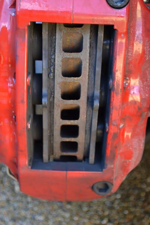

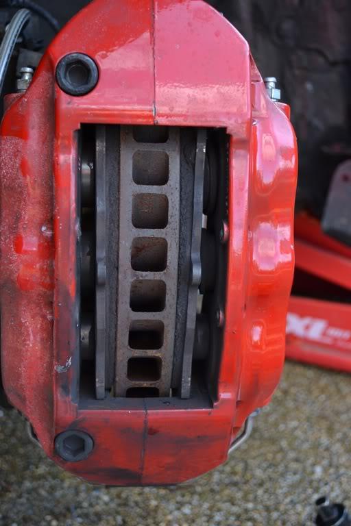

Here's the state of mine: -
Near Side Caliper
Offside Caliper
Also worth noting these pads where flipped around about 700 miles ago to help balance out the wear but still there is a significant difference. Also the offside pads where crumbling too  :surprised: :surprised:

I suppose if the car does way more track work vs normal road driving then I can see the big piston wearing out the pad faster than the side with the smaller piston.
But if the big piston is deployed first then IMO that's the problem really. Surely that means the braking isn't progressive at all?
I can't see how driving style will make any difference to the wear pattern, to me it would only affect the wear rate.Also worth noting these pads where flipped around about 700 miles ago to help balance out the wear but still there is a significant difference. Also the offside pads where crumbling too  :surprised: :surprised:
Which pads steve.  Were they new, how many miles/tracksays etc
Have you raised this with vwr

DS2500's, not sure exactly how many miles / track days as these are NeilM's old pads as previously mentioned. As QD will confirm mine where far worse when they failed at Spa.
Going to follow it up this week as when I mentioned it to VWR last year they claimed to have never heard of the issue.

For the amount of miles, the pads were shocking.  Down to the metal on one end, with circa 3-5mm on the other.  NeilM's were the same, but the pads were slightly newer, but had signs that they were on the same wear regime.

Maybe are better compound pad for track abuse as it looks like the heat has just melted them and they have crumbled but it also looks like your pistons have not been deployed correctly or retracting correctly  :confused:
