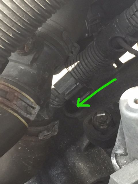

Checking the engine this morning I noticed that the is a hole, looks like a cap missing and you can see something rotating I presume it might be a clutch inspection cap. Should there be a cap over this hole?? If yes, does anyone know the part number so I can replace it if its missing.

Mine was also missing. You can see the flywheel. I got a replacement bung for mine for a couple of quid

Where did you get your replacement from, Im unsure of the exact part etc. Do you have a link? Thanks!!

PLUG - 02M 301 115 B
They sell em.on ebay
