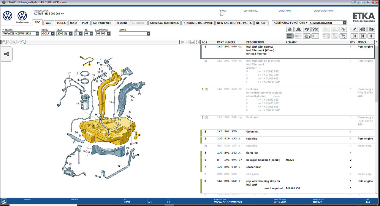

Does anyone have the part no for the fuel filter mount itself? Mine broke last time I changed it and want to replace it at my next service.
Offline doylebros
  • -Given: 44
  • -Receive: 310
  • Posts: 2776
Re: FUEL FILTER MOUNT HELP
« Reply #4 on: March 11, 2019, 07:28:05 pm »
This should help item 28
http://www.oemepc.com/vw/part_single/catalog/vw/markt/RDW/modell/GOLF/year/2007/drive_standart/474/hg_ug/201/subcategory/201005/part_id/3687086/lang/e

Hi, just trying to change fuel filter and the screw for the mount is rusted. Might need to break mount off. Anyone know how to get another mount? Thanks in advance.
Offline pudding
  • -Receive: 692
  • Posts: 8358
« Reply #7 on: September 14, 2022, 06:28:43 pm »
The filter mount is part of the tank.
Offline Ozy
  • Posts: 5
« Reply #8 on: September 15, 2022, 09:20:19 am »
Have been trying to locate the mount and dealer is unable to find it in the catalogue. Any one had any luck on part number etc?
Offline pudding
  • -Receive: 692
  • Posts: 8358
« Reply #9 on: September 15, 2022, 10:13:36 am »
Once again, it's PART OF THE TANK!
Offline Ozy
  • Posts: 5
« Reply #10 on: September 15, 2022, 03:06:04 pm »
Ah misunderstood you. That’s fine thanks
Offline Clarky
  • Posts: 123
« Reply #11 on: September 15, 2022, 04:32:54 pm »
Part number 1K0 201 060 GL isn’t it @Pudding ?  :thinking:  :signLOL:
Offline pudding
  • -Receive: 692
  • Posts: 8358
« Reply #12 on: September 15, 2022, 08:58:54 pm »
Is that not the pn for the whole tank?
I had a look at mine when I last changed the filter and the clamp is moulded into the tank. All you can do is cut through the lower strap and cable tie it. It’s a really sh1tty design  :doh:
